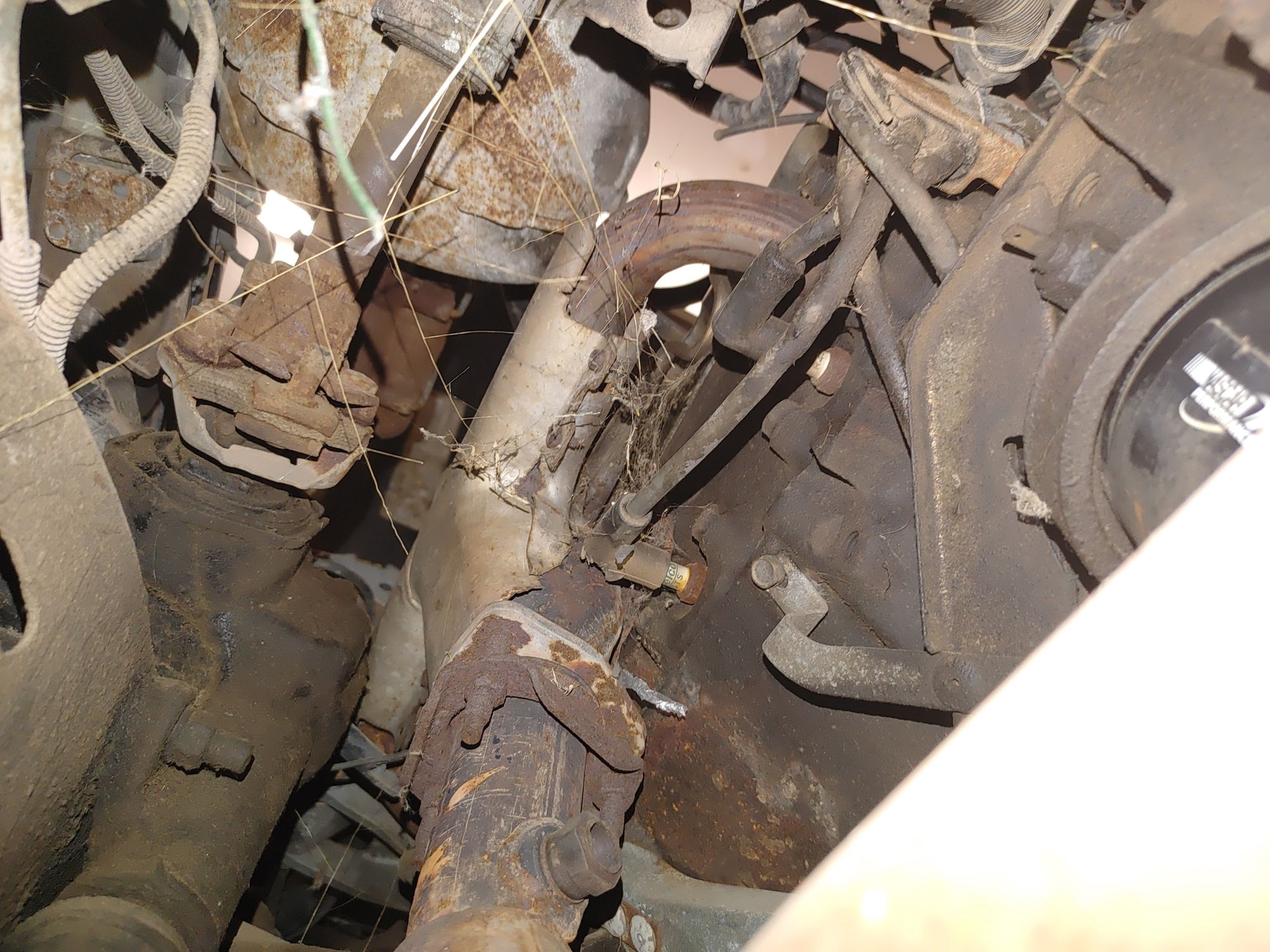

Looks like still has the old exhaust .. O2 sensor has fallen out and hanging by its wires under car ... Anyone tell me what that little electrical connection is above the oil filter ?

Old Nov 21, 2022 | 09:29 PM
MattoonVette's Avatar
MattoonVette
Living the Vette life....
Joined: Mar 2018
Posts: 555
Likes: 221
That is the sender for the oil temp gauge. You should have an oil pressure gauge and an oil temp gauge if you had the factory ETR radio. If you had the analog radio, you would have had a clock in place of the oil temp gauge.
