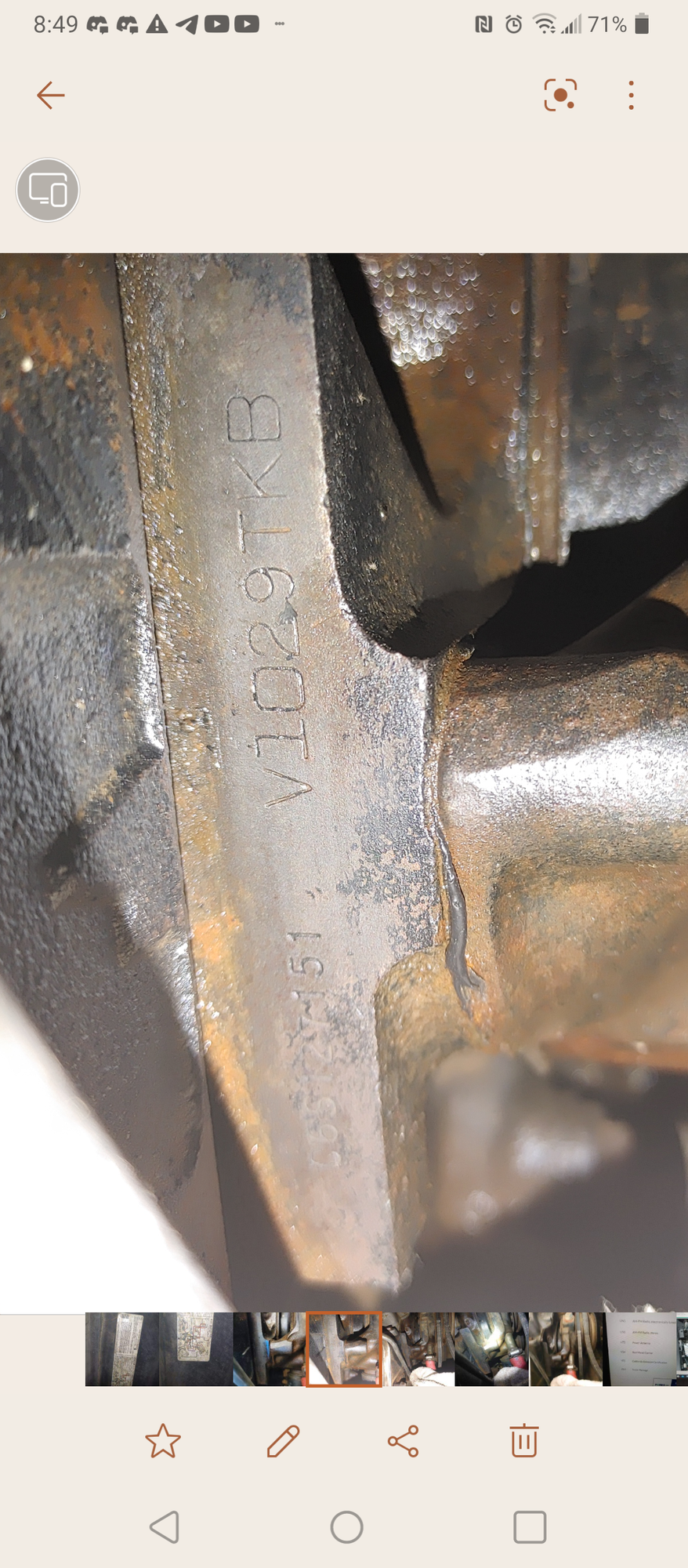

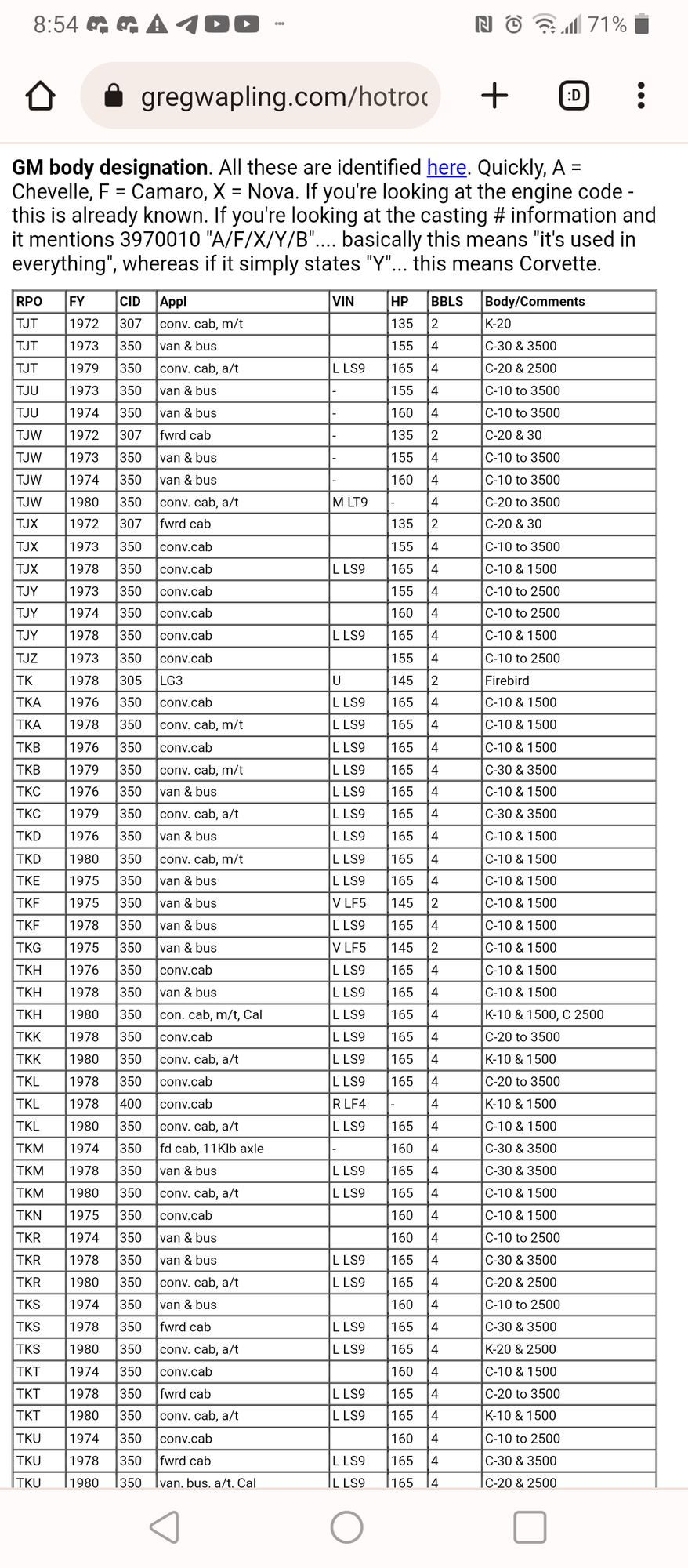

Well i decided to look at the engine serial .. And things took a strange turn ... Its coming back as a 76 c10 or 79 c30 if im reading correctly .. Id really like to meet the genius that put that one in if thats the case considering they went back with the original parts . im leaning crate engine or unload it .. Unless it wakes up with a hei distributor .. And says ive had some work done...

that would be the 76 engine. 77 or 78-up had a smaller, squarer stamp pad. 81 are not big collector items. originality is a non-issue. the car's condition is it's value. that 76 pick up engine is just fine, unless it is not. if it doesn't smoke or knock or blow steam, get a decent distributor on it and get it timed up to 36-38 at full advance. and you will be surprised cuz it is now a 290 ho engine. the 165 hp numbers are a result of overly conservative timing for emissions and creative accounting for NTSB. and the truck version may well have flat pistons, not dished. don't dump the car for a wrong number stamped on the block.

Thanks .. It was a fresh rebuild from what i was told when i bought it .. I guess on a positive note i wont feel bad for cleaning up the engine bay .. I did email lar for his timing information .. Still waiting on response .. But this helps
