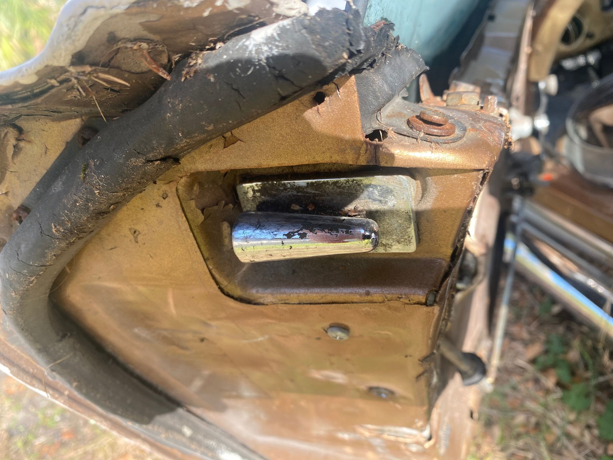

75 vert has these pins that go into sockets in the pillar to stiffen the body. i have seen some coupe doors with the cutout. some without. you can use coupe doors, but need to remove the socket the pin goes into or a door without the cutout will hit it.

plus they have different doors. you can interchange them, but that alignment pin for verts can not be installed in a coupe door. and the socket would have to be removed from b pillar for the coupe door to close if put in a vert..
