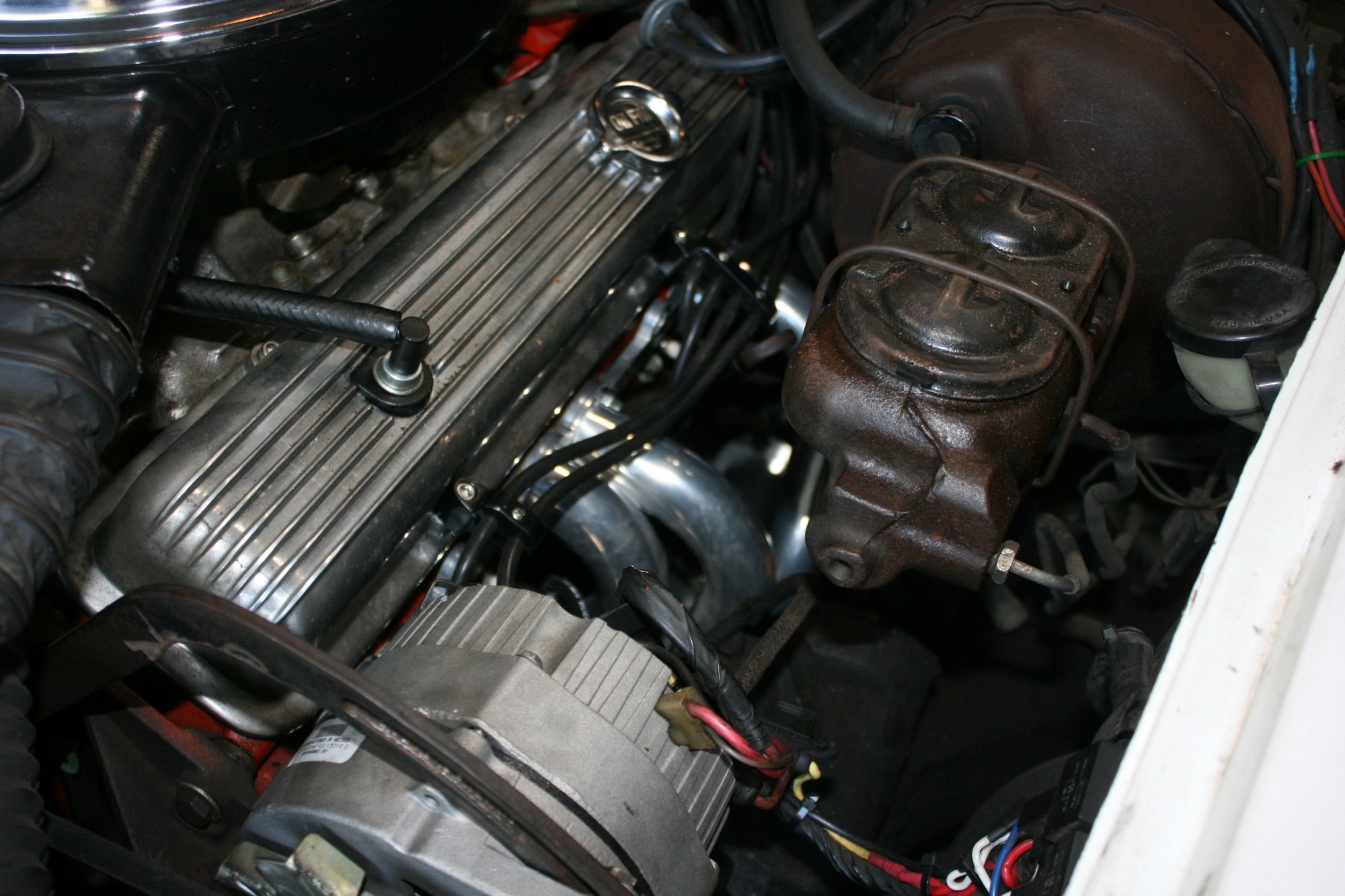

I’m putting a set of long tube Hedman Hedders (part# 68308) and a Pypes true dual 2 1/2” exhaust on my 1982 Corvette with the engine in the car. I am also deleting the cat and air injection pump with all the plumbing in the process. I need some advice from someone who has done this install. First off disassembling the stock exhaust was a real PIA! Getting all those heat shields off just about killed me. I have the drivers side installed, thinking it would be the harder, NOT! My questions are:
1. What did you do about plug wires? Looks like the forward-most and rear-most plug wires can be routed under like stock but the center two on both sides will need to be routed from above.
2. Dip stick tube - I cannot get the headers up over it and they won’t drop in from the top. What have others done to solve this problem?
3. Center exhaust pipe hangers. I can adapt the stock hanger that was in front of the cat, but what have others done about the one behind the cat where the new system has two pipes instead of the one large merged pipe.

As for the dipstick - the tube itself can be pulled out and then later pushed back in place.

I appreciate the help, but aren't we getting a little off subject? The plug wires were the least of my worries. I will pull off the starter and get the dip stick tub out. Has anyone installed the Pypes true duals on a 1980-1982 with long tube headers? Looking for installation photos and suggestions for the middle hanger.
You might need to change the crossmember. Unless both pipes go to the passenger side.
