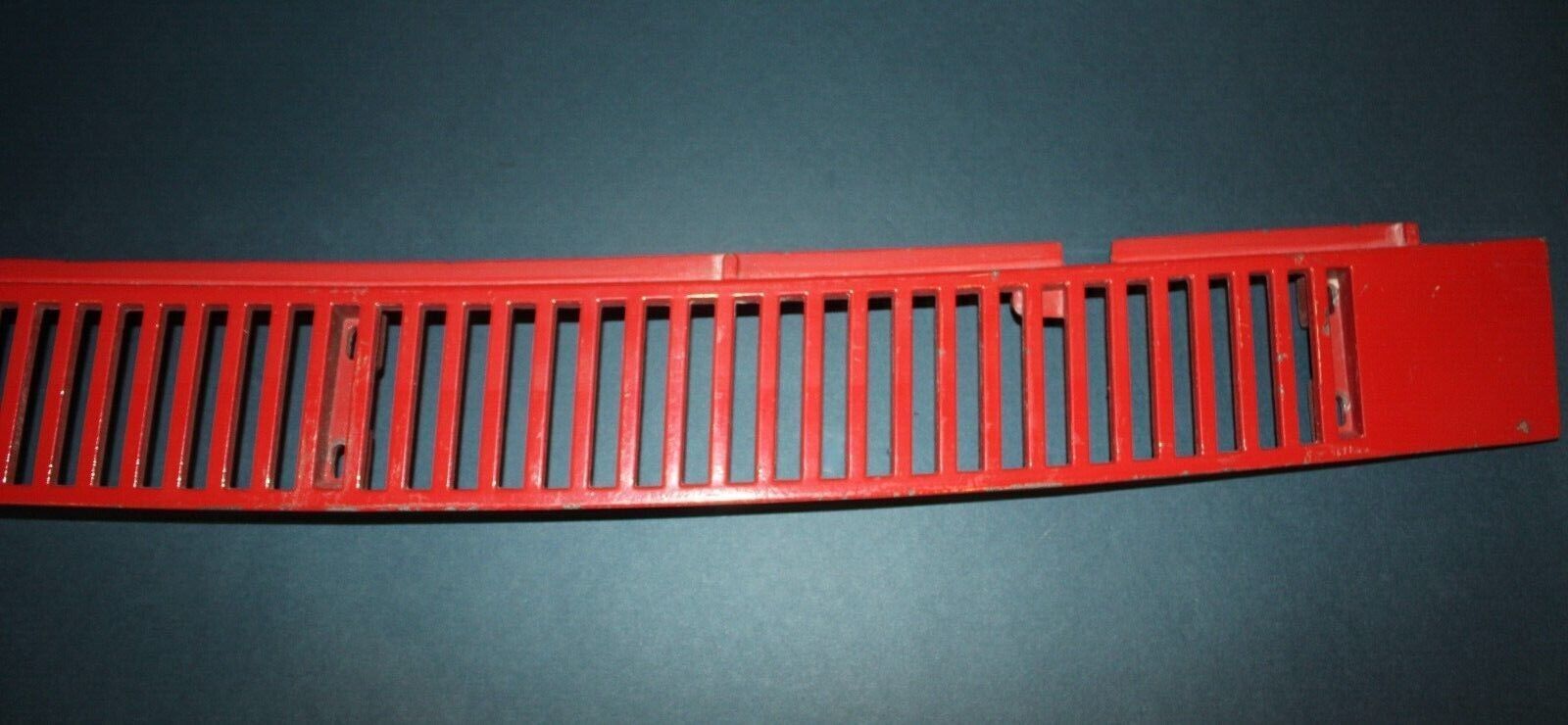

Can anyone give me the approximate time in production that the early wiper grill was transitioned away from to the later grill? Thanks, Terr

Vin 16191, April 1st build, has the first design. I know a early May built car, it also has the first design.

My June 5 or june 8 has the early design wiper grill with the cut outs

anyone have a pic of the early 68 grille they can post? i checked google and didnt find any pictures, im just curious, i like 68 and have a late one.

Hi Terry, Happy New Year! Can you tell me the differnce?

Just throwing this out there: If the two grilles carried different part numbers, the assembly manual may have a line change date and description on the grille installation page.

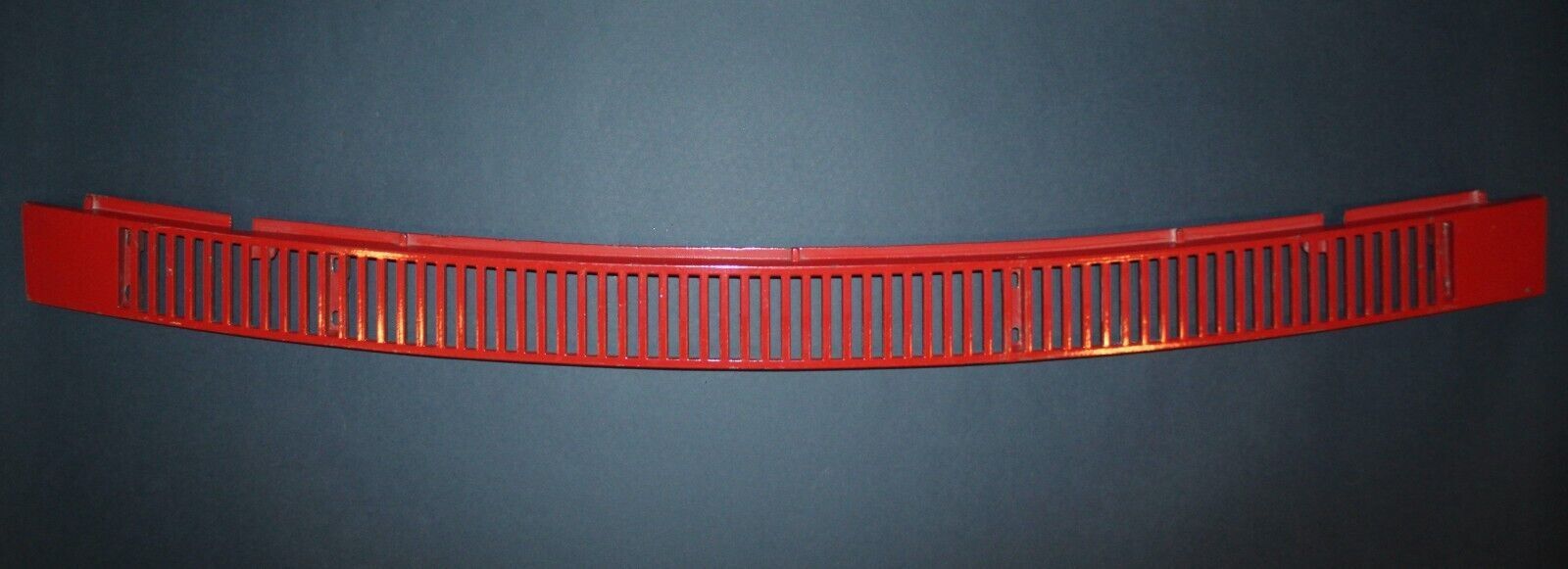

Basically at the location of the wiper squirters, there was a little cut-out that the squirter poked through to let washer fluid hit the windshield at a decent spot. Later cars removed the cut out and used a different squirter. There are three different pairs of squirters used in 68 that were adapted to the wiper grill. The early grills were fragile and prone to breaking at the notches. Unbroken originals are kinda hard to find. I believe the part number changed to a new number when the second design came out. I think there was actually a 3rd part number that might have come out for 69 and later cars. Its been a while since I dealt with this. Terr

I think my oct 67 has those cutouts

My October 67 built also has the cutouts.
