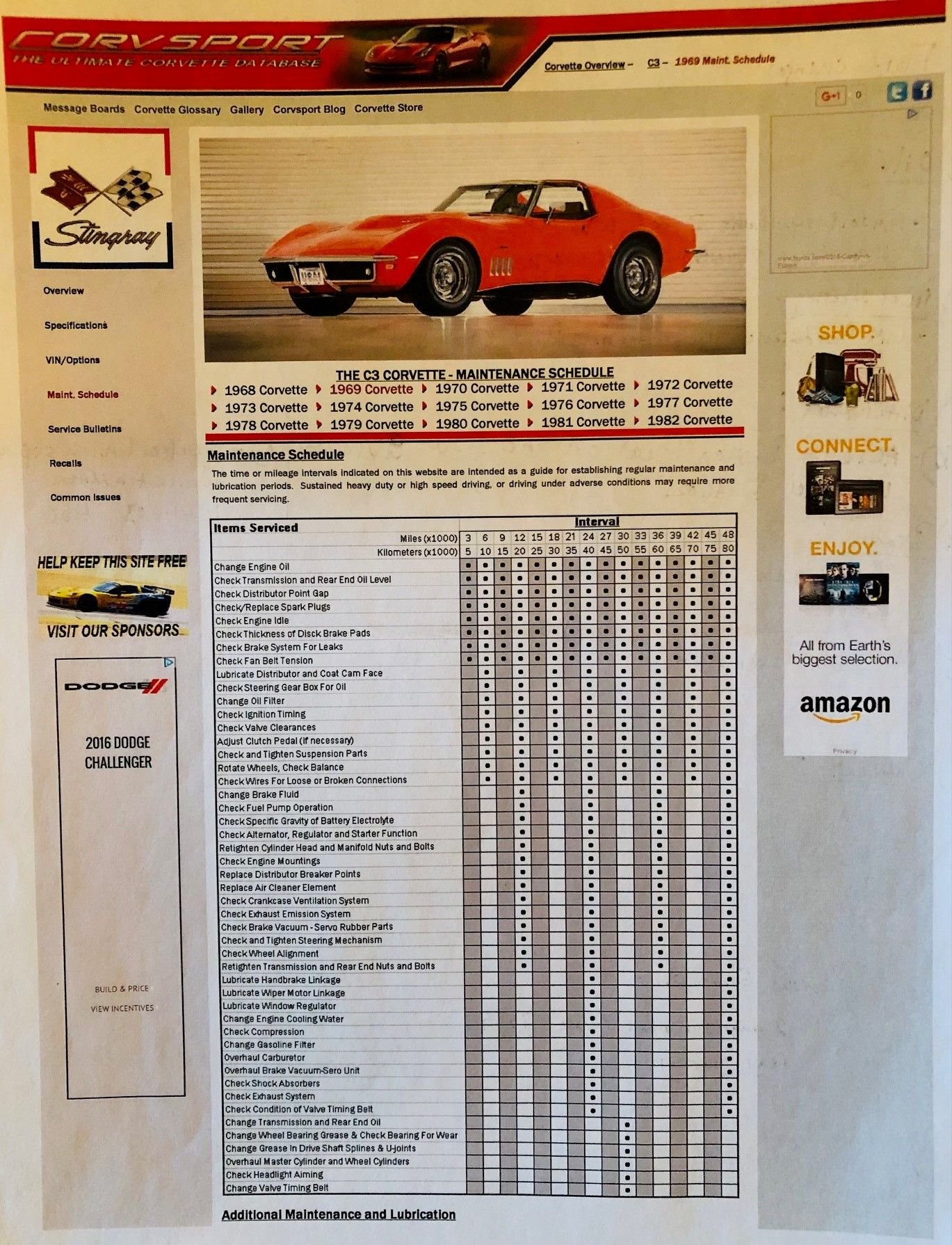

When I first got my 1969 L46 roadster back in 2018, i found this C3 service document online that I figured I'd follow. Fast forward to 2022 (almost 2023). I've done basics like oil changes, engine belt changes, spark plug replacements and brake fluid flush, and more intense like replacing the calipers, brake pads, brake lines and repaired the emergency brake. Beyond that, I've not done much more. The service intervals are based on miles, but I doubt any of us drive these types of miles with a C3 corvette. I wanted this forums input on your routine for winter maintenance, look forward to the responses.

service manual
remember improved oils/greases will change recommendations

It won't be in the service document that you have but STA-Bil added to the gas tank and then run for a few minutes to get the fuel stabilizer into the fuel lines, fuel pump, and carb is a quick, easy, inexpensive winterization item that I do each winter. I also use the STA-BIL on my lawn mower, weed eater, cyclone rack, and leaf blower for winterization too.
