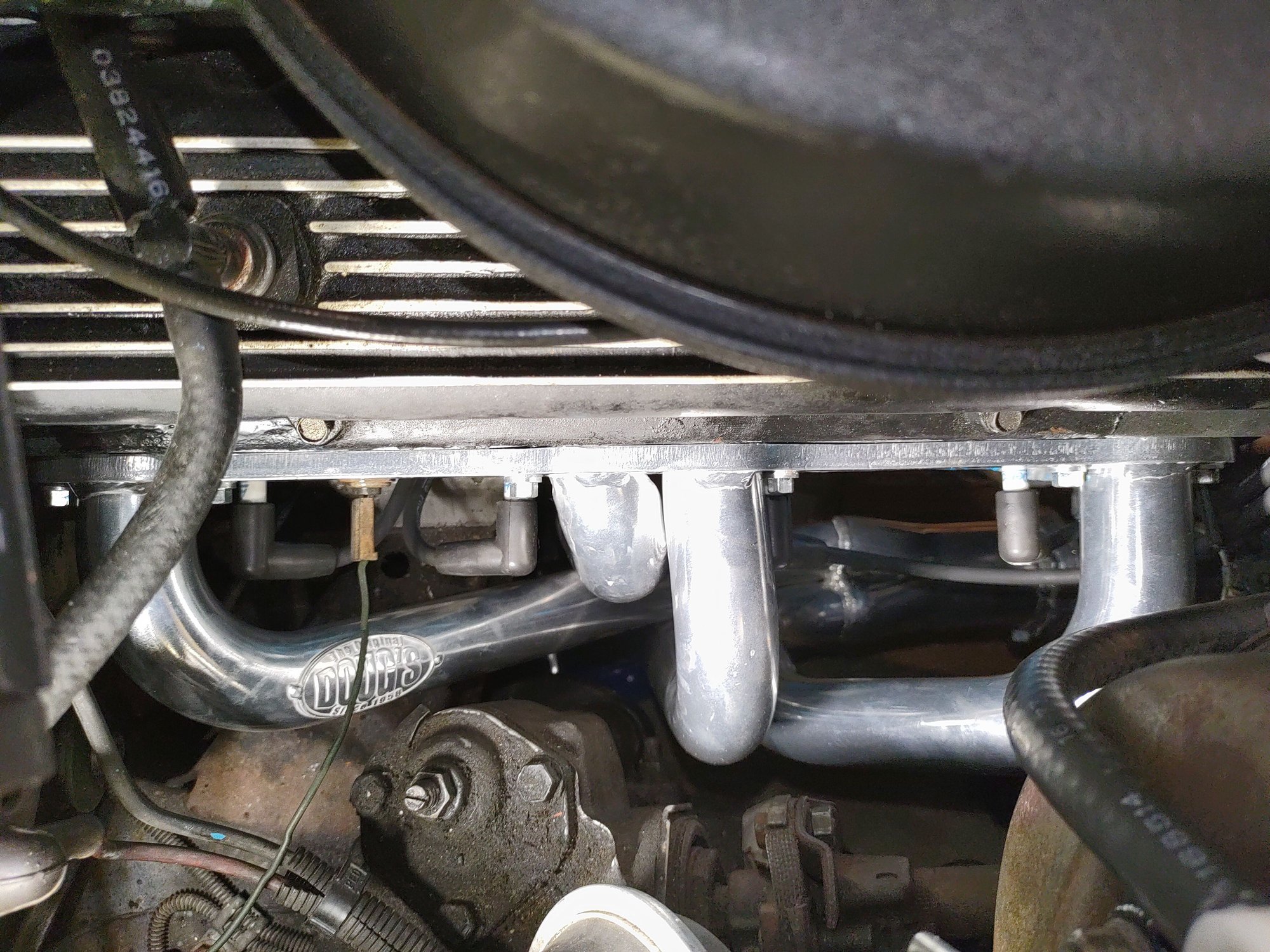

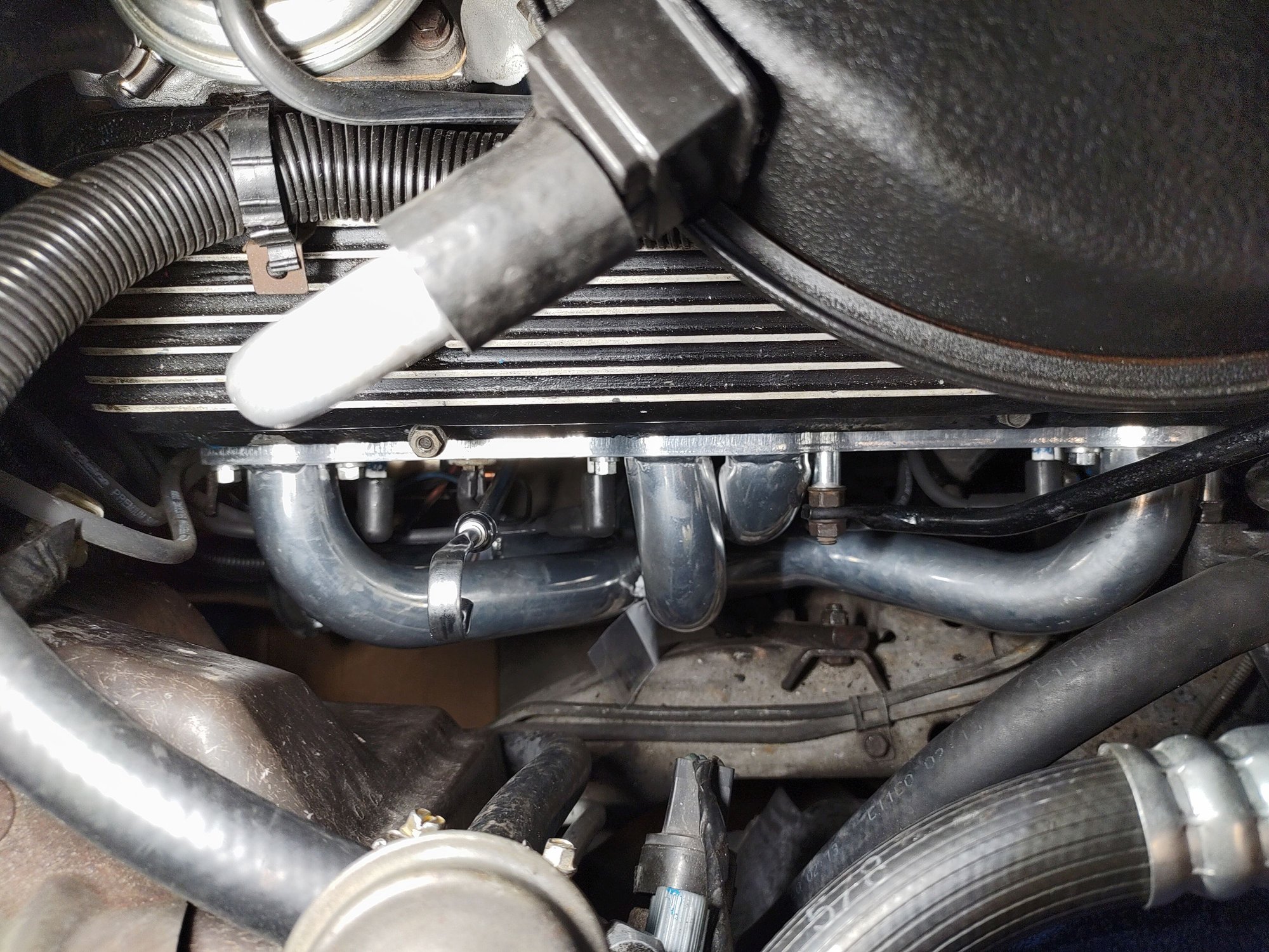

I just put long tubes on my 69 the other week. Definitely not as bad as many people describe imho. I put the front of the car on ramps, and brought the headers in from the bottom had my wife hold them while I came up to and threaded the bolts. Dip stick tube comes out along with clutch linkage and z-bar if manual. I also had to loosen and slide my power steering pump out of the way but I did motor mounts at the same time so that may have been why I can’t remember atm. I wrapped my starter in heat wrap. Need wire looms to bring plug wires down from the top and I bought a shallow spark plug socket for the number 1 cylinder since it’s really tight. Hmu if you have any questions.
