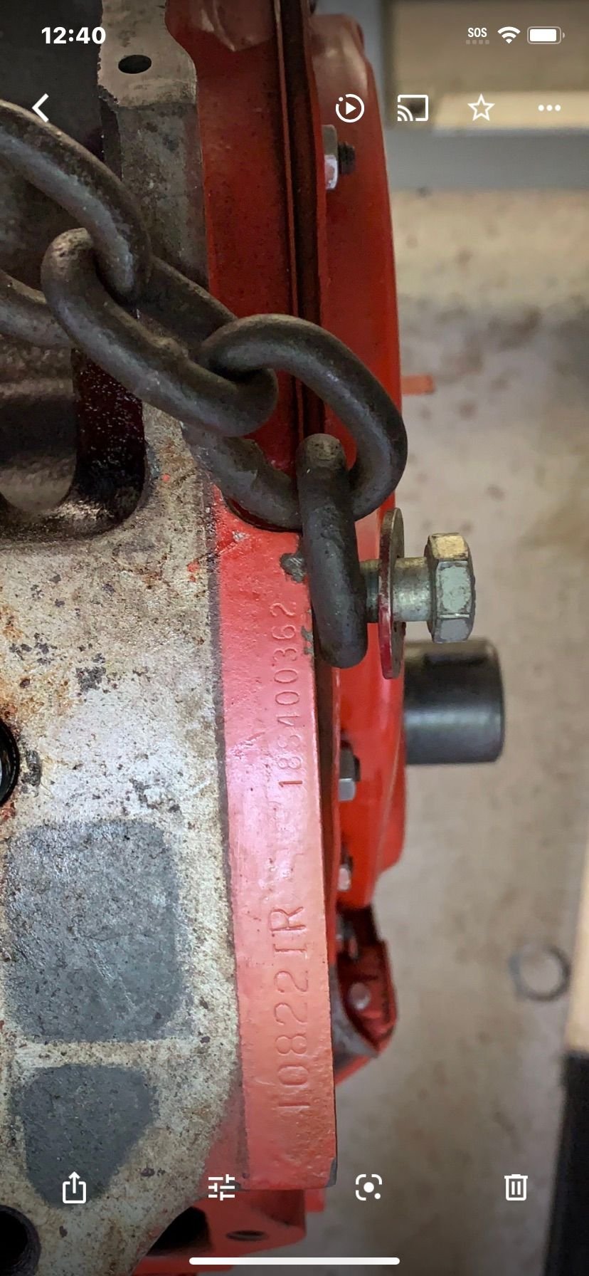

Are you sure about the "1" and "5" in the VIN? Are they possibly a "7" and "S"? A picture of the pad would be helpful.

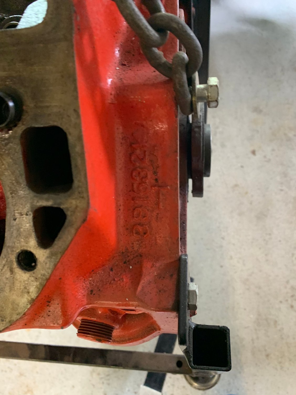

IR suffix shows original application for this block was early 1968 Corvette 435 hp, 4 speed, mechanical lifters, Holley 3X2 BBL carbs, 4 bolt mains. First 427 to use the new spin on oil filter.
Assembled at Tonawanda plant August 22nd.
Heads are also correct for this application.

Casting date of Aug 67 lines up with early 68 as well. I am still curiuos about the 1 and 5 in the VIN.

The casting for the block would be good for very early '68 model* but the heads were cast in January of '68 (Axx8), so not originally on this block given the time span involved and the very early #362 VIN (if confirmed to be misread).
*The two-digit 67 for the block casting year would be unusual as it should just be a 7.
This is not to say that the OP's engine is not something desirable, just that I don't believe it's an example of an original assemblage.

Also it’s 18S4. Sorry

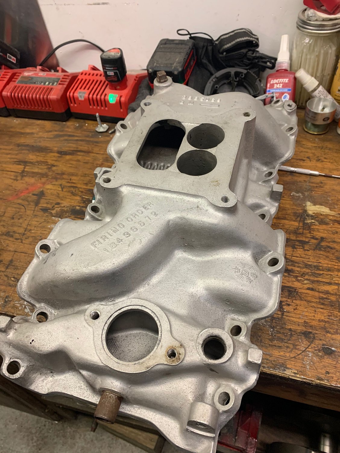

What is the cast number on the intake? It's a little too far forward to read.
It looks like it might be either a 3885069 which was used on both the early 1967 & '68 Corvette 427, 430 hp cars. This intake was also used on the Camaro, Chevelle, Chevy II as well as passenger car applications for 396 and 427 equipped cars.
Or it could be a 3886093 which was used on the later '67 Corvette 427, 430 hp.
Cheer, Greg

3885069
the intake looks like it was hardly used
