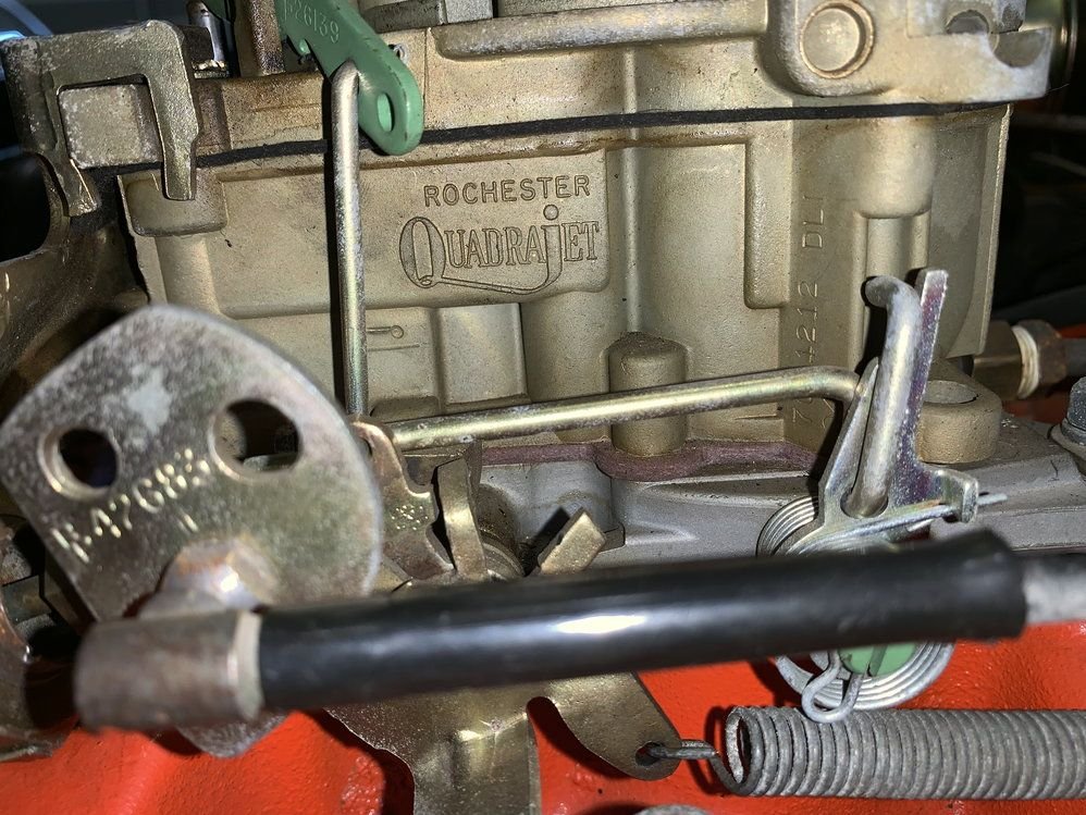

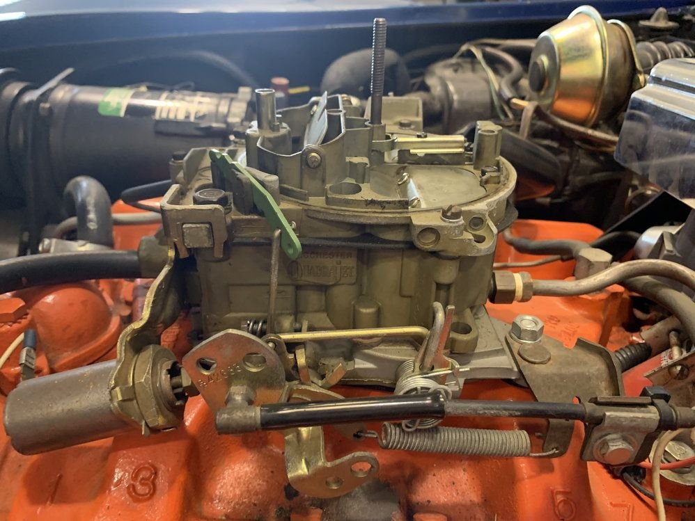

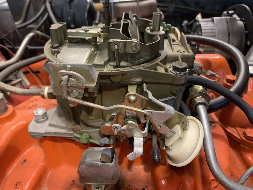

Have the original stock Quadrajet on my 71 350/270hp turbo 400. I think it needs a rebuild. Idles high, 12 to 1500 rpm’s. Choke doesn’t kick down when engine warms up and the secondaries don’t open all the way at WOT…
Today when I get in the Vette my gas pedal seemed to be getting stuck on something. It wouldn’t go down all the way when pumping the gas. I though the cable was catching somewhere but when I took the air filter off I discovered the linkage barely moved even moving it by hand… It’s happened to me a couple times but I was always able to free it up by stomping on the pedal a few times. Today it wouldn’t free up… After fiddling with the linkage on both sides for a while I gave it a final stomp on the gas pedal it suddenly freed up and moved easily. I hopped in and started it up to find the idle even higher. Drove to an event I really wanted to attend today at the race track anyway and aside from the high idle it drove great. Once at the event I shut it off and it sat for a while. When I went to start it again I got a huge backfire, sounded like an M80 if you know what that is, and it was smoking a lot from the exhaust pipes… Thought I blew up the motor. The motor still ran ok but was smoking a lot from overdose of gas. I tightened down the gas/air mixture screws and backed them off only one turn. That got things to normalize and I was able to drive it on the track where the event was happening, actually ran pretty good. On the last lap I noticed my breaks were getting soft. I thought ok now what… checked the master cylinder, levels were good. Then noticed the vacuum line from the booster to the back of the carburetor was lose… tightened that up and got the brakes back but I think the base plate may have a crack in it where that bolt goes in. So it was another exciting day 🤪.
My plan is change the carb to a Holly doble pump ( 600 or 650 maybe or what ever would be best for my Vette ) and rebuild and store the Quadrajet… Just seems like all my problems stem from carburetor. I wish Lars was in Spain.
If you made it this far, any thoughts on my long story are appreciated… Any suggestions on a new carburetor would also be welcome…
PS, as if this post wasn’t long enough already. I ordered some long tube headers and am thinking as long as going to change the carburetor I might as well change the manifold too. I don’t want to modify or change the hood though. So any suggestions of a manifold and carburetor combo to complement the headers are also welcome. I will keep and store all the original parts of course.
Sorry for this long post…

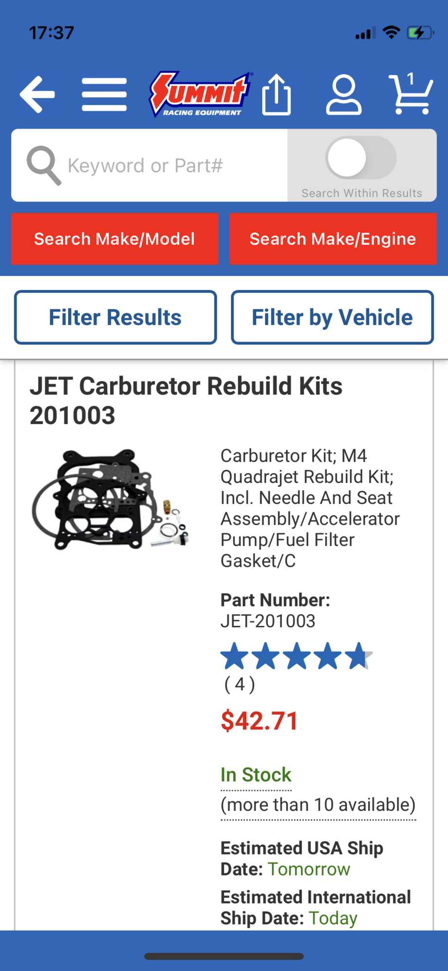

Would this be the correct kit to buy? This is from Summit:
JET Carburetor Rebuild Kits 201003
Old Jan 15, 2023 | 11:54 AM
MelWff's Avatar
MelWff
Posts: 18,740
Likes: 2,583
No. Contact this company
https://cliffshighperformance.com/pr...uild-carb-kits
