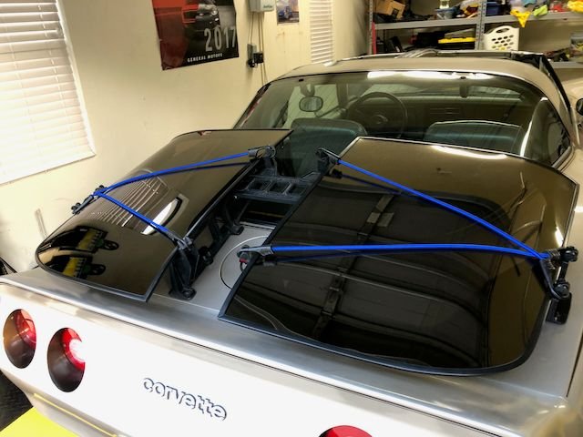

Here's a picture of my 82 with the V54 panel option. I don't have the straps to hold it down and was experimenting with the bungie cords. However, I haven't had the guts to drive it like this! The panels lock into place pretty good so probably be OK.
At least in 82, this was a factory option and that's how mine was built. I have the straps in the collector edition color hanging for the bag in the back but no bag. I had the car for a year before I figured out what those straps were for.

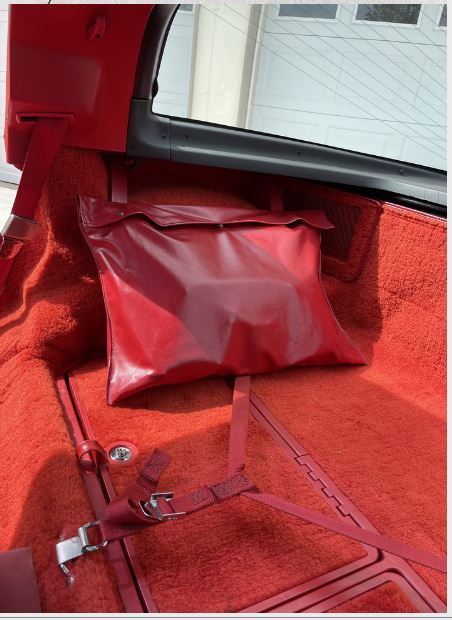

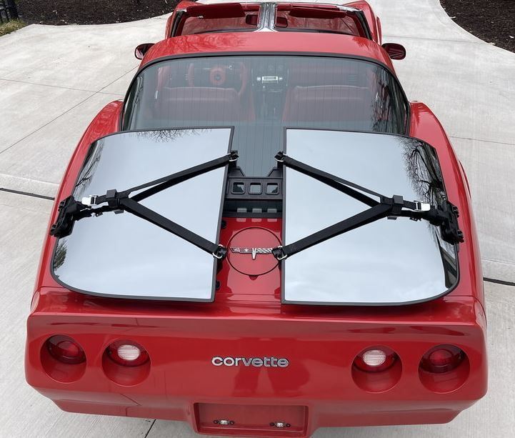

Well, if I review this previous thread https://www.corvetteforum.com/forums...imensions.html which contains the pictures below and study Mooser's post from AIM above, the OP should have had the interior colored storage bag, the two interior colored hangers., and 2 hooks mounted to the inside of the rear fender for his RPO V-54. AIM calls them "hangers", and are not to be confused with the two Y shaped "straps" used to secure the T-Tops to the carrier brackets outside the car.. According to the AIM sheet above, the hangers appear to attach to the rear fender.via 2 hooks. If the OP is missing the hangers and clips/hooks, then a PO removed them.. OP found the mounting hooks under the carpet
RPO V-54 Roof Panel Carrier
Thanks to JiminSTLouis for these great pics of his beautiful '80.
In addition, gbvette62 is spot on with his summary of RPO V-54 Roof Panel Carrier for model years 1980-82.

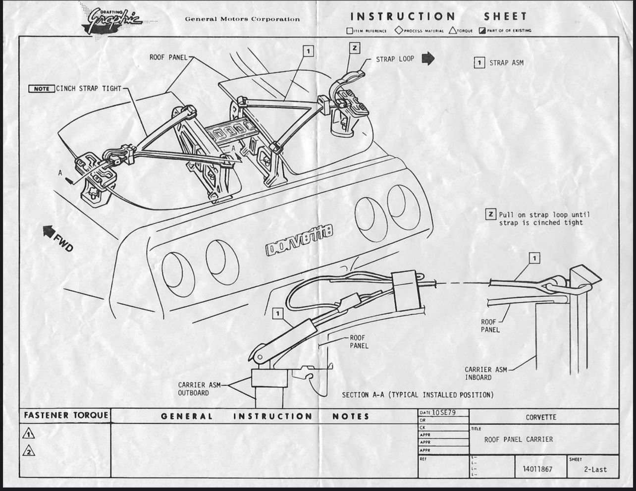

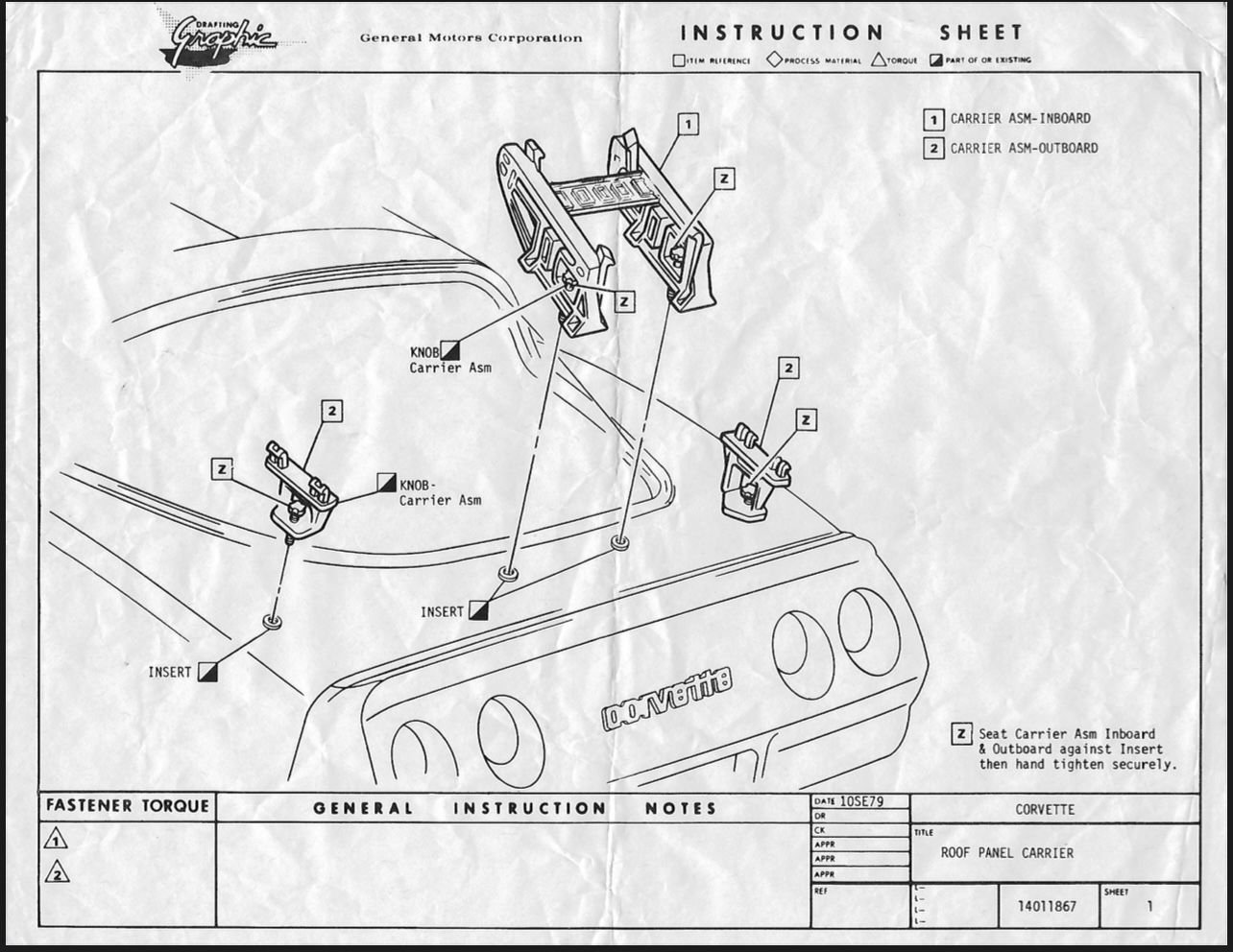

So I did find the mounting hooks inside the rear of the car, they were under the carpet for the V54 storage bag. I am now going to make the bag and straps for the top carry kit. My next question is does anyone have the instruction paper that came with it and if so is there anyway I could make a copy of it?

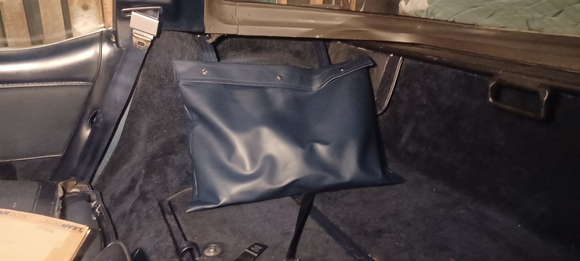

After get great information from other members I was able to make a storage bag for the V54 carrier kit. Getting the exact match for the vinyl was impossible but
V54 storage bag
close.

Nickster, here are scans of my original instruction sheets. If these images don’t work for you, PM your email address to me and I can send you PDF’s. Sorry but the documents I have are wrinkled.

That turned out GREAT!
