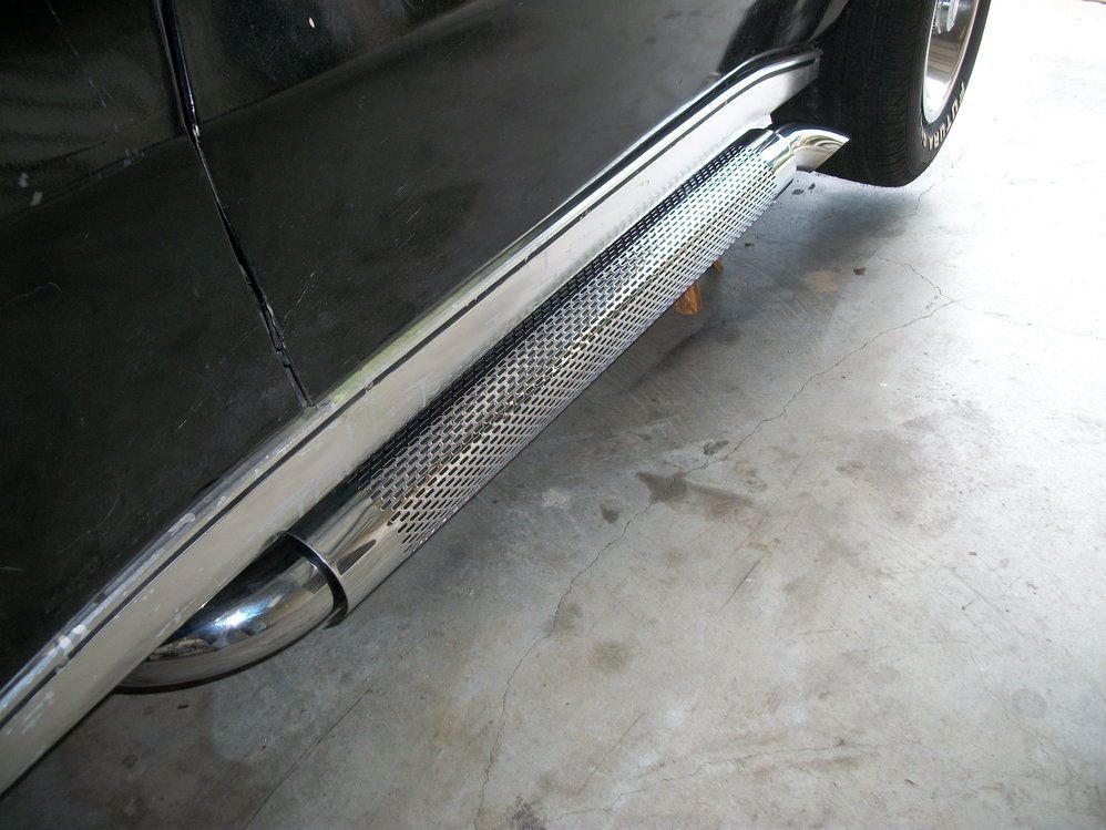

These are older Hooker sidepipes on my 80, likely the same part that @The Phantom linked. Those are the 36" Patriot side pipe shields. Kinda trashy in person, but they do save you from burns.

I use Patriot 60" on my '78. Have since tucked them up a little tighter since this picture was taken. Also wrapped the mufflers with heat wrap to help shield the heat. You can put your bare hands on the shields after driving.
