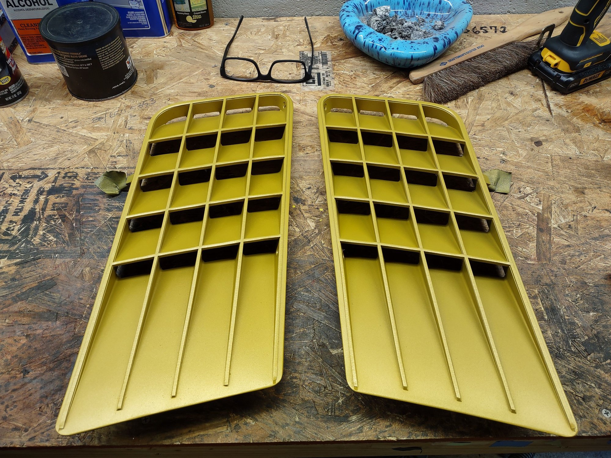

Mine were already stripped when I purchased the car. I wiped them down with acetone then primed them and used the razor scrape method to test before going any further...it was a pain in the *** I then taped off the edges with 3m fine line tape and sprayed the base and clear. I felt the tape was easier and has less chance of screwing up your work.

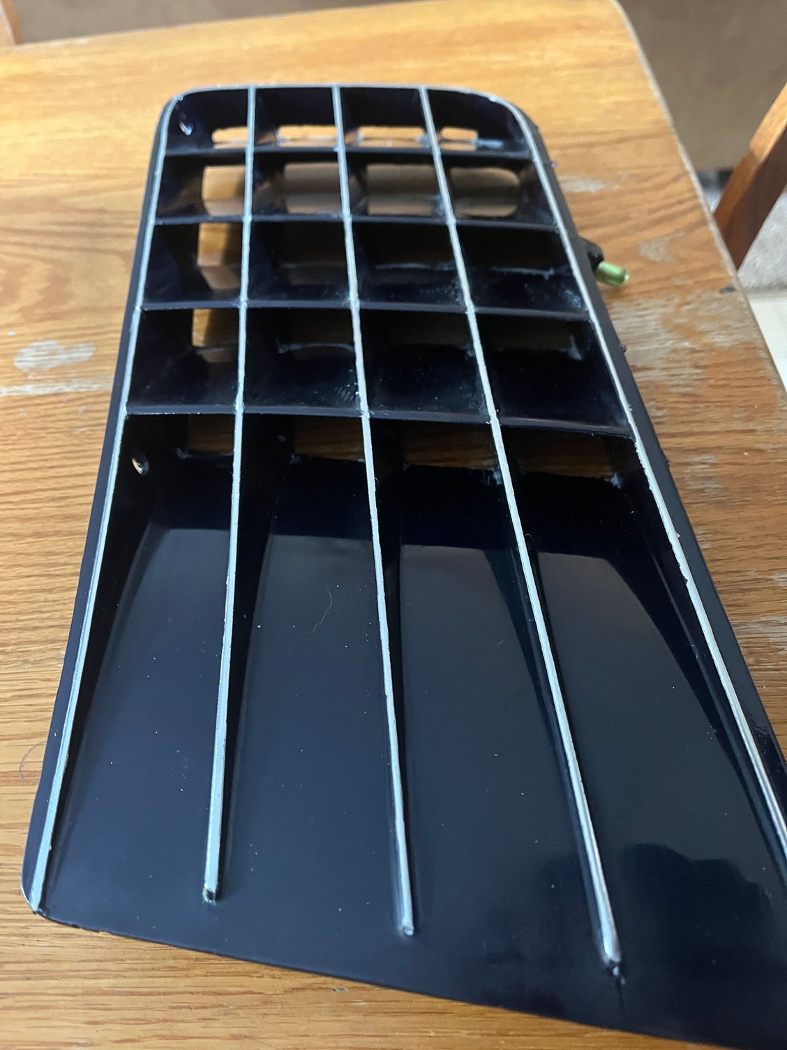

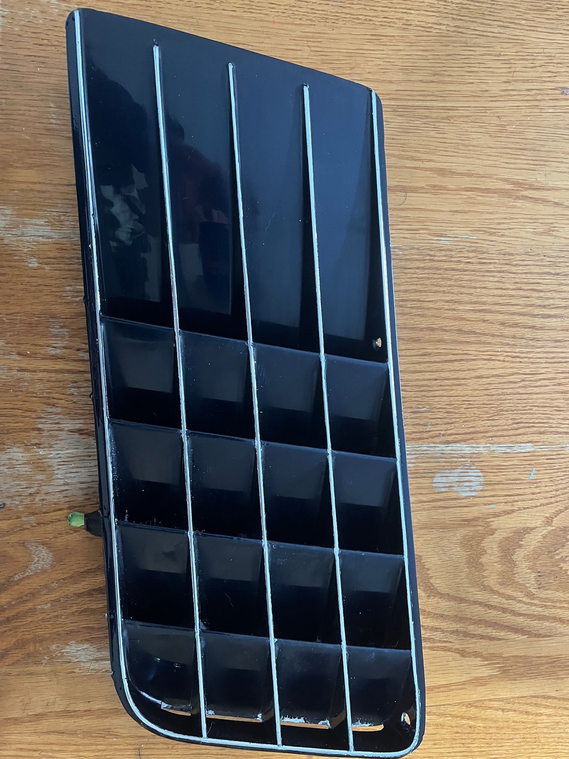

I stripped and had the egg crates on my 70 repainted recently. I applied a good quality masking tape to the edges, then ran a razor blade along each side of each fin to trim the excess masking away. Hardest part was masking around the corners and front edge where there was no edge to use for a guide.
Prepping was the worst part, sanding every tube, time consuming, tedious.
There was quite a build up of materials, primer, base and clear coat when I finally removed the tape.
I haven’t finished buffing yet, some pictures of the egg crates as they are currently.
