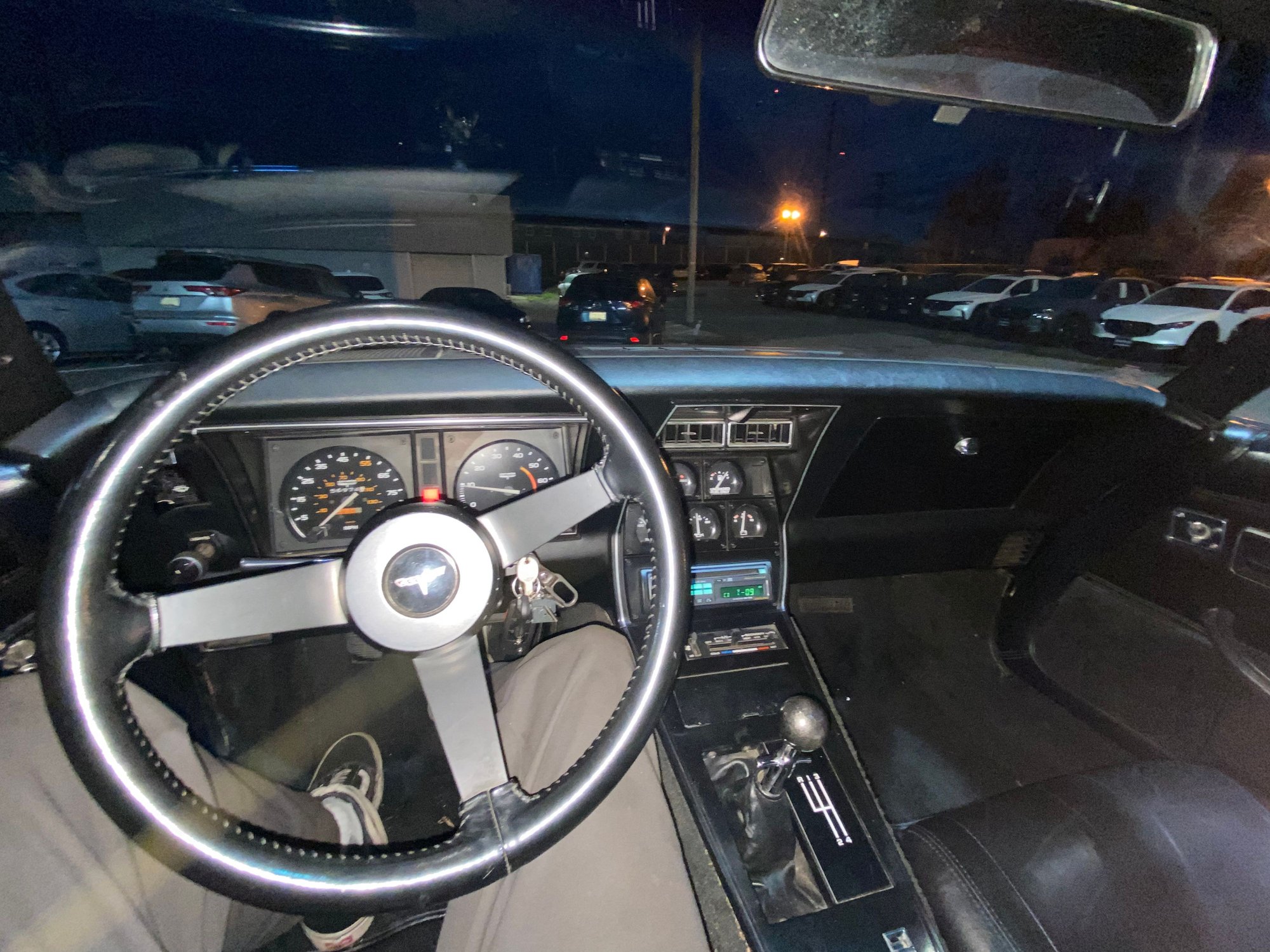

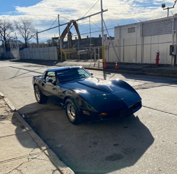

Hello all, I just purchased a 1981 black on black four speed with 57k miles. Made an account to ask questions on issues I have with it and posting fixes I find on issues.
The car drives really good and the engine still has all of the electronics on it, the only modification the car has to my knowledge is a CD player.
Im in MD and I’m going to daily drive the corvette on Historic Tags since I only live like 3-4 blocks from work.
Any suggestions on maintenance I need to do on it? Things to look out for?

Welcome and congrats! Nice looking car.

Welcome, Nice looking C3.

Congratulations on your gorgeous car and welcome! My friend is restoring an ‘81 as his retirement project. It’s a great car.

Gorgeous car, OP. And 81 is a great year - before the dreaded Crossfire injection....haha. I shrug, however, to read that you intend to make it a daily driver. in Maryland. The issue with that is the design of the box frames on C2's and C3's where they tend to collect water, snow, salt, etc in places where that stuff shouldn't be....stuff that will rust the frame and chassis, often from the inside out. Maryland, like the rest of East Coast (along with the Midwest) salt the roads in the Winter when it snows, and that is no bueno for our cars. Sadly, frame and birdcage rust, in varying degrees of severity, is a common ailment for this generation of Corvette...
