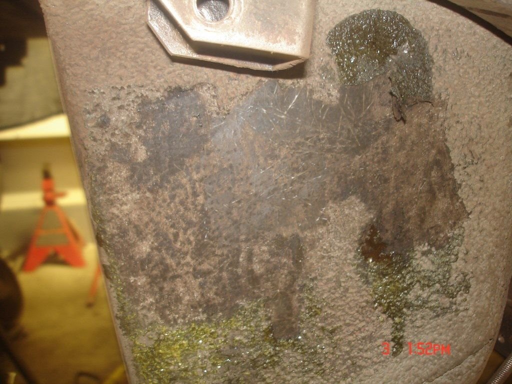

Elbow grease... Remove the heavy stuff with a hard plastic scrapper or flexible putty knife. Sometimes heating it a little with a heat gun sometimes, if it's old it'll usually chip off once you get underneath. Then lots of rags with varsol and rubber gloves and fresh air / fans

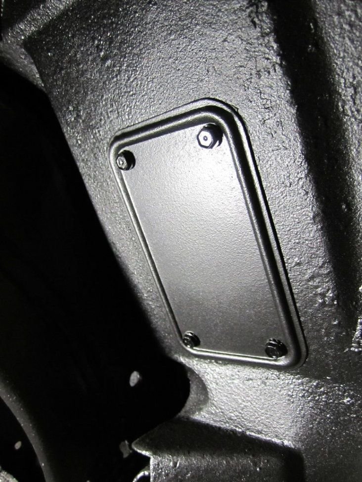

I re-sprayed the wheel wells with 3M 08883, it gives some protection without looking too thick
Splash shields and other items got spray bedliner, a bit less undercoat looking but still has some protection

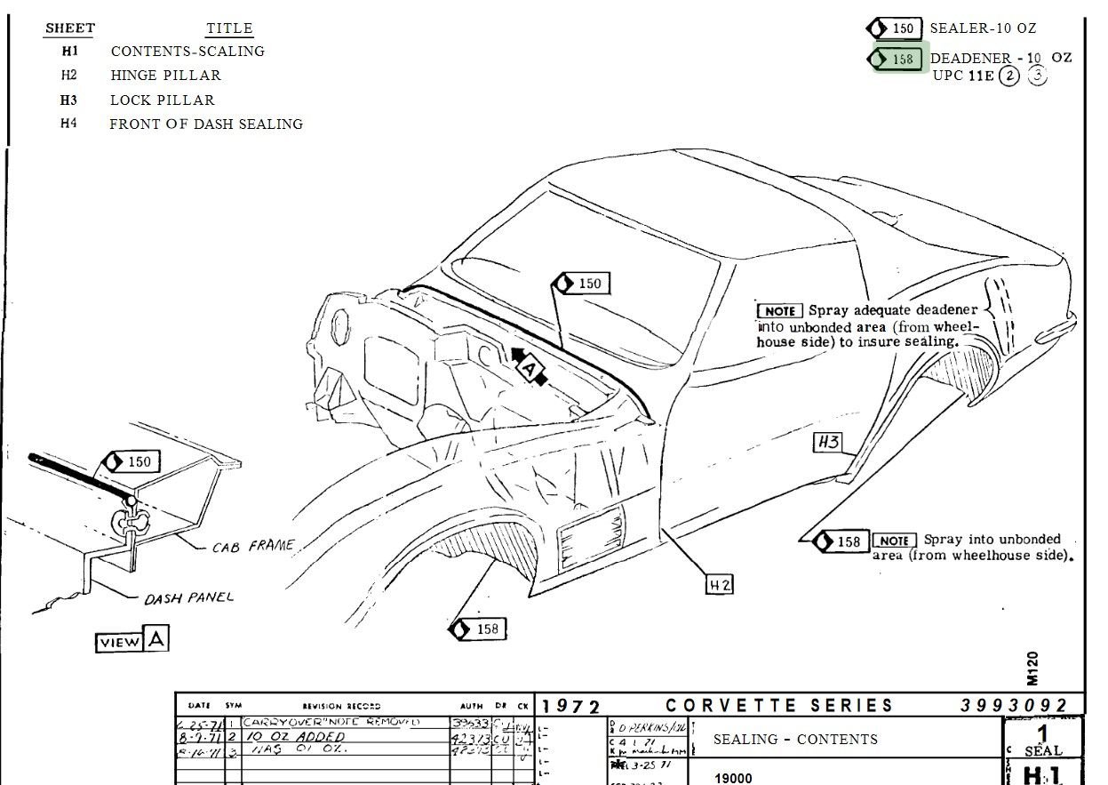

My 72 had it shot into the wheel wells from factory. They called it COATING U/B PROTECTIVE (then someone sprayed rubber undercoat all over the place ) .
I always look at it as something to prevent the rocks from hitting the underside of the fenders/quarter and star chipping the paint type of thing
M
