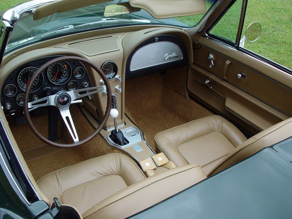

Below is the last 65 I did that came from the factory with green interior.
that interior looks awesome! Yes I have read about the aerosol, the only part will be dyed in medium saddle is the steering column..... in this pic and others I seen it the dash pad looks to be a brown, ( I really like the contrast in the color compared to the rest of interior) unless thats trickery on the eyes, and it is in fact medium saddle.. can you confirm this?? Last year I bought everything but the seats and dash pad, I just haven't decided yet if I am going to change the seats for another year..
Not 100% sure what a day 1 74 dash pad would like against the door panel color, ageing has a lot to do with this. Maybe a 1974 sales brochure might have a saddle interior in it to compare.
