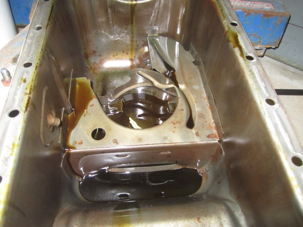

So I recieved a 1968 Corvette 390/400 HP 427, complete, looks like it was in a boat. This is the pan that was on it, long sump with a baffle and other oil containment.
Is this a stock pan? I'm planning on putting it in a '68 El Camino, pretty sure I need a short sump for that. Any thoughts on what I have here?

This is what my LS5 pan looked like, seems the same

Really need an outside pic from the side.

the corvette pan had the drain in the back of pan in the middle unique to the corvette there were several 427-454 pans

You can see the drain plug in the back in the picture there.
Vettes were the only one to use the little trap door that I know of as well. Single step, 5 qt. I believe they had the same pan from 65 up to 74

Mooser and forman are right: all 396, 427, and 454 Corvettes used the same pan, and, the drain plug is in the rear center of the pan. Wrencher, your pan looks like a big block Corvette pan. There are other big block Chevrolet pans used for other models, but they don't have all of the features outlined above.

Just did some quick searching and it should fit...I dont think there is any cross member interference
Just get the correct oil pump and pickup tube
Ecklers sells one that looks like a vette pan for the el camino

your need a 65-72 Chvelle BB pan

Interestingly enough, GM just stopped making the pan a year or so ago. I bought one ~2 years ago for about $220 directly from my local Chevrolet dealer. As I recall, the only difference over the years was that they dropped the spot welded corner reinforcements so you just bolted them separately.

I think it'll be too long in the sump area to clear the ElCamino crossmember on the frame. It's a lot longer in the forward area of the sump.

Definitely will not fit A body or F body

That's what I'm thinking. I'll look for the Chevelle piece or buy aftermarket.
