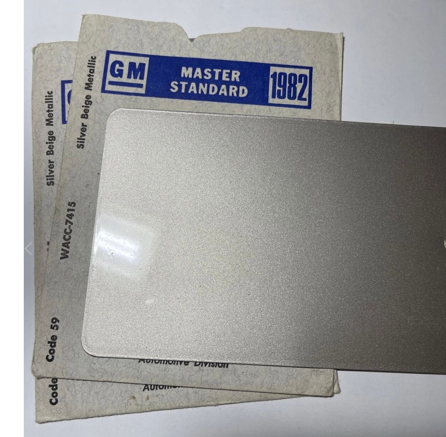

Here is an exmple right now of an 82 code 59 for 10 bucks!

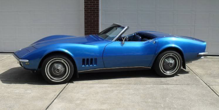

Here is my international blue car in the sun. As I said the PPG lacquer was a dead on match
...that looks great for International Blue. I'd be happy if mine came out like that, but didn't.
thanks. It’s mostly original GM paint! I just touched up the door and a few chips
