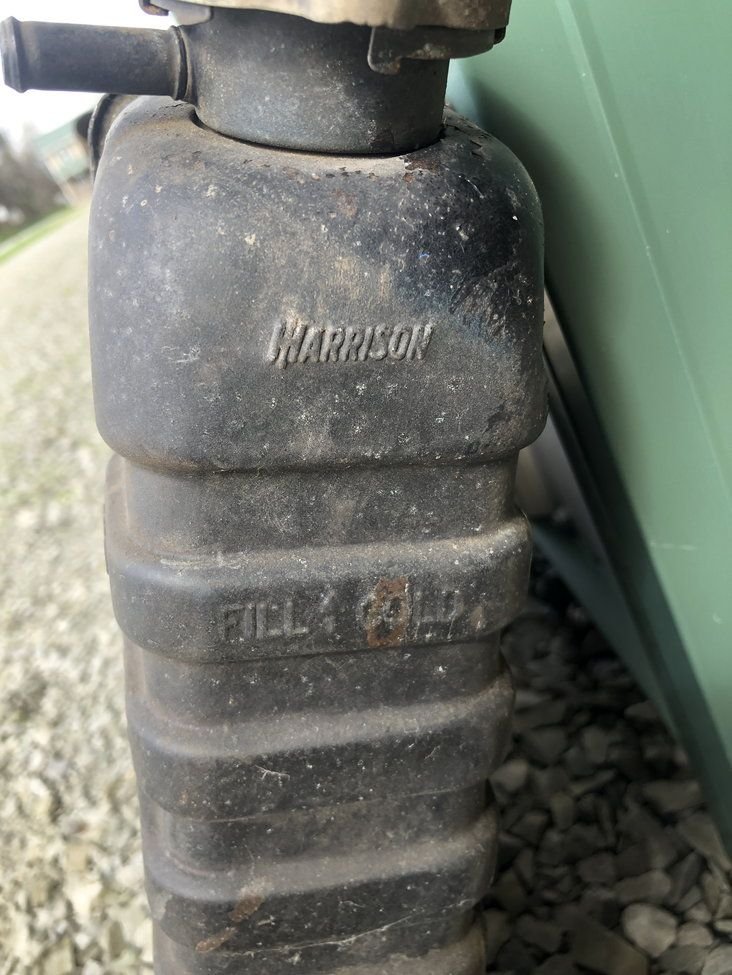

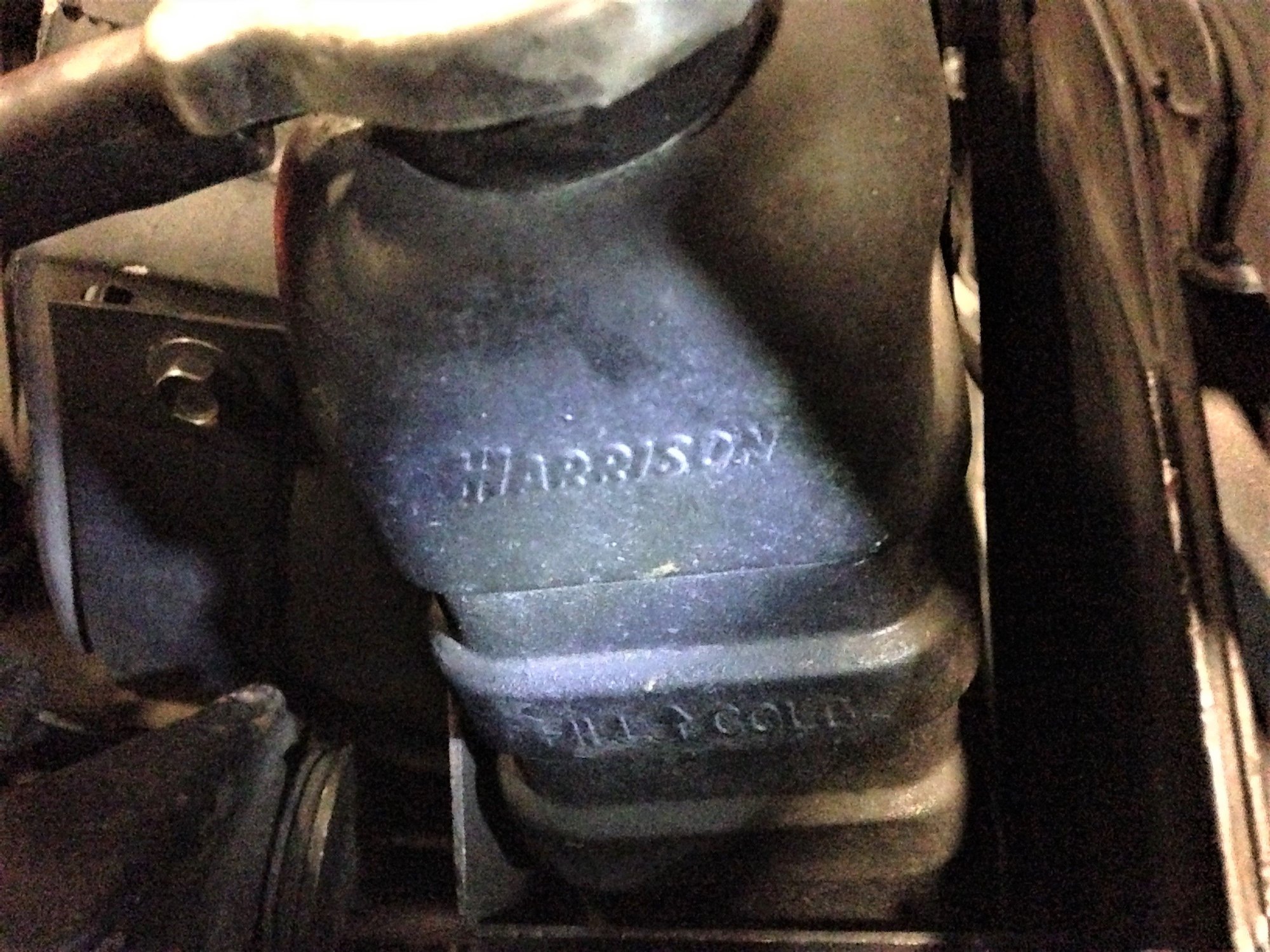

Original radiators had a indicator of proper fill level on the passengers side of the tank when cold. If you are above the line it will purge the over fill when shut down. here an original line location.

By the way, what you have is an expansion tank, not an overflow tank. An expansion tank is part of the pressurized cooling system (you can consider it an extension of the radiator) and must not be filled to the top unless there is also an overflow tank installed. Exactly like those OEM radiator pictures above that indicate a cold fill level. Expansion tanks have a pressurized radiator cap.
An overflow tank is an unpressurized container that will catch the overflow when hot and then feed the overflow back in when the system cools. Later C3s had a radiator cap on the radiator and overflow tanks. There may have been an early-70s environmental regulation, because around that time all new cars came with overflow tanks to prevent belching of coolant onto the ground. C4s have both an expansion tank and an overflow tank.
