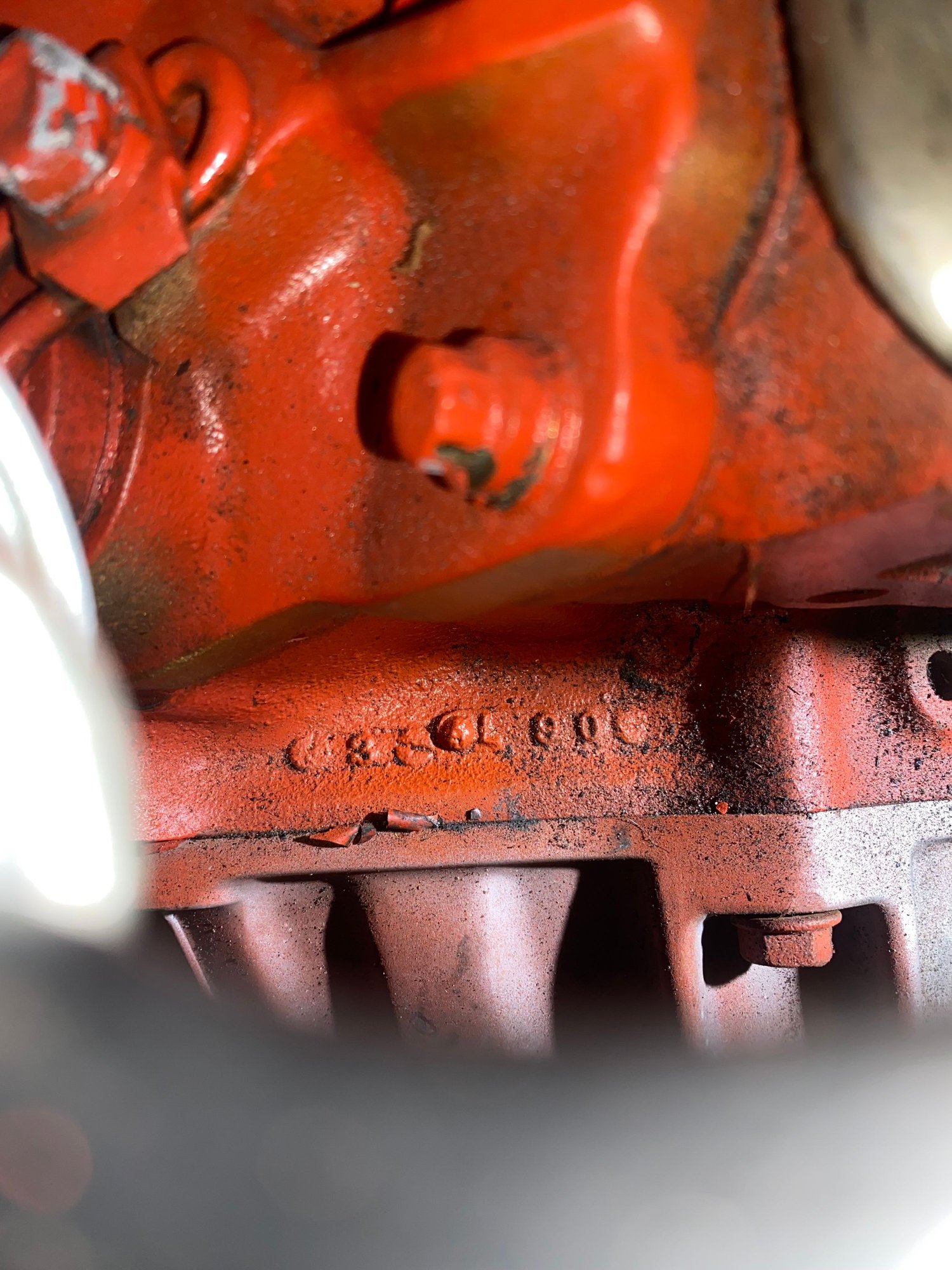

I'm trying to find find information about the engine in my 1971. This is what is stamped on it.

Looks like a rebuilder identified as TRICO rebuilt it in March of 1979. Block appears to have been decked, removing the original factory stampings.
Get a picture of the block casting number and casting date from the rear shelf.

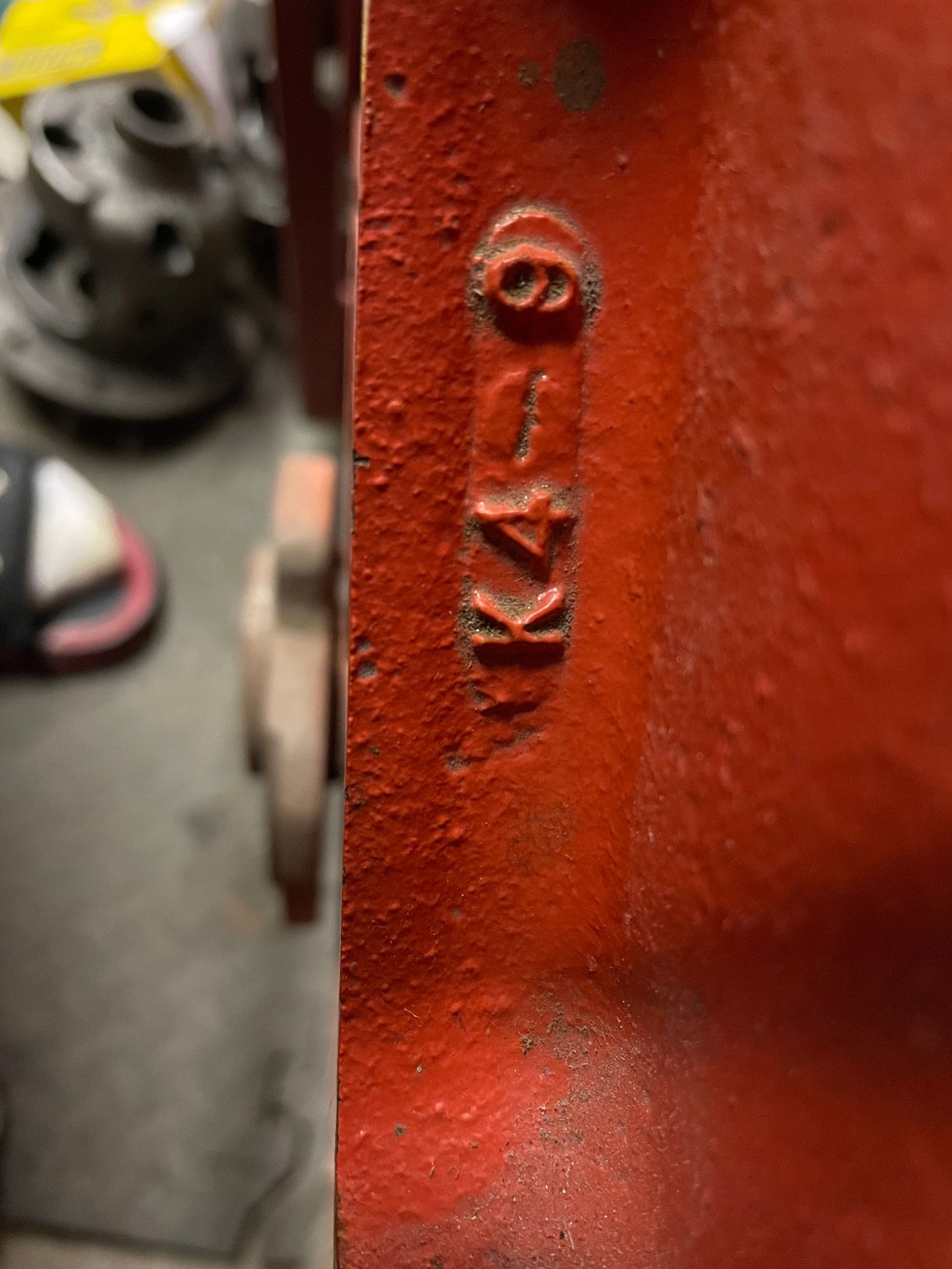

Here’s an example of the block casting date. These should precede the production date of the vehicle. What are the last 5 digits of your VIN?

Likes: 1,821
From: Apple Valley, MN
That VIN puts you in the last week of production of April 1971. The block was cast March 26, 1971 so it looks like it could be the original block as that date code lines up nicely with your car’s date but it is possible someone found a replacement block as the 010 blocks were used on many Chevrolet (and Pontiac) cars then. If you are willing to pull the valve covers, you can see the head casting numbers and date codes there as well.

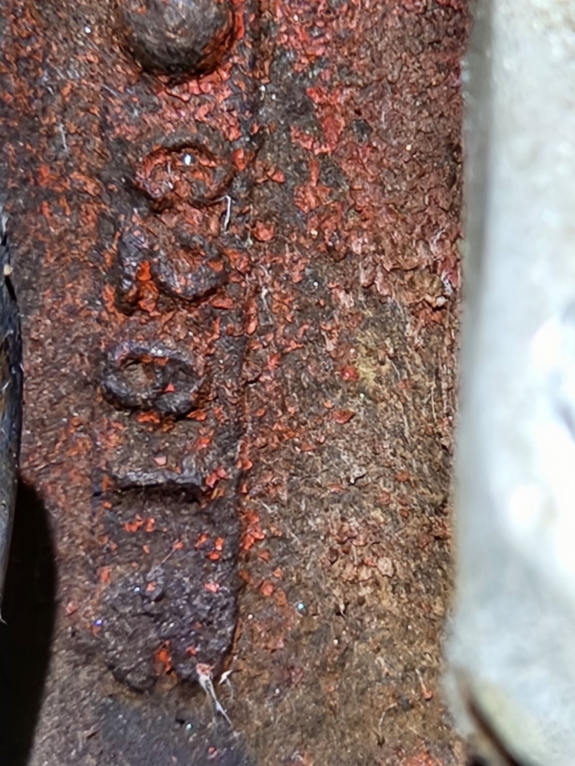

Default Engine Date Help
[QUOTE=69L88;1606269213]That VIN puts you in the last week of production of April 1971. The block was cast March 26, 1971 so it looks like it could be the original block as that date code lines up nicely with your car’s date but it is possible someone found a replacement block as the 010 blocks were used on many Chevrolet (and Pontiac) cars then. If you are willing to pull the valve covers, you can see the head casting numbers and date codes there as well.
[researching prior posts for help I came across this from last year. Hope someone can help. My 71 engine was rebuilt by previous owner. Numbers decked off front #2 plate. My engine date, I think, is “L90” (see photo) which I think is December 9, 1970. Couple of questions 1) does this date make sense with a build date of August 1970? 2) what is the “3” in the photo?

A casting date code cannot be later than the production date of the car. That block was originally installed in a late December 1970 or early January 1971 build of a 1971 model year car.
