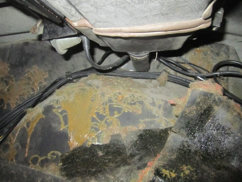

Kick panel, sill plate, rear quarter trim and then into the rear carpet, there are some clips along the way
The wires all make a weird turn at the back wall, I would have thought they should have run it out the side rather than the back
Now if you're in that deep, ok but if not I'd be tempted to run a new cable through and just tuck it up under / behind all the trim, (maybe have to deal with the sill and kick panel) and then deal with it proper later on when there's a reason to take more apart
