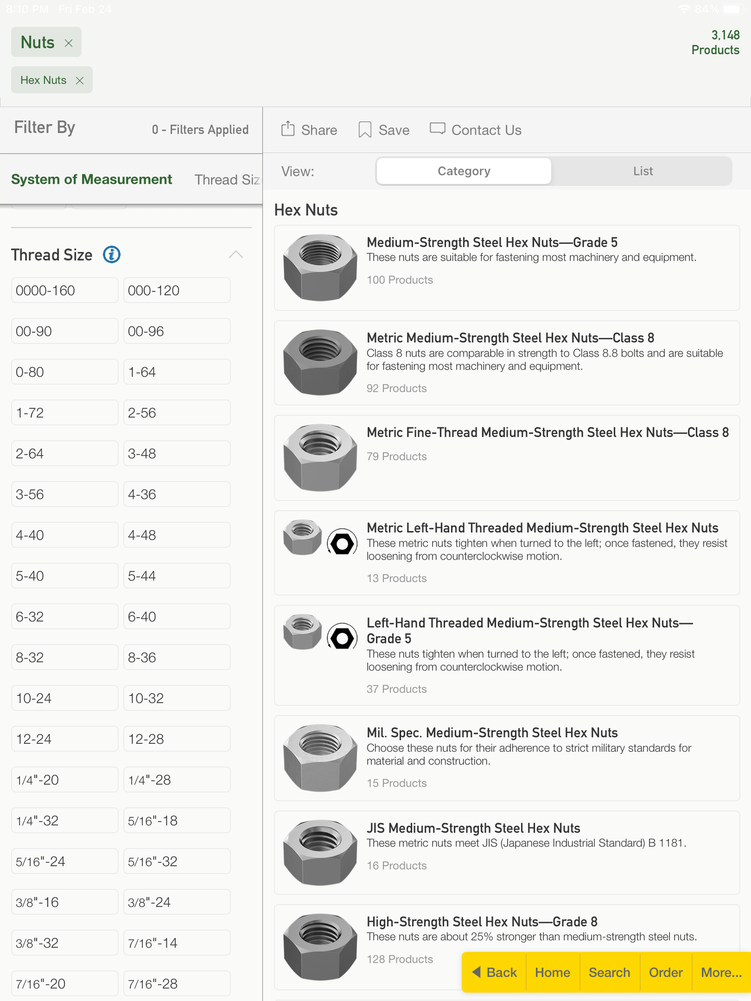

ace hardware and mcmaster carr for me

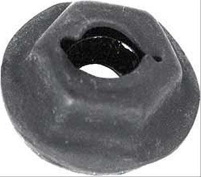

Side marker lights, rear wiring harness. Looking for a nut that goes on to yhe side marker light on the lowet rear quarter panel.

Pretty sure those are going to be "speed" or "emblem nuts" not regular hex nuts. And auto NAPA type place should have them

Yes, that is what they are...

They are also called PAL nuts.

I've heard of them called Speed nuts most commonly, and yes PAL nuts as well.
I agree, it's a auto parts store kinda thing.

Those studs were not threaded, the speed nut when installed for the first time would cut threads (loose term) into the stud.
