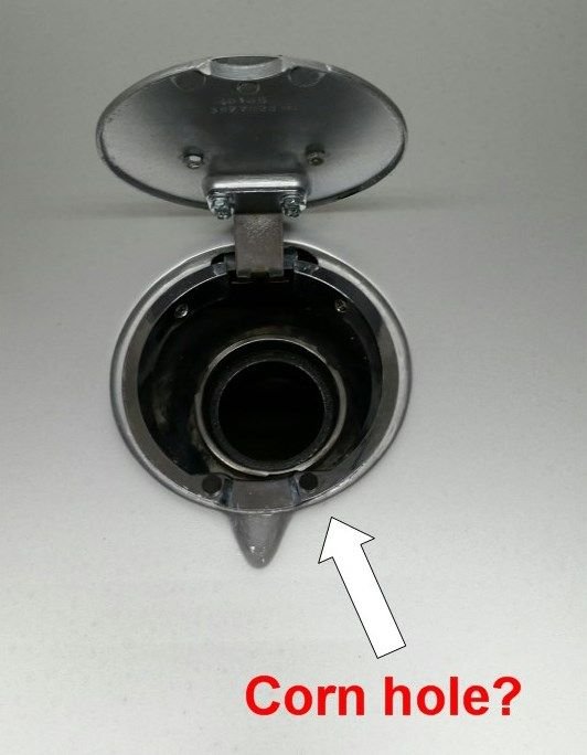

Mostly good news Bro'
Pretty hard to find corn-free gas here in CA. Download the "Pure Gas" app on your phone and it will show you any stations around your area that sell non-ethanol gas. I'm over in Palm Springs but the nearest corn-free is 20 miles away in Indio. A 40 mile round trip kinda defeats the purpose for me, but you might be luckier.
Cheers, Greg
