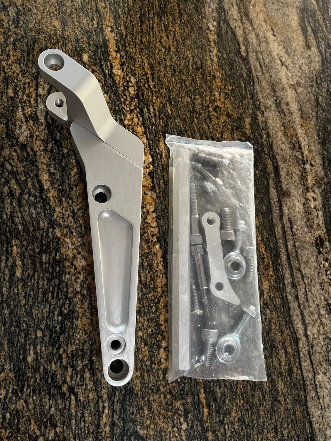

Jebby,
Doesn’t he need an alternator bracket specific for a short water pump, or is that only a big block issue?
Here is a picture of the one I purchased from Summit.
It is available in polished aluminum as well.
This one is for my big block, but you get the idea.
Great quality!

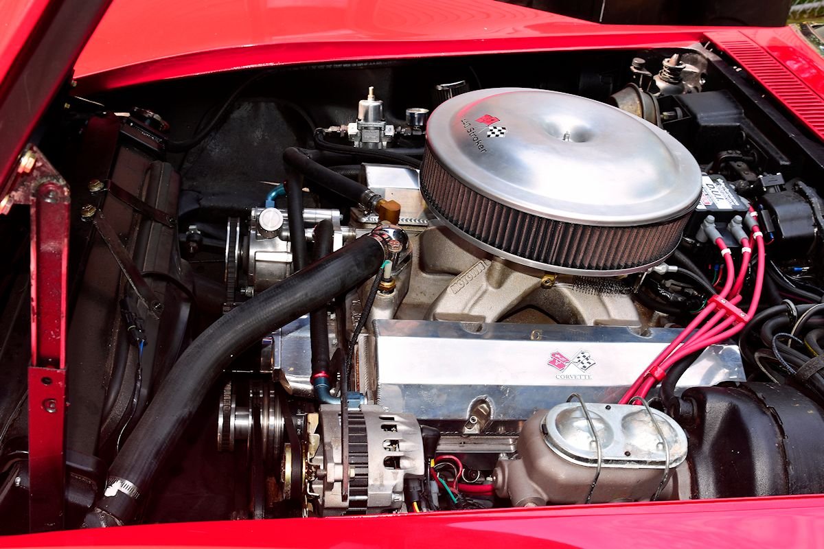

Great quality!
The pic I posted above is for a short water pump.......truck and Corvette were very similar......in fact we used my Vette to see what we needed for a friends 71' Chevy truck he was restoring.....we wanted to put the factory A/C on it and it had the long water pump setup on it from the late 70's early 80's.......which puts the compressor on the wrong side......so I told him to convert it to short water pump and snapped a pic of my Vette to give him an idea of what he needed....the only thing different was the upper arm as explained.....pump, pulleys, brackets were all the same.....and we used the Hooker Summit knock off bracket because he had headers......

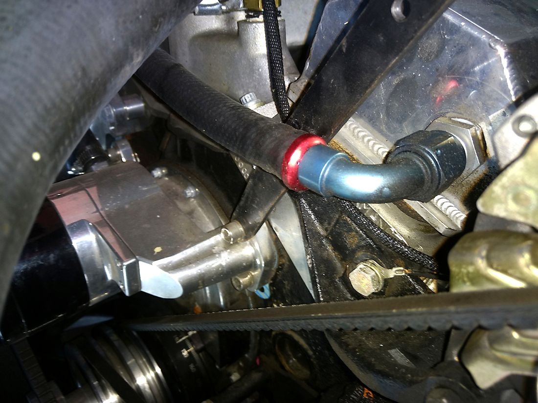

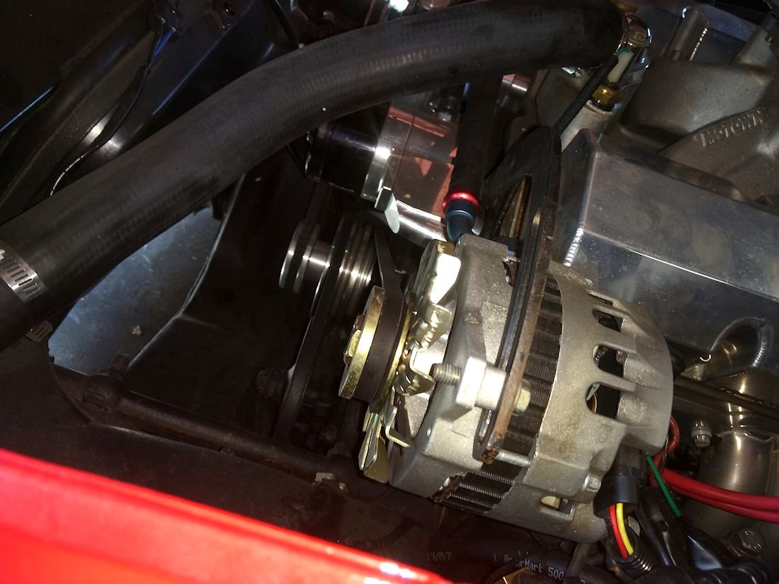

Can you show me a pic of yours…? I’m thinking the upper stock support that’s on there now, and probably the original one, can be used. I just need the lower support…
Sorry, not the best pics, but I was able to use the stock upper support arm on mine. Otherwise it looks exactly like the example pictured. This will work...https://www.corvettecentral.com/c3-6...st-iron-303116
Mine.....
