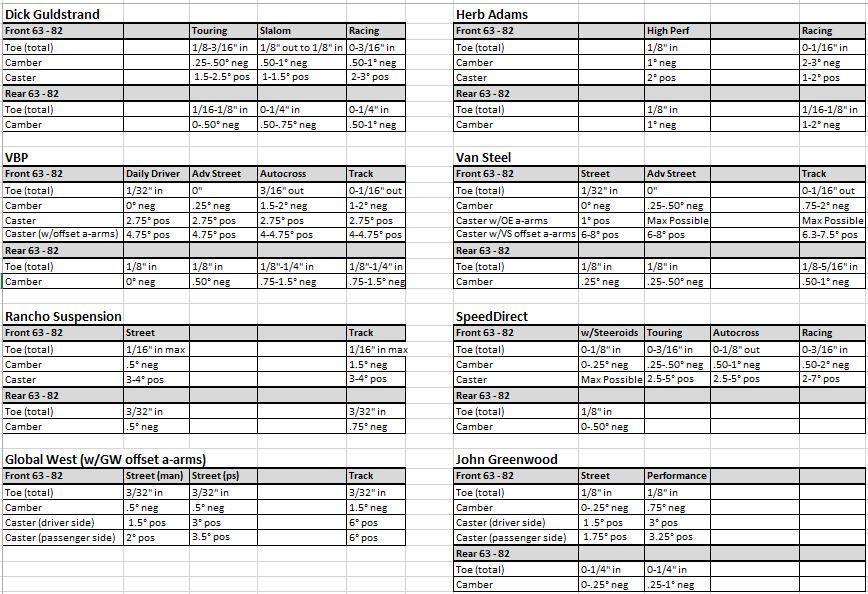

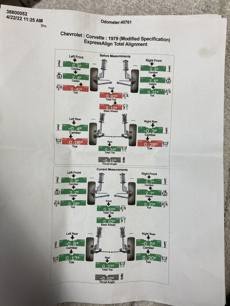

To all C3 gurus,
Can anyone delve into their knowledge banks and send me the rear wheel only alignment specs for my 78SA?
JJ78

Don't know if this will help but, I got this

rear is weird because of "backing" on the pads that slip for align.
it is not so simple as pulling forward and doing readings.
