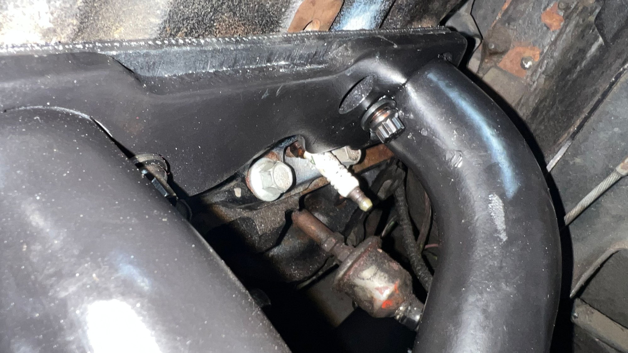

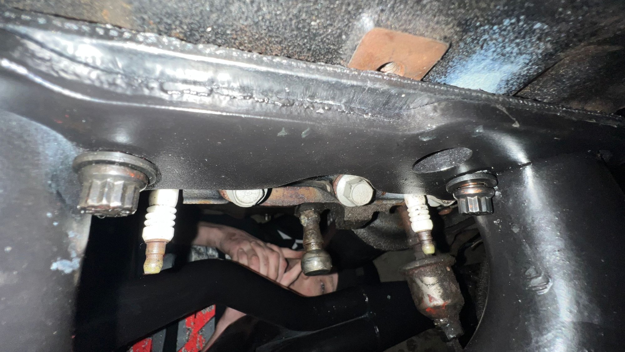

I got these ARP bolts to put my Hooker headers on. It’s a 12 point head. The socket I got worked for the front 3 and the very back one. But the two middle back ones are impossible to put on with the socket. The socket doesn’t clear the pipes making it impossible to tighten the bolts. How else can I tighten them?

Dimple the header tube to provide more clearance. You may also find slightly increasing the hole diameter or elongating it will give you a little more wiggle room to work the bolt in along with the suggested method of starting the problem bolts first with a gap between the cylinder head and the header.
12 points are neat looking but a royal pain since getting a 12 point box end wrench is sometimes impossible compared to a 6 point bolt where an open end wrench makes life a whole lot easier. Don't forget the necessary retorque after the first 2 to 3 heat cycles until the bolts hold torque.

ooooh. Like an open end 12 point wrench, or at least shaved down to thin metal on one side - similar concept to a thin wall socket. That's not a bad idea, but not sure how significantly it would weaken the wrench. Just don't do that to a Mac or Craftsman, OP - maybe a HF special, if you decide to go that route.... However, It is important that all bolts be properly torqued to specification to help ensure no leaking.
Aside from that, dimpling would be the preferred method as interference from the header itself against the bolt head may prevent a 'straight shot' for the bolt and you risk cross threading, which you don't want, for obvious reasons. If you're not comfortable beating on your nice headers, a machine shop would probably do it for a nominal fee. Ideally, you want to get a proper wrench on those bolt heads so you can torque them down to specifications using a torque wrench.
Looking at bolt that's focused on, in this picture, I would say that you're NOT going to get the last two bolts in, as is. Looking closely, you can see that the washer is butting up against the primary pipe, therefore it's preventing the bolt from PROPERLY engaging the threads in the cylinder head (going in straight), let alone allowing the use of a wrench. Hopefully, "dimpling" the head pipes could give you the clearance you need.
However, I'd also be inclined to double check the hole spacing in the header flange, to make sure that they PROPERLY line up with the threaded holes in the head. You don't want to force anything, and damage the threads in the head.
