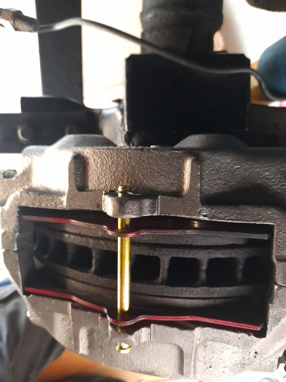

Now of course some of you think my Caliper is indeed so badly aligned that this caliper did indeed get this worn by my Horribly maintained vehicle.
So, after cleaning up this caliper. And reassembling without all the debris inside. I mounted it on my car. Bolted it up tight. And took these photos. The brake line is not yet connected in these photos. But I think you can get an idea none the less.
Looking up from bottom/rear.
Looking from the upper front.
Looking down trying to get a look at outboard pistons.
Looking down from top at inboard pistons.
As you can clearly see. This does not look like a severally miss aligned caliper to me. And I will admit. After 46 years perhaps it's not absolutely perfect. But I wonder how perfect they were new. So,

In your photos I don't see any photos of the piston.
Something is askew...if piston to bore clearance was within spec everything should be OK.
Section 5 Page 29 of the 77 service manual.
There's really nothing magic about it...

Yea, I agree you got sold an inferior part. But I’m wondering how one can tell the piston is miss aligned in the cylinder by the two caliper half’s bolted together and installed on the car. And if the cylinder boor is out of spec,,, well, yes it’s going to fail at holding fluid.
No matter what, it sux to be in your position. You’re always spending time or money, and not getting the desired results. I get it,,,, C3s are awesome fun when they’re working. Not so much when they need repairs. Reminds me of Harley-Davidsons,,LOL,,
I think this is fairly obvious with the caliper in hand. A misaligned (cocked) piston won't move in and out - other than that there's not much room for any sort of alignment - it's either square in the bore or cocked and jammed. At least this is my experience when rebuilding calipers.

The pistons in our corvette calipers have considerably more room to move about than any other caliper I have ever seen. And yes guys, I really am a professional mechanic and have seen a LOT of calipers. So my take on it was if the caliper was mounted on a angle. Weather end to end or top to bottom the pistons would follow the disk and be on a angle. And yes these pistons do fit this losely. So this is why I showed photos of the caliper mounted.
another asked why I didn't show photos of the pistons. The pistons are indeed new and mic up fine. I was trying to show the problem areas with my photos and didn't think to take photos of parts that seemed fine.
after removing all the debris from the caliper, and there was plenty. And honing the bores I reassembled with the pistons and seals it came with. So far it's holding fluid. But one bore is clearly out of spec with .010 clearance.
I thank everyone for there suggestions. The new calipers someone pointed out, after the exchange rate and shipping would be more expensive than the Wilwoods. Which are way out of my budget. At that price I would have to walk.
So my current plan is to take my old caliper to a brake and clutch shop here in Australia and have it sleeved. I know some shops here do this kind of work sleeving master cylinders on old cars. So hopefully I can track down a shop that can sleeve my old caliper and actually get the bores within a thou of one another.
