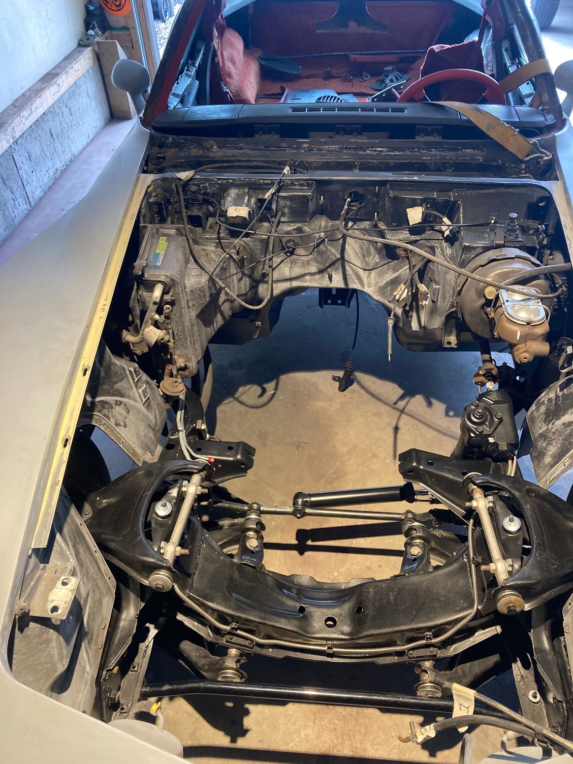

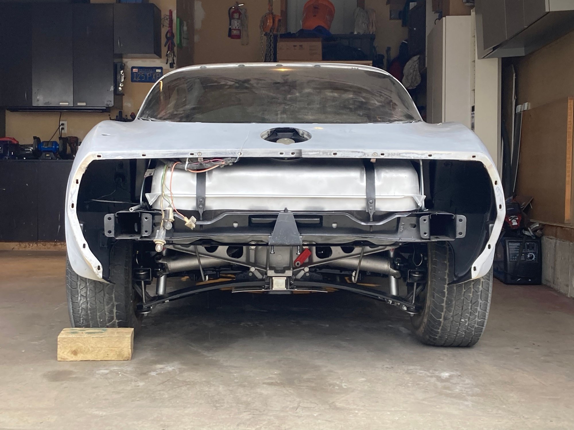

Thanks for the reply,
The type of driving is going to be Sunday cruising a bit of highway and mostly city driving. I dont need a race car or more top speed but just want some more grunt than the lazy old 350 that was in it.

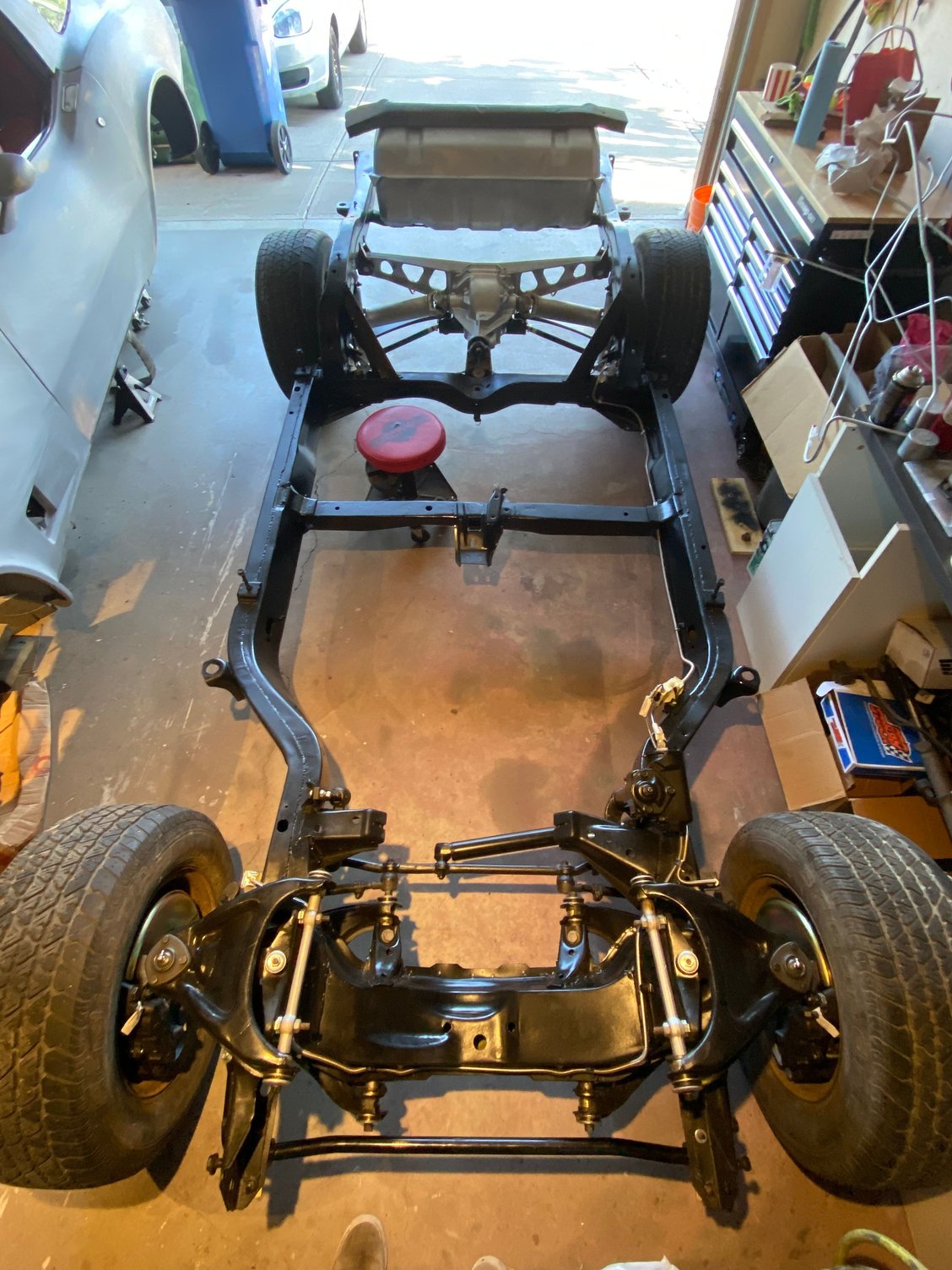

The car hasn’t been on the road in more than 20 years. I just got the body back on it after doing a full chassis rebuild
The blueprint engine specs are 377 actual cubic inches and 436 hp/443TQ. I think it makes peak TQ around 3500-4000rpm

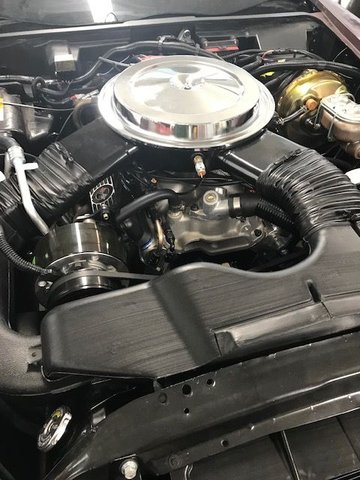

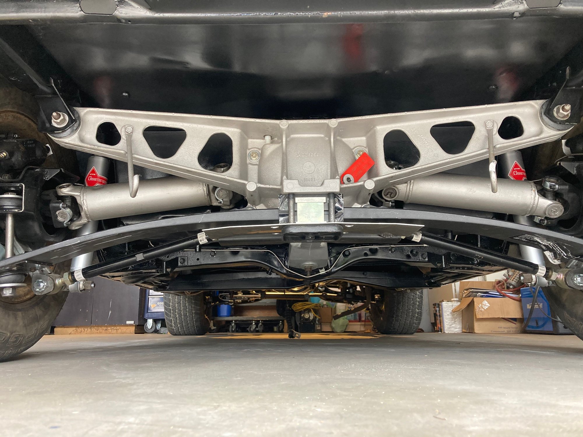

Here’s some progress pics. Still gotta clean up the engine bay and paint before I drop an engine in it

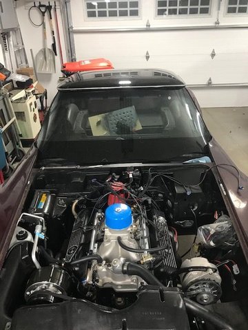

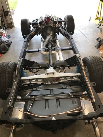

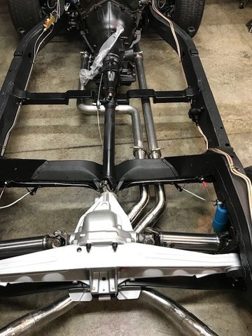

That 3.07 is not a horrible gear if you are running the T350. I would suggest you get with one of the transmission vendors and get a matched converter based on your cam specs, rear gearing, weight of the car, etc. Don't just buy one off a vendor website based on the stall speed of the converter. You will be at about the max horsepower your Dana 44 can handle too if it is stock or a stock type rebuild. The Dana 44 is not known for its strength. I went with a 4L60E transmission with an Edge converter matched to by setup and 3.73 gears in my 81. The Dana 44 was beefed up and rebuilt by Mike Dyer. I also went to a manual rear end in my auto, the side yokes, spindle flanges and u-joints are larger than the auto cars for 1980 and 1981. The 82 used all the manual parts in it even though there was not a manual transmission available. Looking good on the rebuild!

Thank you sir! Your build is nice too. You should be okay with the Dana 44 then. Hard launches and sticky tires can be the downfall of the Dana. I like the way the top looks and fits, haven't really got to road test it but I doubt I wall be driving it much with the tops on. I picked it up with the storage cover for $100.00, so even if I didn't like it that well, no big loss. I also have a set of the AM soft folding tops I ran across too. Plus the factory fiberglass tops.
That is basically my goal too, build it back stock looking for the most part but do some upgrades. Just running a 350 in mine though, AFR heads, full roller assembly, Edelbrock Pro Flo 4 fuel injection, forged bottom end and a Chris Straub roller cam setup. Engine/Cam, converter, and rear end was all matched to work together.
Motor is almost completed.
