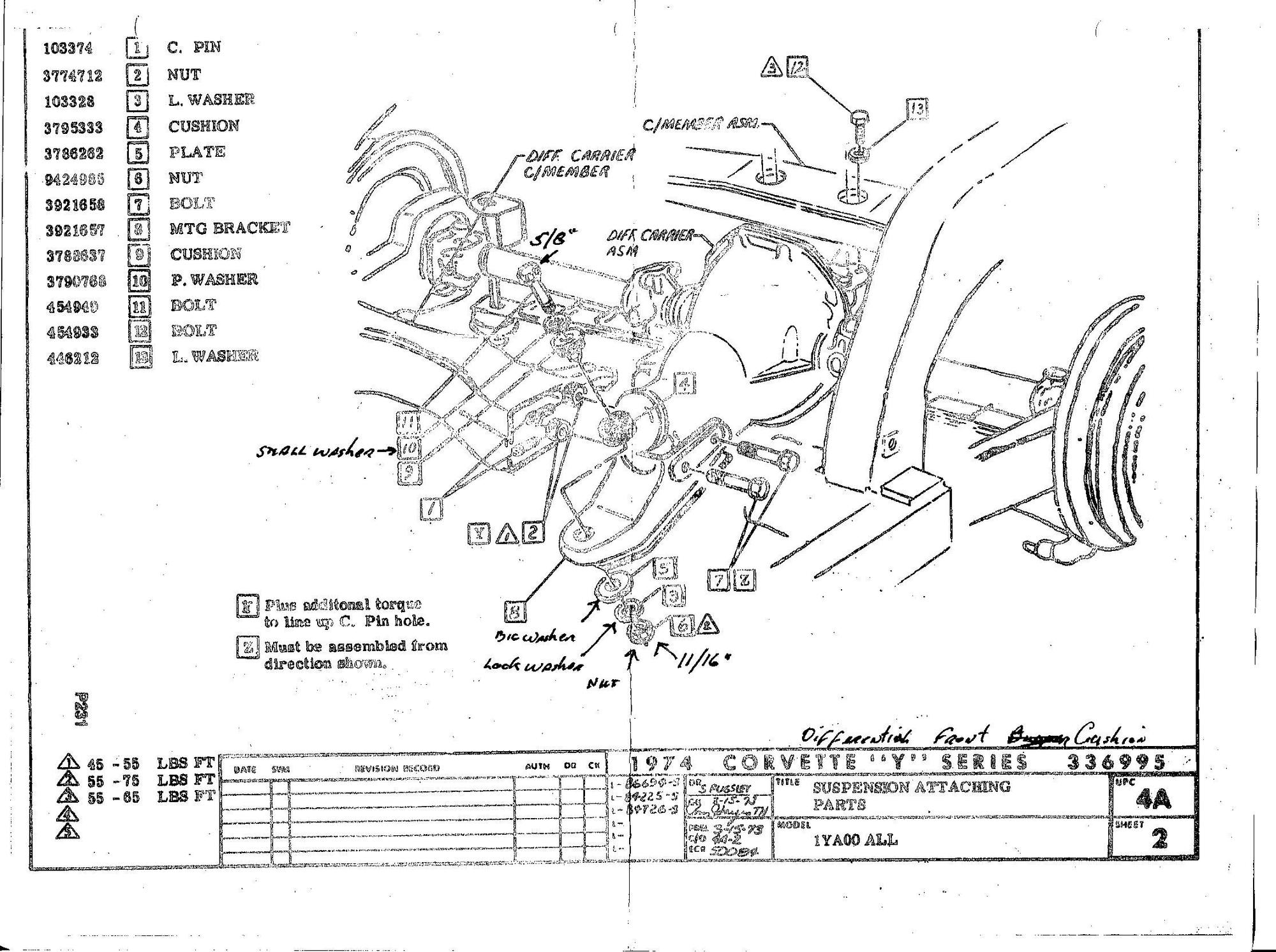

We replaced the snubber bushing, as we were getting a loud clunk when shifting into gear, and found some threads on that being the potential issue. The new bushing is in, BUT I had ot remove the bolts that hold the bracket onto the rear differential. I have tightened the bushing bolt, and even got the rear bracket bolt in, but for the life of me, the middle bolt will not line up. It is currently too low, and needs to come up to align the holes, but cant figure out how to get it to come up. I thought maybe I needed to tighten the snubber bolt, but I cant get it any tighter and it still doesnt line up.
Any ideas on how to get the bracket to move up, or maybe rotate the differential down to get the bolts to line up? I am at work now, but can add pictures later today.

Which bolt is not lining up, #7?

Correct, #7, the one towards the front of the car.

It's a pain to get everything lined up...that much I remember!
I think I reinstalled #7 & #8 bolts first.
Then I installed the snubber grommet using a pry bar to get enough clearance to tap the grommet in with a hammer (I think ) Make sure ti install the snubber parts according to the diagram, or the grommet will fail/rip apart.
Let us know if you succeed.

I thought I had to take that bracket off to get the snubber changed, so took #7 out, but couldn't get #8 out. Went back to trying to get the snubber changed without removing the bracket and figured out a way. However, after getting the snubber changed, couldn't get #7 back in the hole. If I remember correctly, I put a jack under the front of the bracket and got it lined back up with it.

Bracket on the diff first, then large prybar underneath with a strap / chain around the nose of the bracket and out the rear, lift the bar and it'll pull the nose down enough to get the bushing in between. Watch your fingers

I did mine while reinstalling the diff, I think I loosened the diff cross member bolts (after tightening them of course) to allow some wiggle room.

Thanks everyone, yup, sounds like i need to uninstall and reinstall, using bolt 7 and 8 FIRST, then struggle with the rest. *sigh* Due to his soccer schedule, looks like that will be in a couple of weeks.

Yes, install the two differential carrier bolts first. Make sure that you remove that # 8 bolt somehow. Even if you have to cut or grind it to get it out. It won't be any easier to remove a couple of years from now. ALWAYS put never-seize on any nuts and bolts to be able to remove them later on.I cheat on the snubber bushing install and put the nut on the top and the bolt from the bottom. Makes things a lot easier and no skinned knuckles. There really is hardly any room to put that bolt in from the top. Just be sure to use a lock washer under the nut and then the flat washer. Lou.
