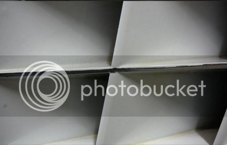

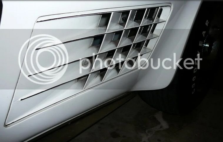

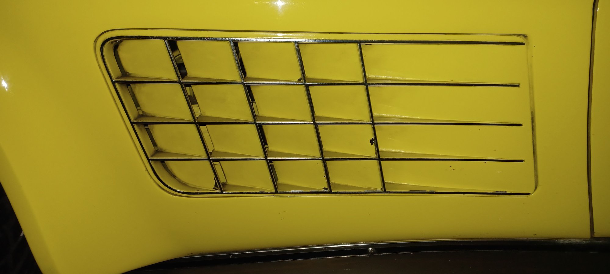

Here you go. FYI, car was repainted by a previous owner. I know mine's a 72 but, should be the same.

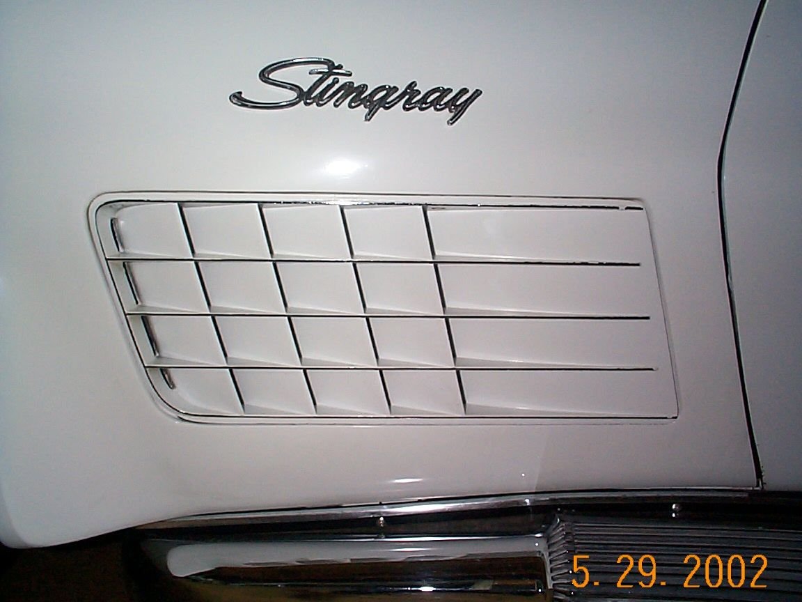

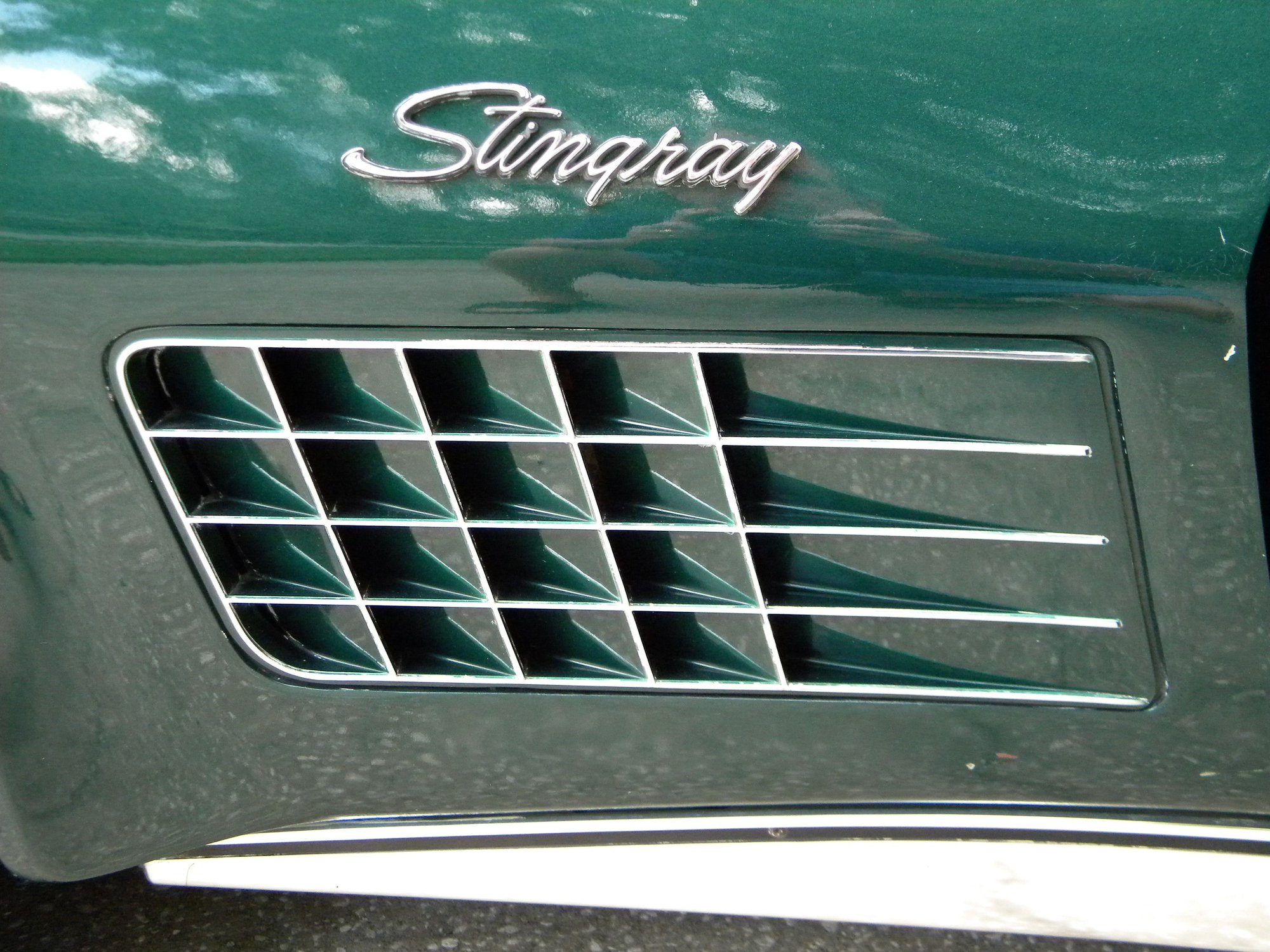

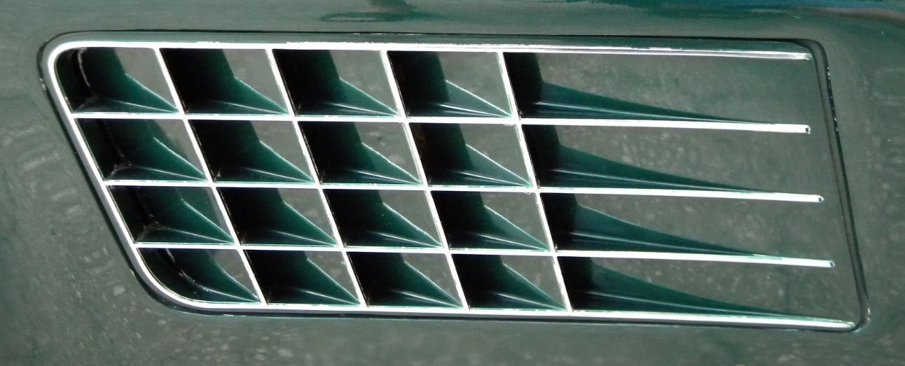

Here's how my '71 came from the factory.

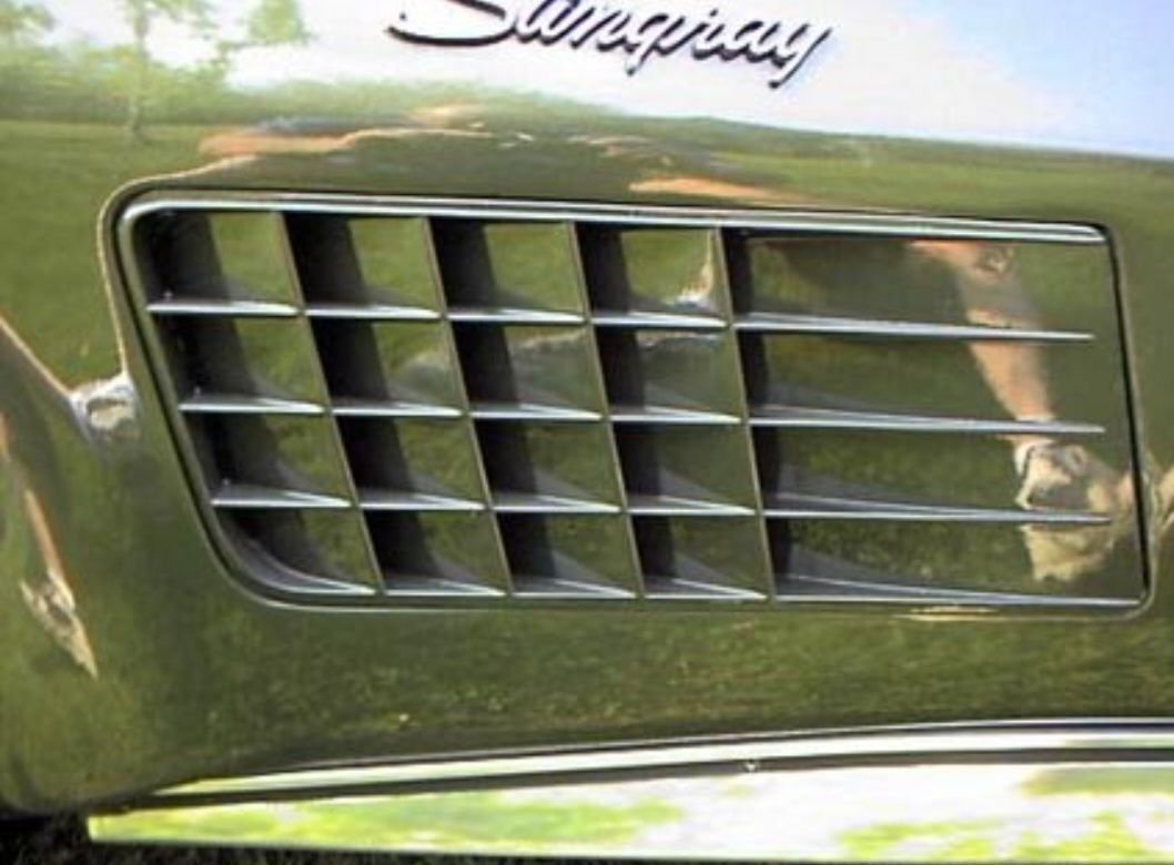

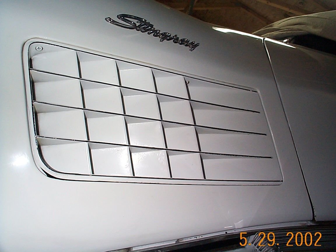

this is a 70. Different from 71 or 72

Correct, I had forgotten about the '70's having painted vertical edges that were tapered.

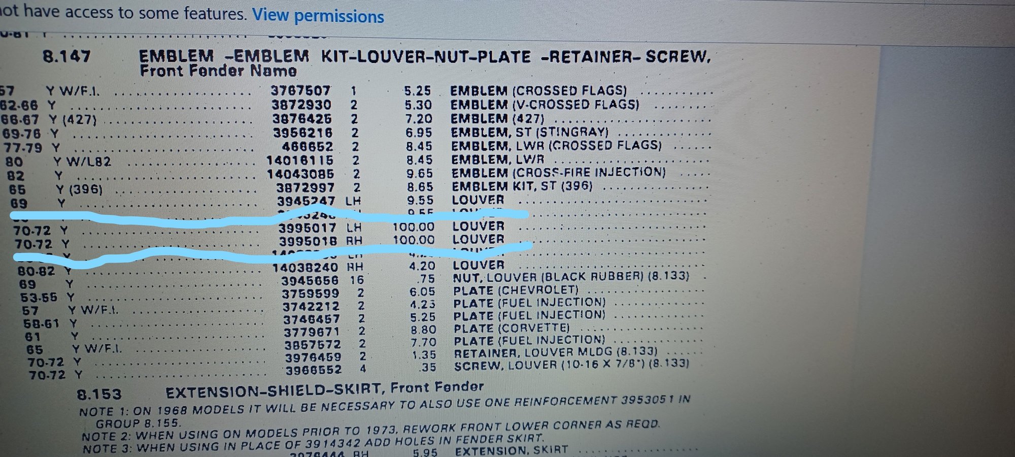

According to the GM Parts Catalog, 1970 to 1972 are the same fender louver.

With all due respect, it doesn't change the fact that for all intents and purposes, 1970 to 1972 Corvette front fender louvers are the same.

FWIW: The part numbers for the 70 louvers are 3966797 and 3966798.
3995017 and 3995018 are original for 71 and 72, service replacements for 70.

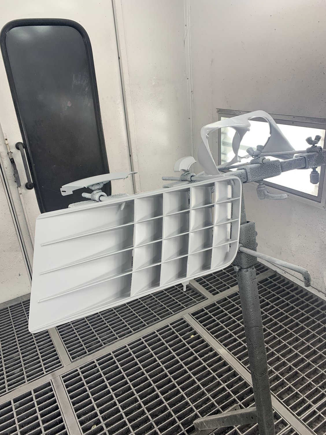

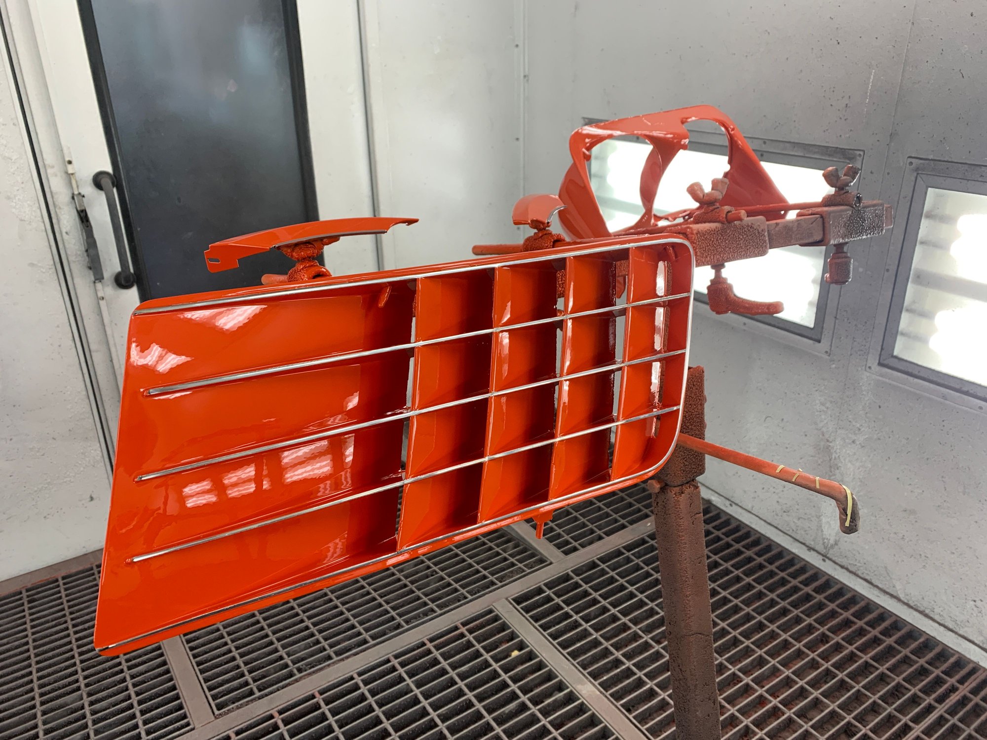

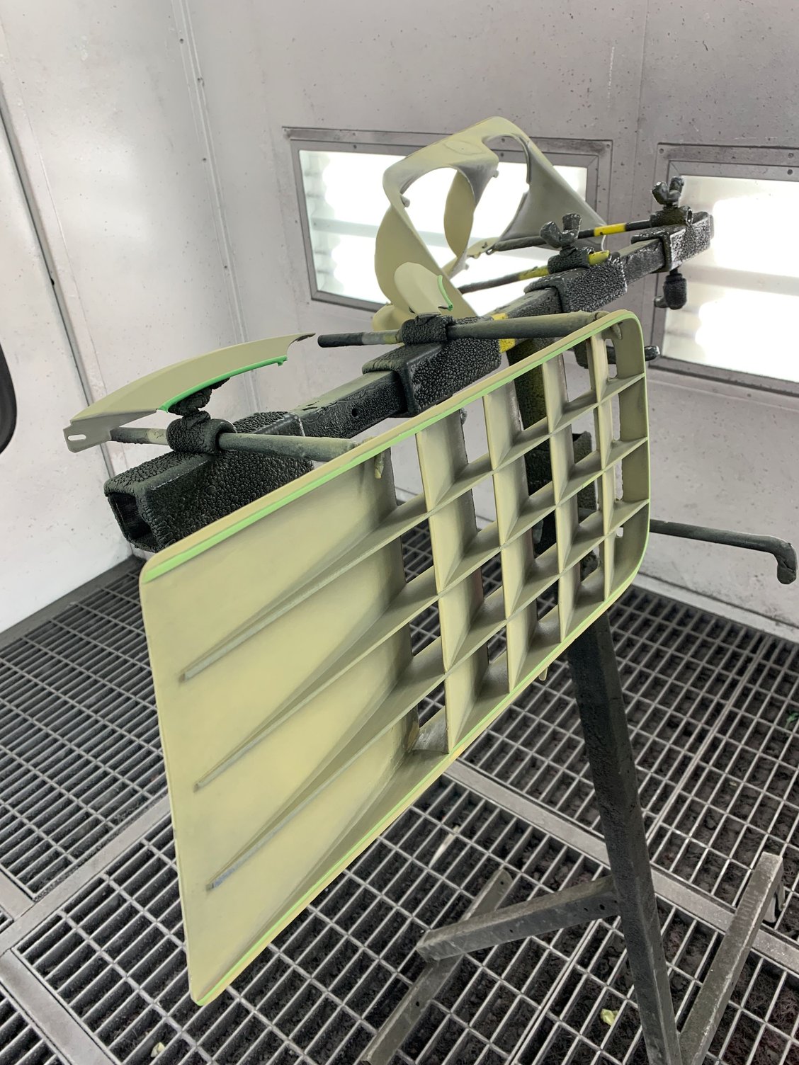

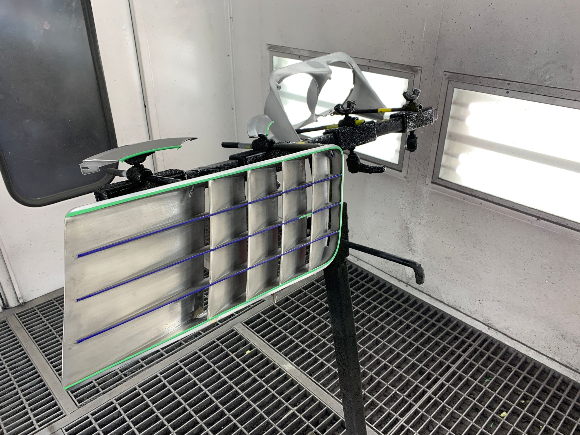

Some pictures of the side grilles paintwork

Nicely and correctly done!
