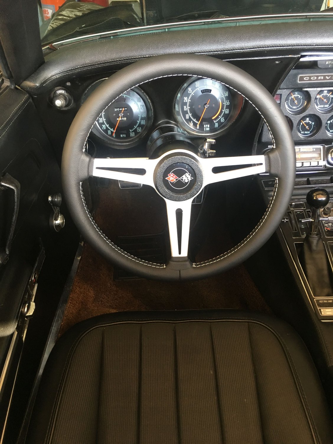

A steering wheel with less "dish" will get the wheel farther away. I'm 6'3 and I thought the same thing as you but after installing my Momo wheel with less dish the steering wheel now hits my legs. Tilt steering is the only fix for us tall guys.
I'm 6'4" and 270lbs, installed a 14" Mid America Motorworks wheel and have no problem fitting. Tilt steering would be nice but I can still fit without the wheel hittng my legs in my '69.
