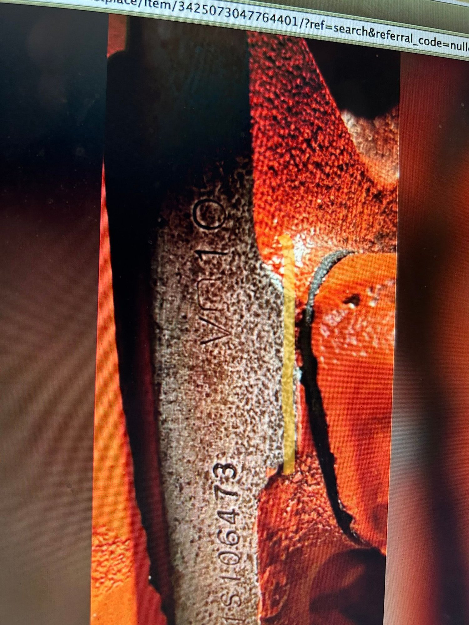

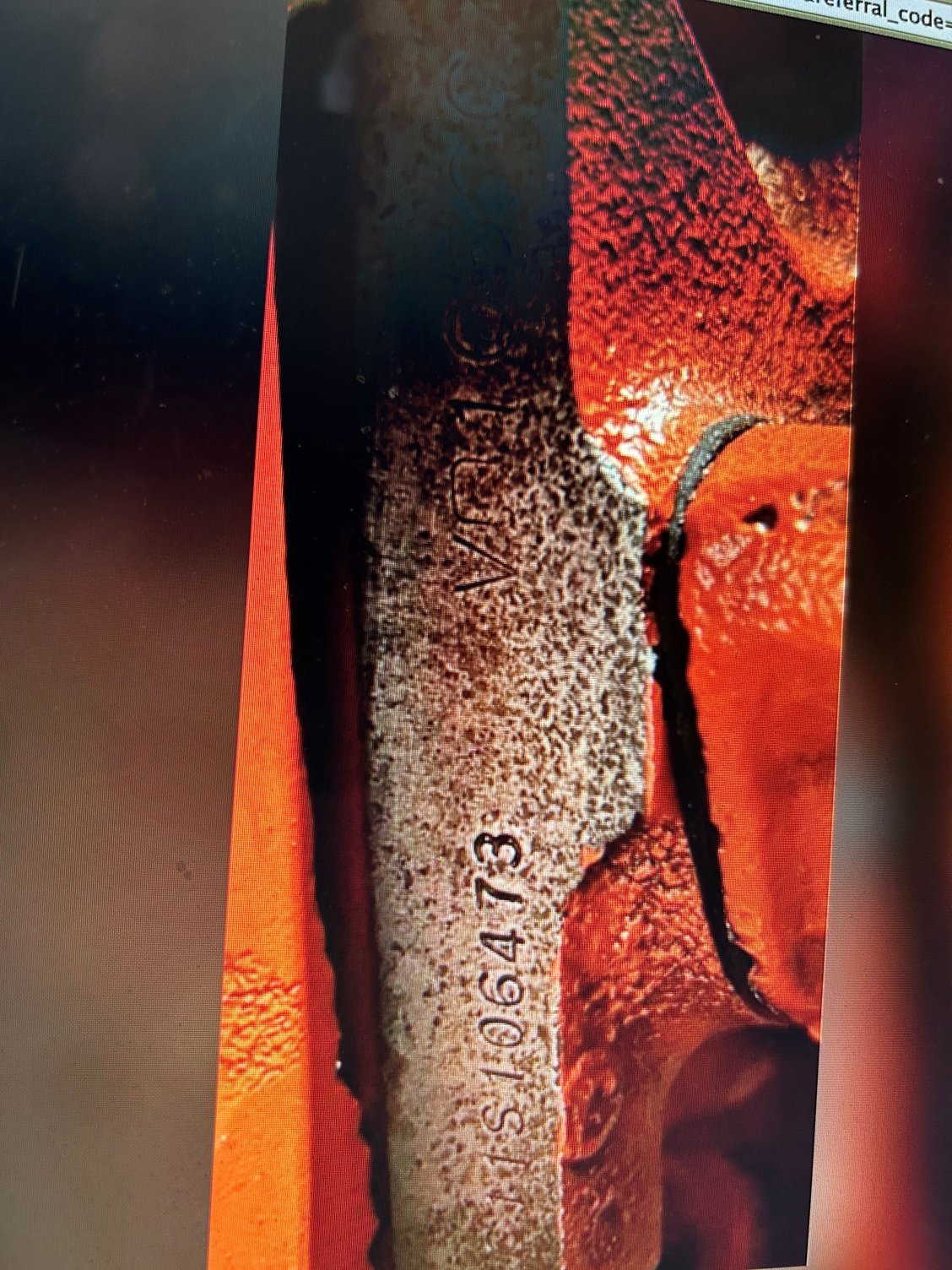

So I’m cruising Facebook market place and I come across this 71 lt1 for 82,000 and this stamp is very strange in my opinion although it’s claimed to be a top flight car I really think the peening on the pad gives it away and you can clearly see other numbers and or letters under the vin letters .. please any thoughts
don’t get me wrong this car is in outstanding condition and most everything is right car is in Wyane NJ on Facebook market place if people would like to view it I won’t upload the link

It just looks like pitted metal to me.

Shouldn't there be a way to confirm it is genuine?
AND not just a great job of acid etching?

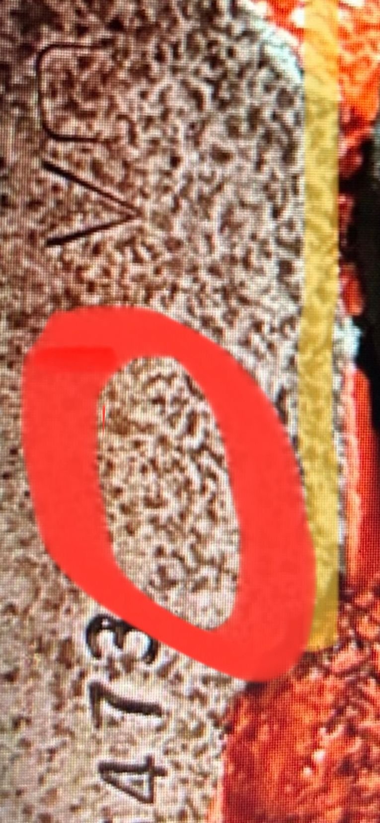

Is this not a 5 or am I just seeing things

looks like 2 sets of numbers?
top flight?
don't they check numbers?

It's like Bigfoot bro' ....I'm just not seeing it.

Does it have any other paper work to prove it's a LT-1. But I don't see anything bad on that pad beside bad rust

A Top Flight award does not mean original drivetrain. The engine pad is not very many points. They are more concerned that it’s a correct block, not original.

it is really hard to fake rust pits. my vote is correct stamping. but DON'T YOU DARE buy that car cuz i think the vin is ok...

I’ve always said that it is difficult to definitively confirm a stamp pad with a photograph (although you can rule one out). You really need to see a pad in person, under magnification.
Having said that (and if the dates on the Top Flight certificate are correct), I would have signed off on this pad as team leader and my judges would have had to OK it as well. This was done at a National event (as opposed to a Chapter or Regional) so the very best judges available to me would have looked at. Could we have made a mistake? Possibly. We always give the benefit of the doubt to the owner when judging, but I doubt there was an issue in this case.
I’d be willing to bet that this pad looks fine once you see it up close and not in a somewhat grainy photograph.
