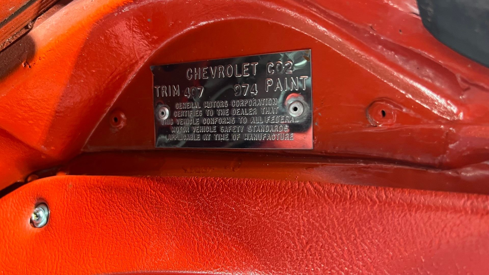

Can you post a picture of the trim tag?

Here is a pic of the trim tag.
The block is a 439 casting with a date of June 14 1968. I have pics of those casting numbers. I have a different pic of the stamp where you can see the X better but they really messed the pad up.

The trim tag is good but it has been removed in the past. ED, you are correct, when Billy Bob's had it for sale the pad had the LX stamp and broach marks. It appears someone tried to sand down the pad to pass it off as a 4 speed car IMO. Also, the cross member is welded and if I remember correctly in the old pics the car had the removeable crossmember which would be correct for an M40 car. Also, here is an LX stamp with a close build date to this car:

From the looks of the tag and the rivets, it appears the tag was removed at some point. A little strange considering you can see on the left side of it where it was tapped off when the car was painted. If ed427vette is right about the block casting date being June 14th, and the pad showing a September 9th assembly date, that leaves a pretty big gap between when the block was cast and when it was assembled. A 2 1/2 month gap is not impossible, but it's not what I usually consider to be typical. I know there were strike issues during the 69 model run, but I thought they all took place during the 69 calendar year, not in 68?
When you add the longer then normal gap between casting and assembly dates, to the botched up pad, the reattached trim tag and all on a red car, should that raise some concerns?
