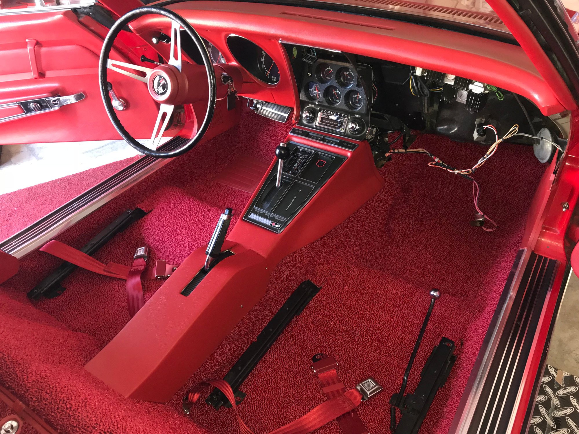

Per a suggestion from this forum, I chose not to use a drop of glue in my carpet install. I bought a carpet cutting scissors similar to the pair below, and used a few strategically placed pieces of velcro strips to secure the carpet. There are a sufficient number of interior trim pieces that will securely capture the carpet. I could have used a few more strips of velcro on the rear wheel well area but have been too lazy to install them.
Hope this helps.

Thanks Tom69 -looks great. Looks like you put the carpet in back to front ?

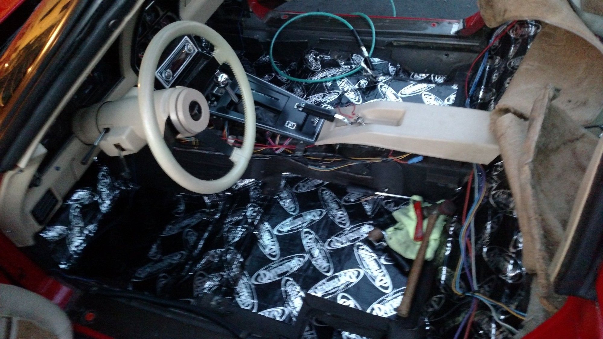

I used Dyna mat underneath the carpet sound deadening and it makes a big difference

Good to hear -I did the same. Hopefully it will be a bit quieter..
