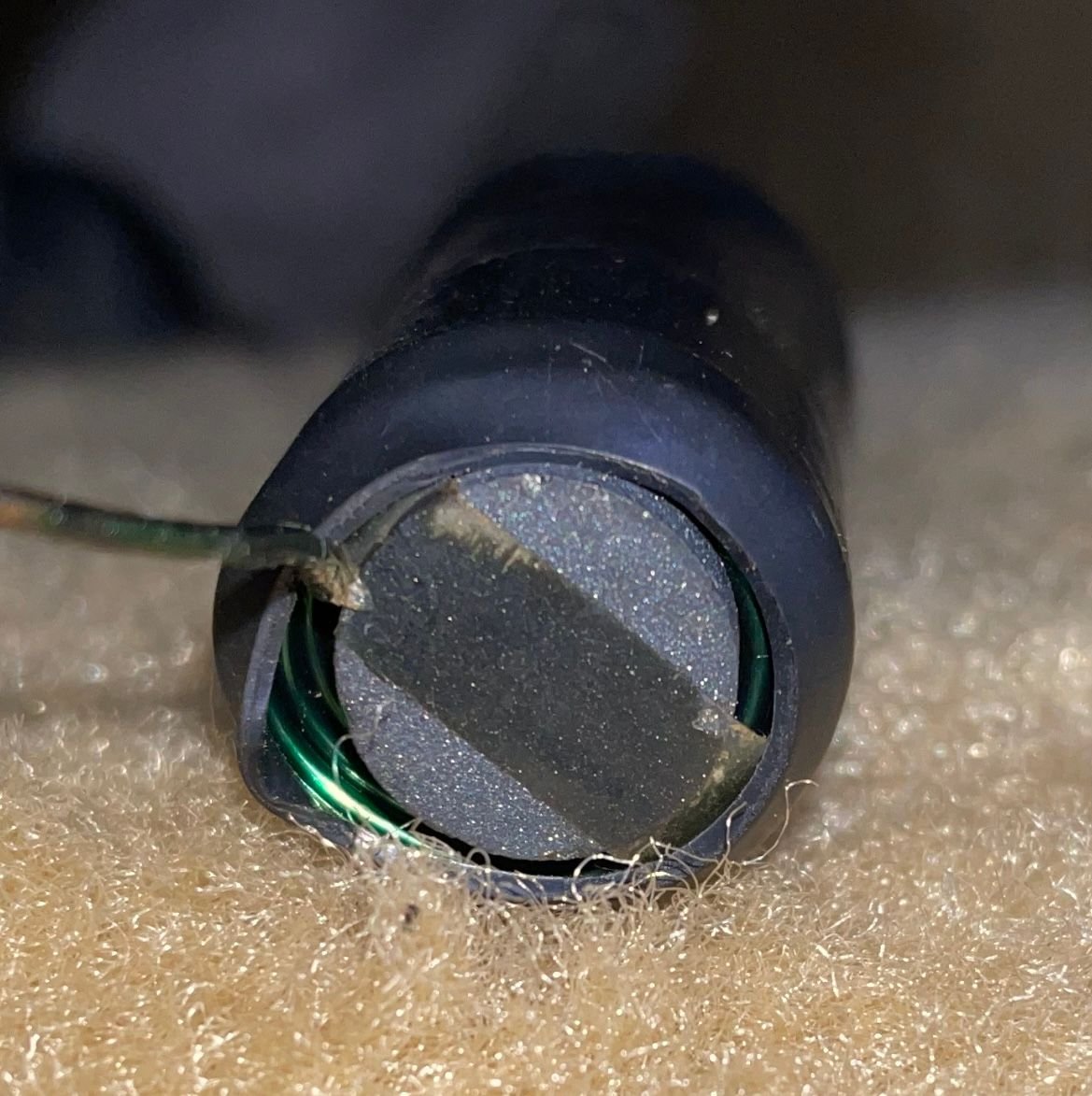

Found this while cleaning up my console wires. Top part connected to the yellow power wire for the radio, and bottom was attached to the positive end of a combined positive and negative wire that spanned maybe 4ft but was hooked up to nothing. Thinking it’s a capacitor for radio noise
suppression but not sure. Also, not sure what the other end went to and why it’s not hooked up. Rear speakers maybe?

I’ve followed the wire and it leads to nothing plugged up on the bottom end and up on the top end it just intersects the yellow power wire for the radio.
It’s wire wrapped around a weird stone type material so I don’t think it’s a battery, but maybe I don’t know for sure. The cars had 12 owners, so bound to have some crazy stuff.

I believe it's a noise filter for the radio.....

yep - a coil to clean up the "alternator whine" in the sound system

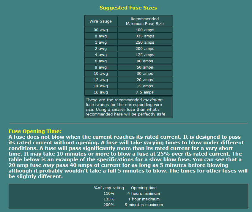

You'd be better off tossing it. Run the power and ground directly to the battery - fusing as close to the battery as possible- and size of fuse picked on the size/gauge of wire used. See chart
A much better way of solving the noise issue

Yup that’s a choke or inductor, the current stabilizing brother of the capacitor.
It’s useless junk for this attempt at an application. Probably making RF interference worse for the radio.
