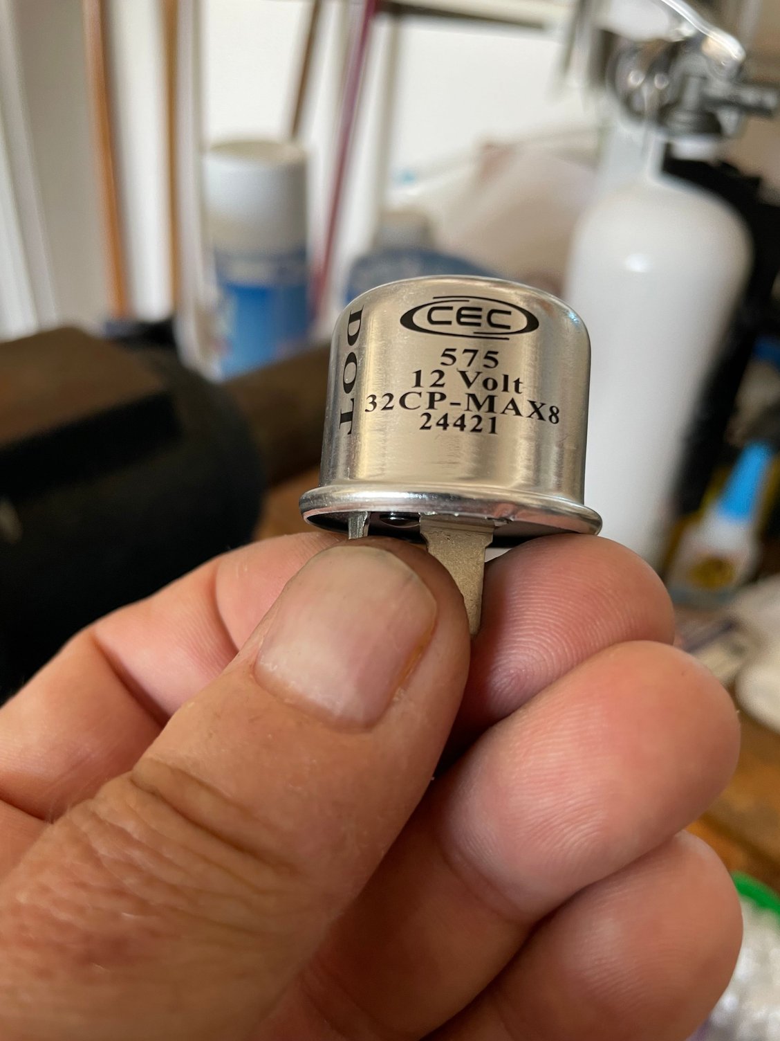

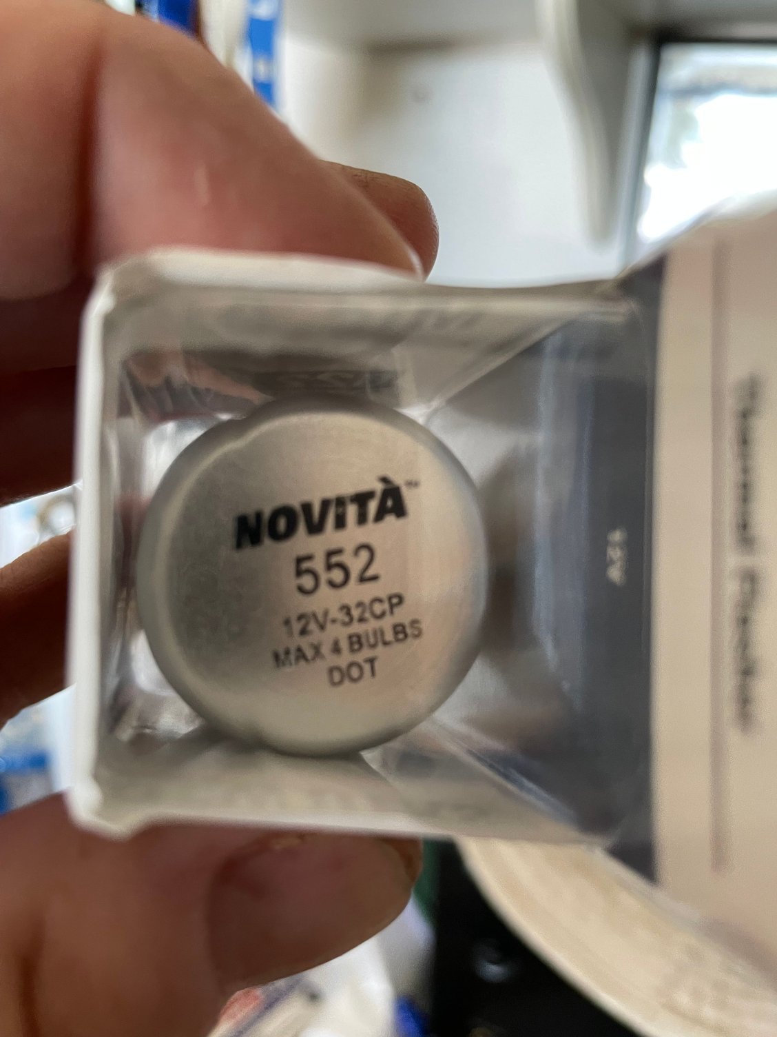

Guys all electrical systems and lights work on my 1969 coupe but NOT my hazards flashers. My turn signals works as advertised but when I activate the hazards flashers with the switch nothing happens! I purchased a fuse kit from Mid America, it came with the old glass fuses and 2 round canister fuses. I checked my fuse box to see if it had any round fuses like the ones in pictures I attached. Nope!! I checked the vehicle owners manual for locating this fuse and also checked my GM service manual but that don't show me anything either. Can one of my forum members provide me with intel on these 2 fuses I have attached and were I would locate my hazard lights fuse? Do these 2 round cani
ster even go with my year vette? I have attached the fuse and identification info and blade contacts to help with Identification.

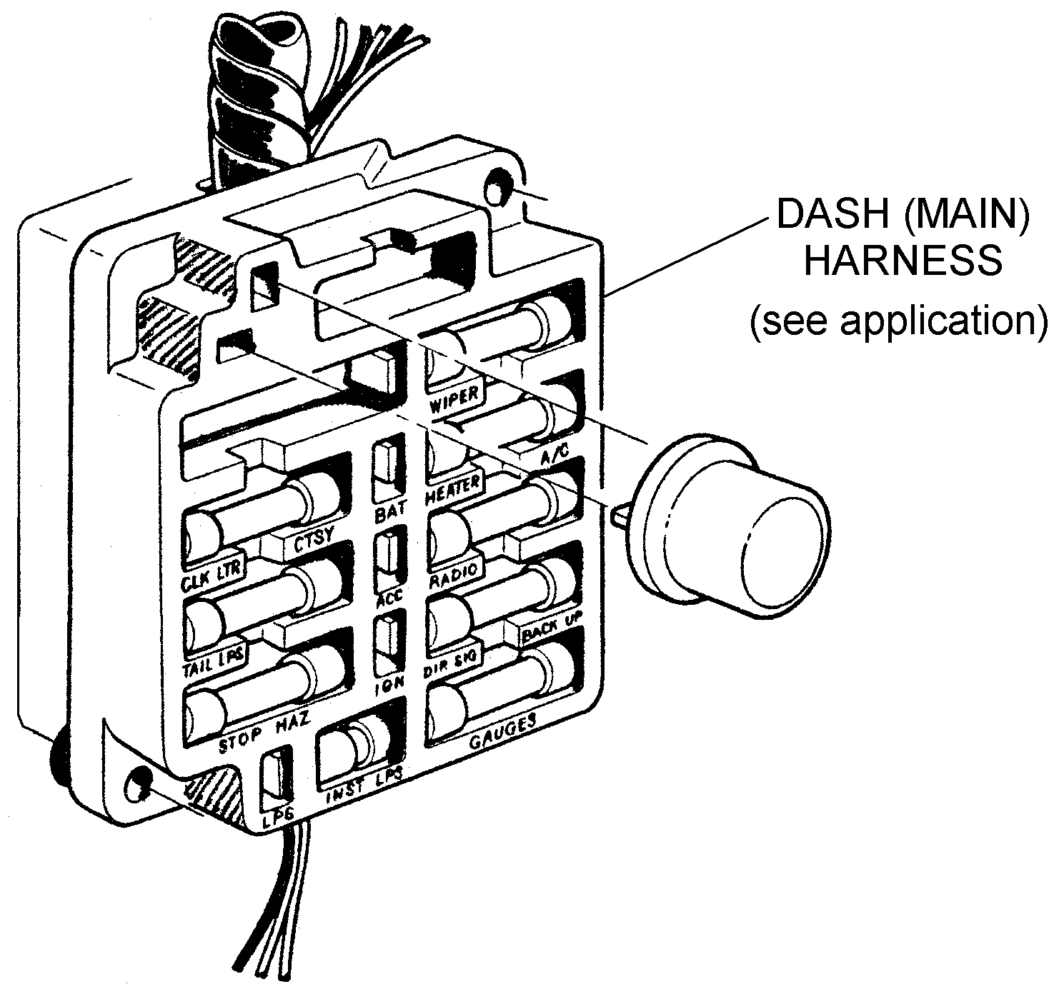

The hazard flasher is usually on the fuse block

Thanks for your reply, which one of the hazard round fuses that I posted would be the correct one to install. Don't know why they included 2 in my kit! I thought one would be the tun signals and the other hazards lights.

I think either would work in either spot. I can't tell what the blades look like on the 552, should be same as the 557, which is correct. One for your left/right signals that is behind the passenger lower dash pad and the other for the hazard lights that fits into the main fuse block as in bruiser's post. One of your canister fuses is for 4 bulbs the other rated for 8. Perhaps the 8 bulb one for the hazard might be best.
There is actually three of the canister type for your 69. There is also one for the alarm system that is located in the car jack storage bin beside the alarm relay.

Thanks for your guidance, installed the 557 canister 8 bulb fuse, my hazards flashers are operational now!! Thanks again for Bruiser and your input helping me solve this light issue. Now off to knit picking my doors closing/alignment. I hate that I have to roll windows down and slam my doors to close!
