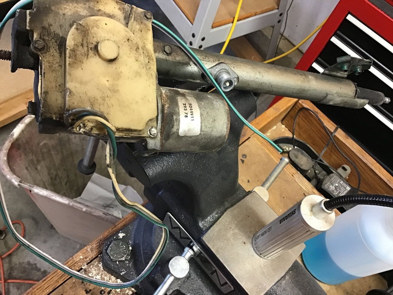

my 79 has a 78 antenna in it..early build.. the part #'s on mine.. maybe made in 1985 is the ebay one and mine says 78?
https://www.corvetteforum.com/forums...na-wiring.html

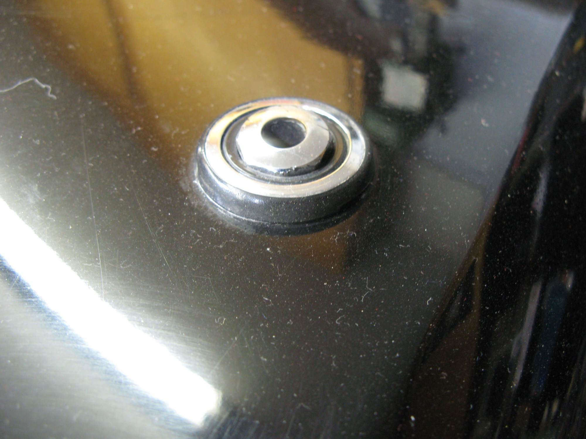

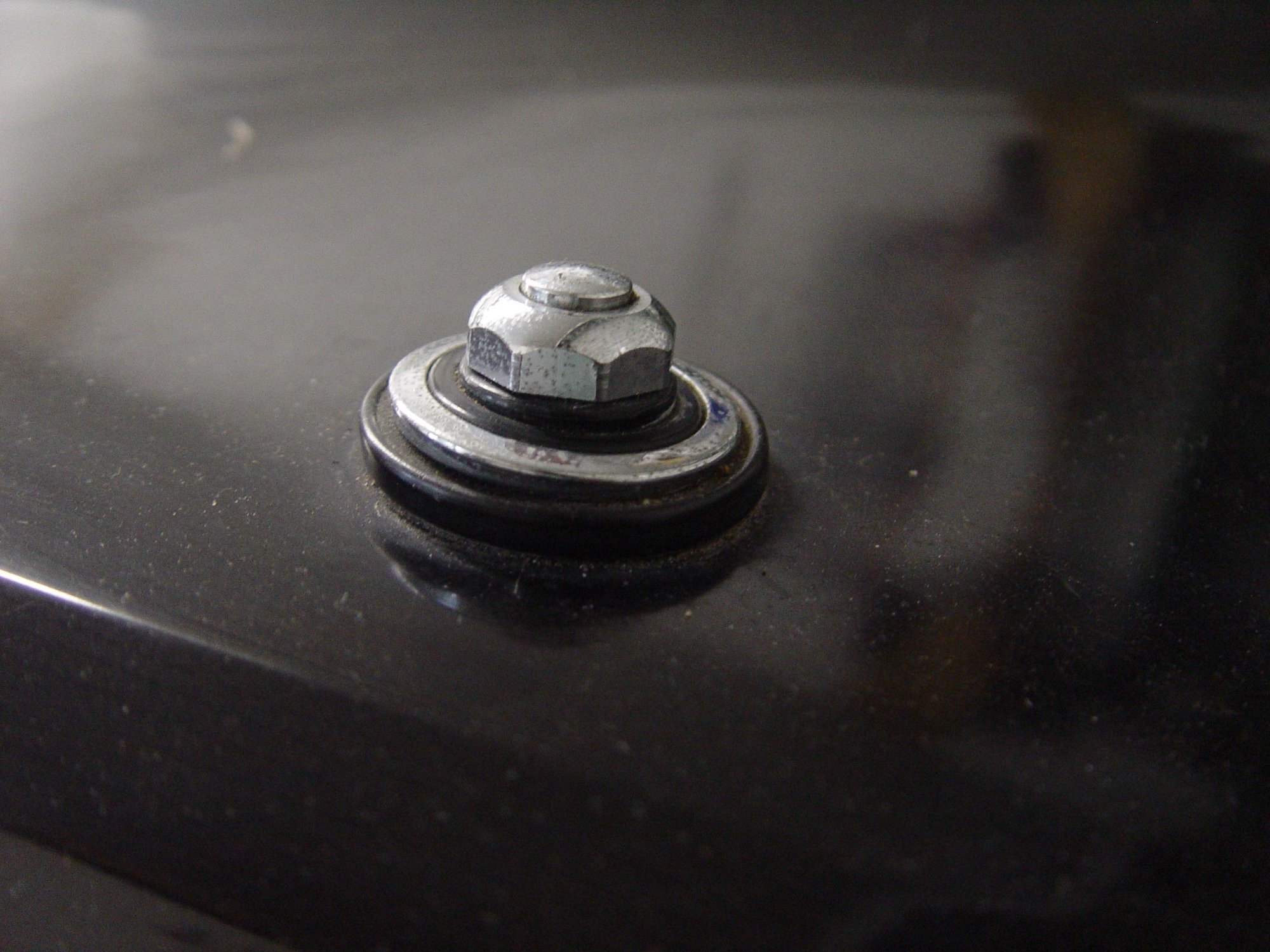

Originally Posted by gbvette62
The GM service replacement was based on the 79-82 antenna that took the threaded antenna nut. The raised nut you referred to was a universal piece that came with the antenna, but the thin, flat chrome nut with 4 spanner type notches in it, that the factory 79-92 Corvette power antennas used, worked with the service replacement antenna. I know people tried using the black plastic 78 bezel with the service antenna, but I think the problem was that it didn't hold the mast tube securely. The 79-82 nut looks much better then that taller chrome nut that came with the service antenna.
Photos?
Here are a few I have seen and noted...

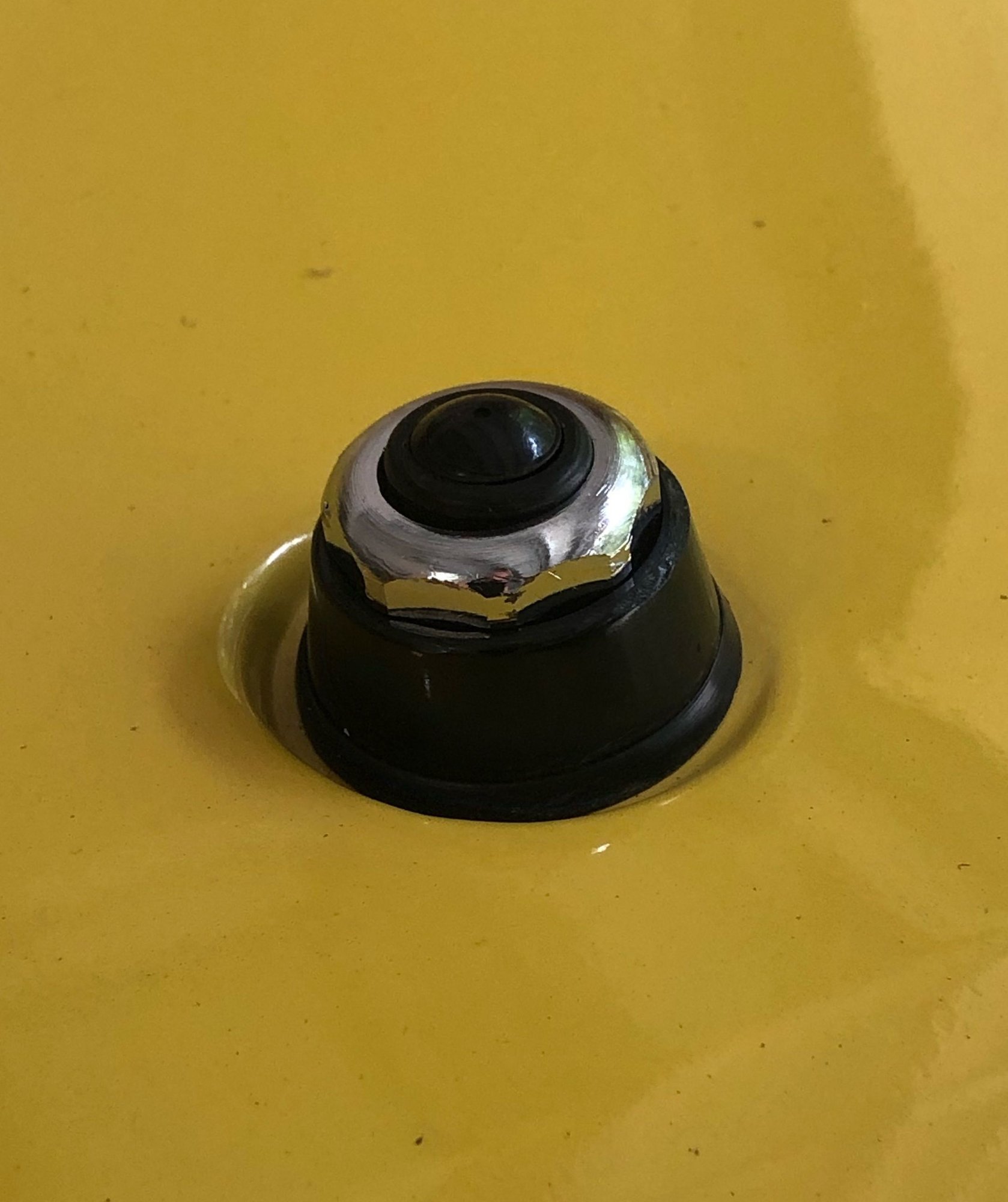

Here is what's been on my 78 PC and still on it. Never has worked in the 20 years I've owned it but haven't ever looked into why. Assumed all along is dead and mast appears to be missing. Hence, the replacement I bought years back.
78 PC
And the repo I bought.
Repo 78-82
Mast end on repo.
Repo mast nut

Originally Posted by hunt4cleanair
Photos?
The top one is the standard fixed mast antenna that came on all 69-82 Corvettes. The angle of the bezel was different on the version that came on 78-82's, but the large nut, small nut, gasket & mast were the same, and the bezel was very similar except for the angle it was cast in. The three power antennas pictured are all aftermarket antennas, and not GM service replacement ones.
The Delco service replacement antenna came with a plain round chrome bezel that had a slight tapper to the sides of it, a black plastic sleeve inside of it, and was maybe a 1/4" tall. The lower portion of it was threaded to screw into the mast tube, but the outside of the bezel was smooth making it difficult to get it screwed into the tube any more then finger tight. The GM/Delco masts came with the same diamond shape tip on the mast as the original factory installed mast. None of those antennas have the diamond shape tip.
I'll have to look around and see if I still have any of the bezel/nuts that came with the GM service replacement antennas. We use to pull them out of the antennas before selling them, and replace them with the correct, low one with the spanner notches (see the bezel/nut in RickM Z06's last picture). I know I still have some of the relays and wire harnesses that came with them.
78 PC
Repo 78-82
Mast end on repo.
Repo mast nut
That antenna and the box it came in, looks like the repro made by K & B. The bezel with the four spanner notches is what came on 79-82 Corvette power antennas. The 78/first design 79 antennas came with a plain black plastic bezel that snapped into the mast tube, instead of screwing in like yours. The black rubber cap on the end is just there to protect the mast and tip. If you pop it off you'll see the diamond shaped antenna tip.

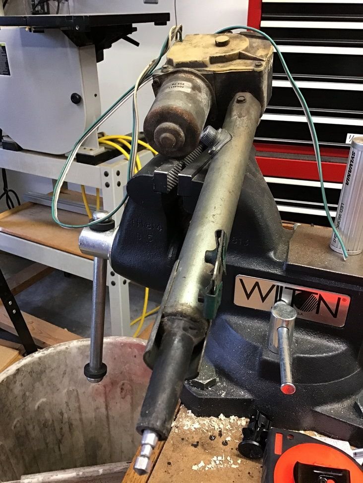

Old Oct 24, 2023 | 12:36 AM
RickM Z06's Avatar
RickM Z06
Joined: Apr 2014
Posts: 877
Likes: 702
From: Oregon

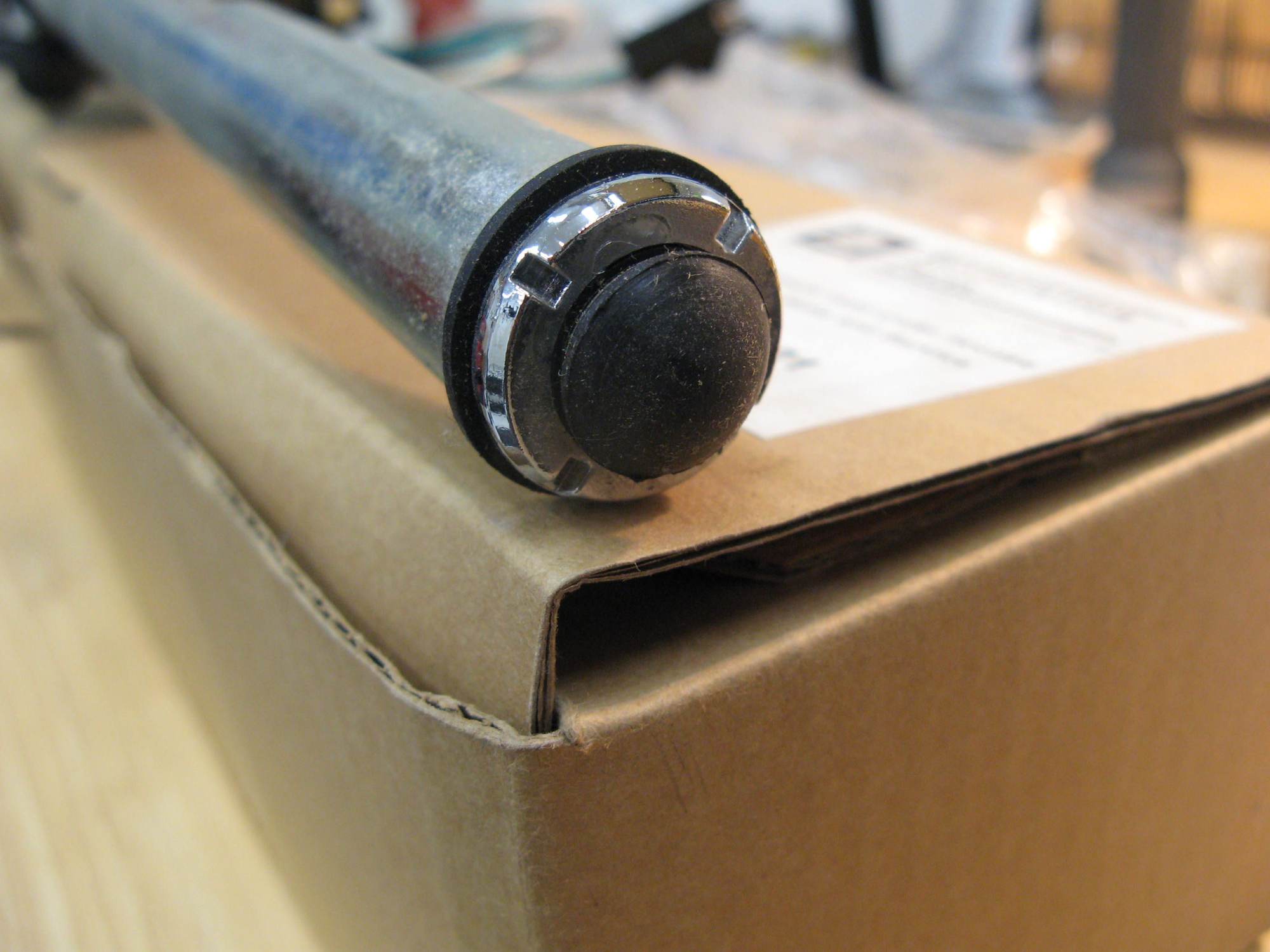

That antenna and the box it came in, looks like the repro made by K & B. The bezel with the four spanner notches is what came on 79-82 Corvette power antennas. The 78/first design 79 antennas came with a plain black plastic bezel that snapped into the mast tube, instead of screwing in like yours. The black rubber cap on the end is just there to protect the mast and tip. If you pop it off you'll see the diamond shaped antenna tip.[/QUOTE]
Pulled out the old broken antenna assembly but haven't looked it over much. The small instruction sheet that came with the one I'm putting in mentioned keeping the rubber tip on it. Perhaps to help keep water out of the mast?
The antenna mast end is indeed diamond shaped.
