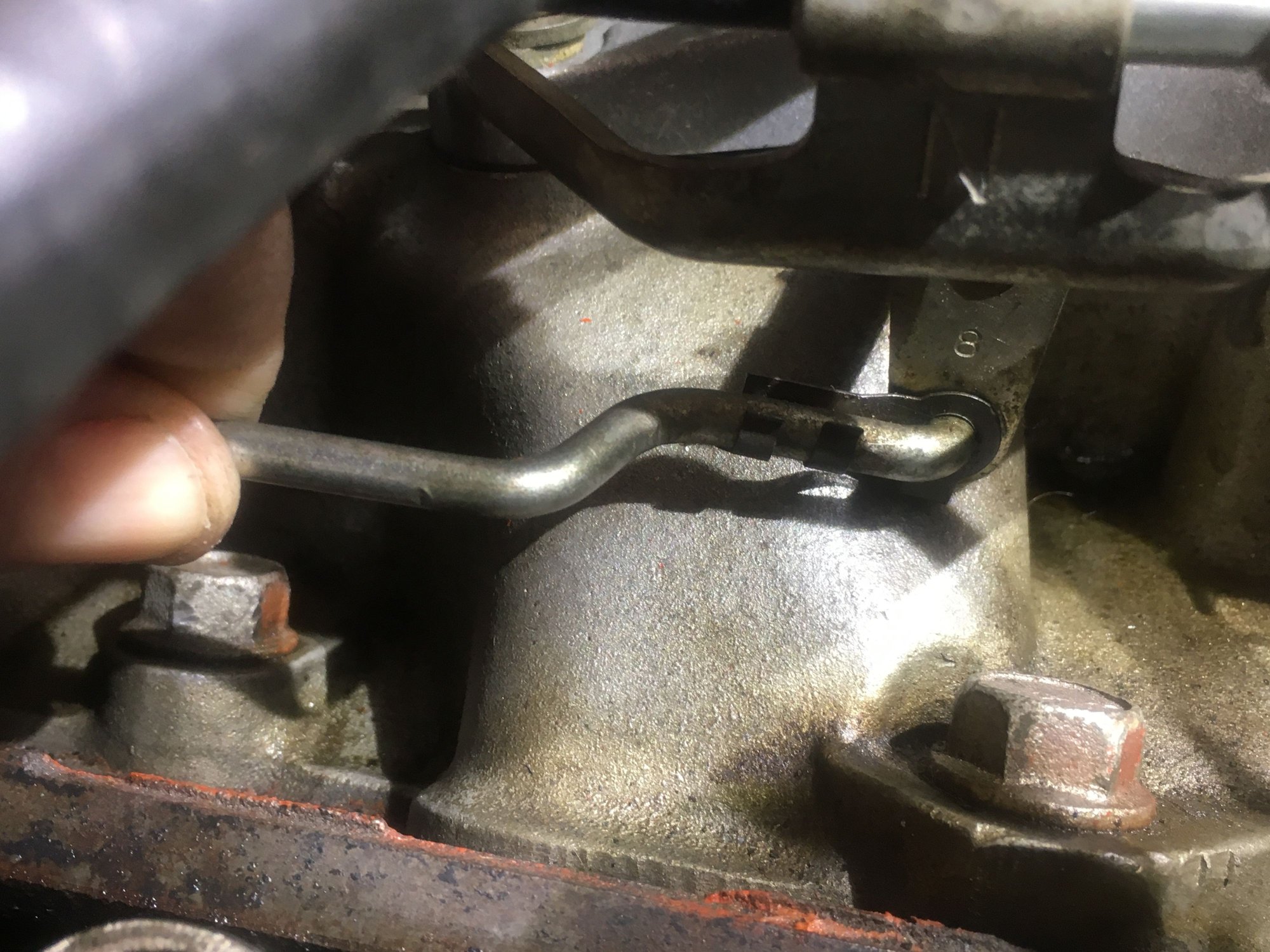

My first tri-power, first 427, and first Corvette…..

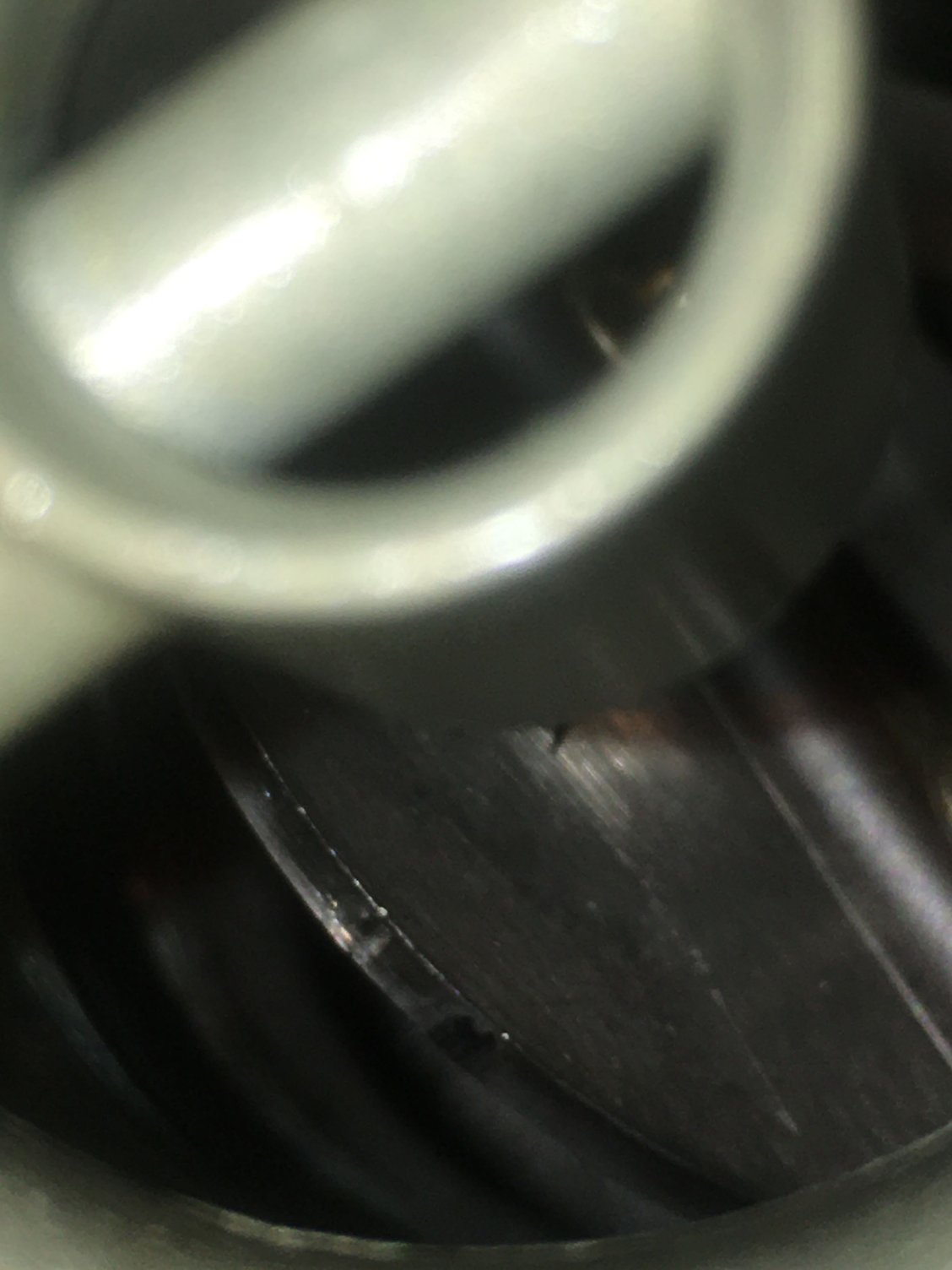

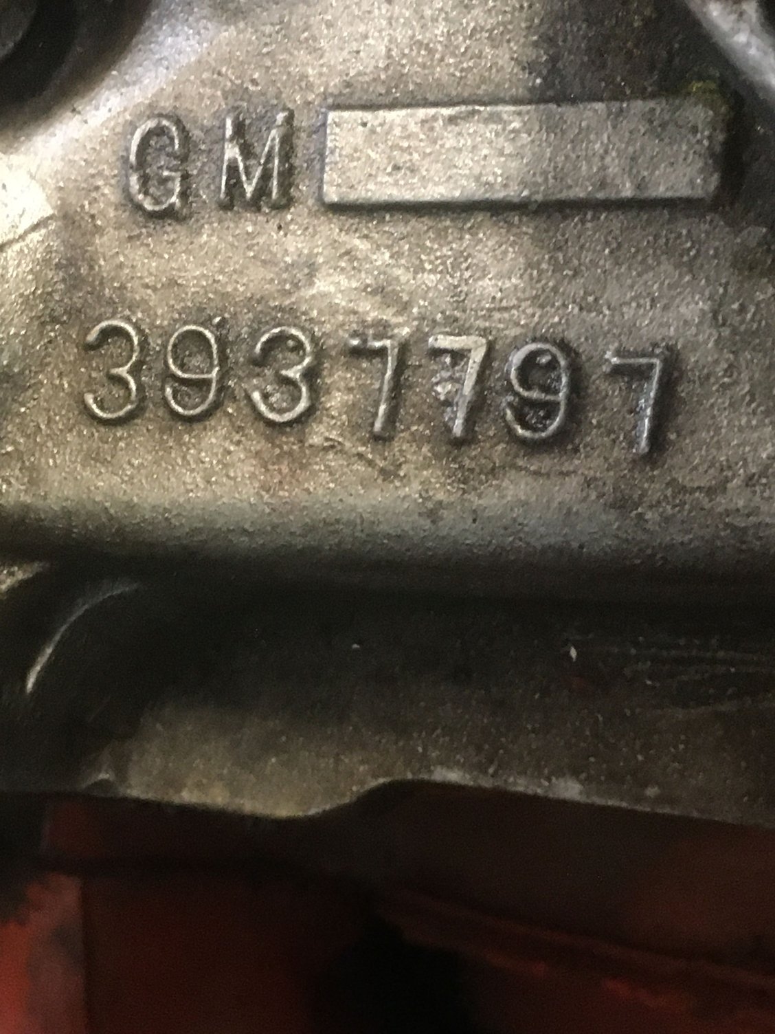

rear carb link is hitting the intake manifold restricting both carbs to less than 50% open. Seems all the key parts are correct. Need help on what to look for.
Carb numbers
Intake manifold

Butterfly limit from restriction
Linkage/manifold restrictio

can you post some pics that arent close ups please. my 68 doesnt come close . I also run some spacers. A minimum of a 1/4" usually to help with heat issues.

even without the spacer it shouldnt be that close...maybe its a ford or a mopar base. I couldnt find the baseplate number online to see

i bleieve your clip is on upside done so that may be the front clip. They should push down. Pull the clip off and see if the linkage hits

The original clips cross bar goes out the back on the rear and way out th e front on the front. They are odd shaped compared to the generic choices ones that are sold. you will have to hunt for them. I will look and see if I can find them,. I did once Hughs thread had a link I think as well
rear clip
front clip

Never in a month of Wednesdays would i have found that. Too the clip off and very slightly bent the carb linkage away from the manifold and it clears. I will have to consider your double spring advice after the 50+ horsepower increase at full throttle. These carbs were rebuilt by PO maybe 10+ years ago and they must have selected those generic clips.
Your manifold must be a different number than mine, your carbs sit much higher.
