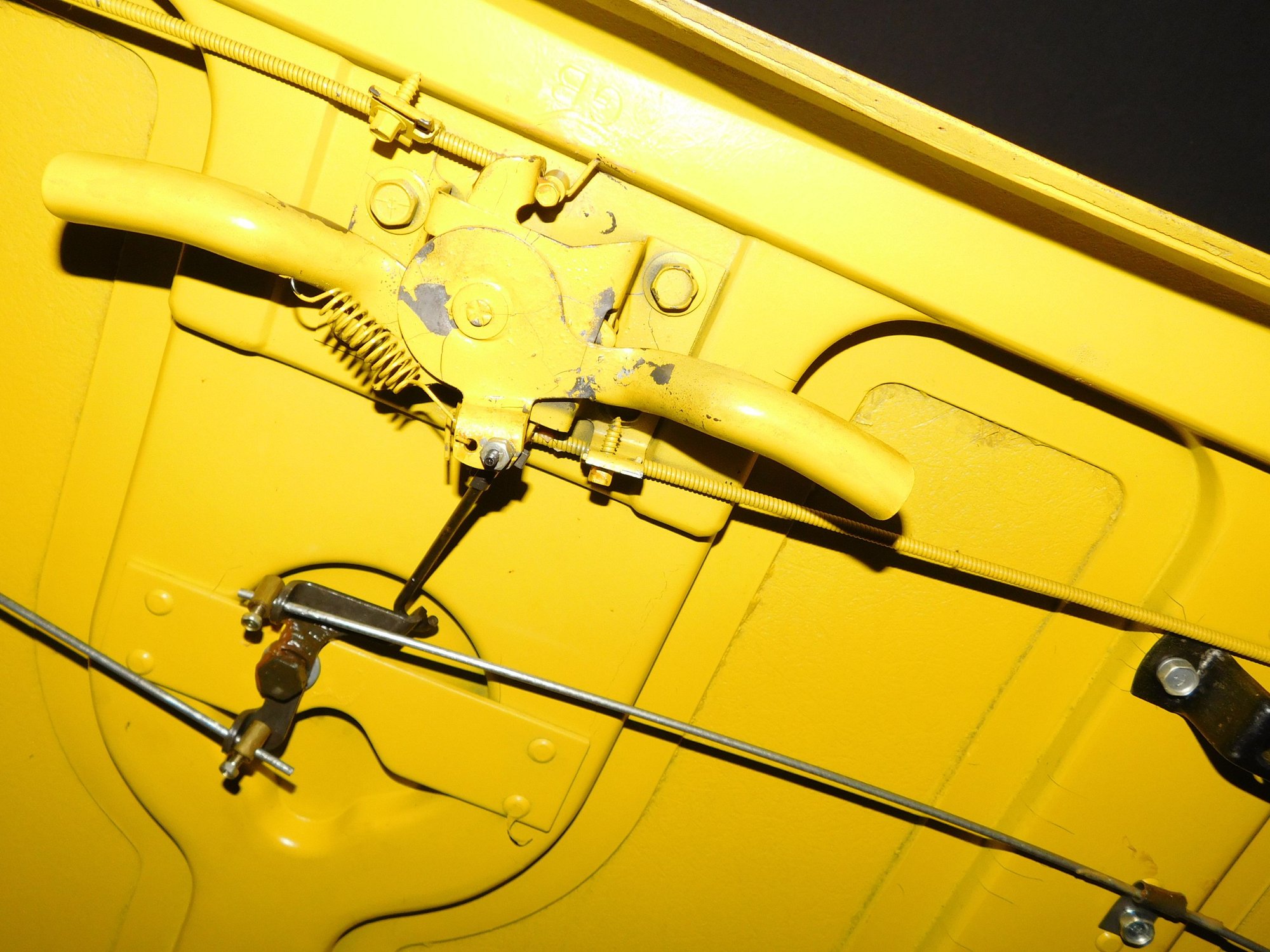

I took these pictures to show factory paint areas from an unmolested survivor, but they may help.

This helps tremendously. Thank you!
I installed the clip and it helped. I think it’s also important to have all the rods connected because they apply the required pressure for the mechanism to function.
