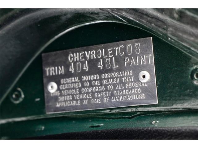

I'm looking at a 74 Corvette with this trim tag, it appears to be black by the number (which the car is) but I don't see black as an available color in 1974?

Is the interior black leather? You’re right, I don’t see black listed as an exterior color, plus the trim tag has an interior code for the exterior paint.
What is the VIN sequence? Is the build date month C or G?
Did Chevy change the stamping font? The “4” on my ‘69 trim tag looks totally different than this one. I don’t know how ‘74 tags are supposed to look, but there is definitely a mistake on this one, with the exterior code.

reminds me of default paint when a certain package was ordered.
A good thing if I remember?

The font of the number '4' being open at the top was correct for '74, but as pointed out the 404 is an anterior trim number, not paint. Paint codes were either a 2 digit code or a 3 digit code beginning with a 9.
It's possible it was special order paint and they used the code for the black interior to note black paint, but in cases of special order paint they usually had "SPEC" or "SPECIAL" stamped in the paint code area.

yep, that's what i don't understand, strange number that i can't figure out, did they paint cars colors that weren't available supposedly and why would the number for the color be a interior trim number,

If you can remove the 4 screws from the rocker sill, then pull the carpet back a bit, you will be able to see the original color on the fiberglass floor. There is much overspray there.

Here's another tag from a '74. Could be repops, but I've seen a few 73-4's with this font. ??

That looks like a real tag. All the lettering in the text is correct and not like the repros. The repros have a very specific mistake that they have yet to correct and easy to pick out. However, it may NOT be correct for that car, possibly switched from another year but I don’t know codes from anything past the chrome bumpers.

I don't have the ID number, i lean toward Eds idea of a switched id tag but can't figure out the 2nd number as a paint code.

Chevy must have changed its stamping machine for the date and interior/exterior. My ‘69 was built in a C month, and its code is C04; not only do the 4s look different, but the date font is different too, ie the C and the 0.
The trim tag OP posted does look like a factory correct trim tag.
I recognize that none of this answers OP’s question, of why the trim tag has an interior color code where the exterior code should be, or why the car is black (assuming it’s original paint) when black wasn’t offered. Regardless of whether the exterior color is original or not, there isn’t any exterior color code in that spot. Interesting mystery!
My guess is that we’ve all spent more time thinking about this than the guy who stamped it a half century ago did!

My money is on a factory mistake with this tag.
It is unfathomable that someone would be smart enough to make a fake tag, but then stamp completely wrong numbers like this on it.
If the car has not been through 20 different owners, this would be an interesting one to track history. Perhaps a tank sticker?

It's an original tag. Do you have any other details on the car such as factory docs or history?
