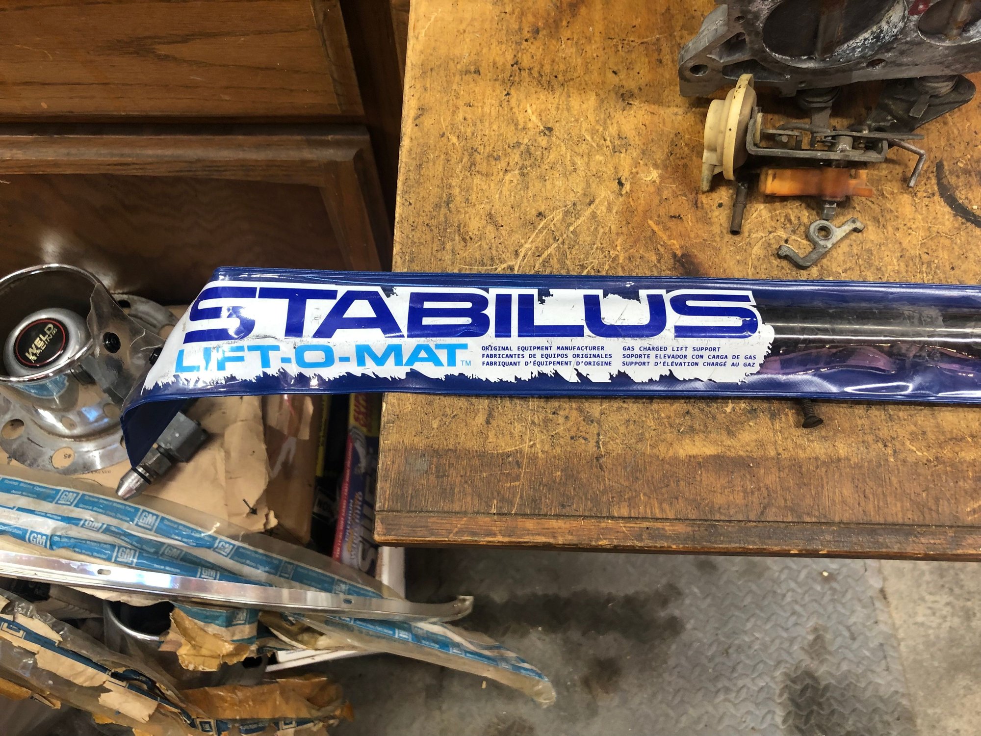

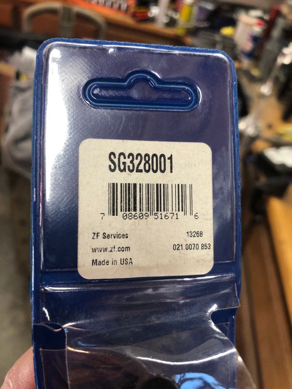

Default Gas strut
Matt, check your PM I sent pics with part numbers to make... really simple.
There are 2 that work well for this application. This is the stiffer of the 2. Available from O'Reilys 17" I believe. The lighter strut might be easier on the hood
as this one is perfect after being installed for 5 years. Only the second one after 15 years.
