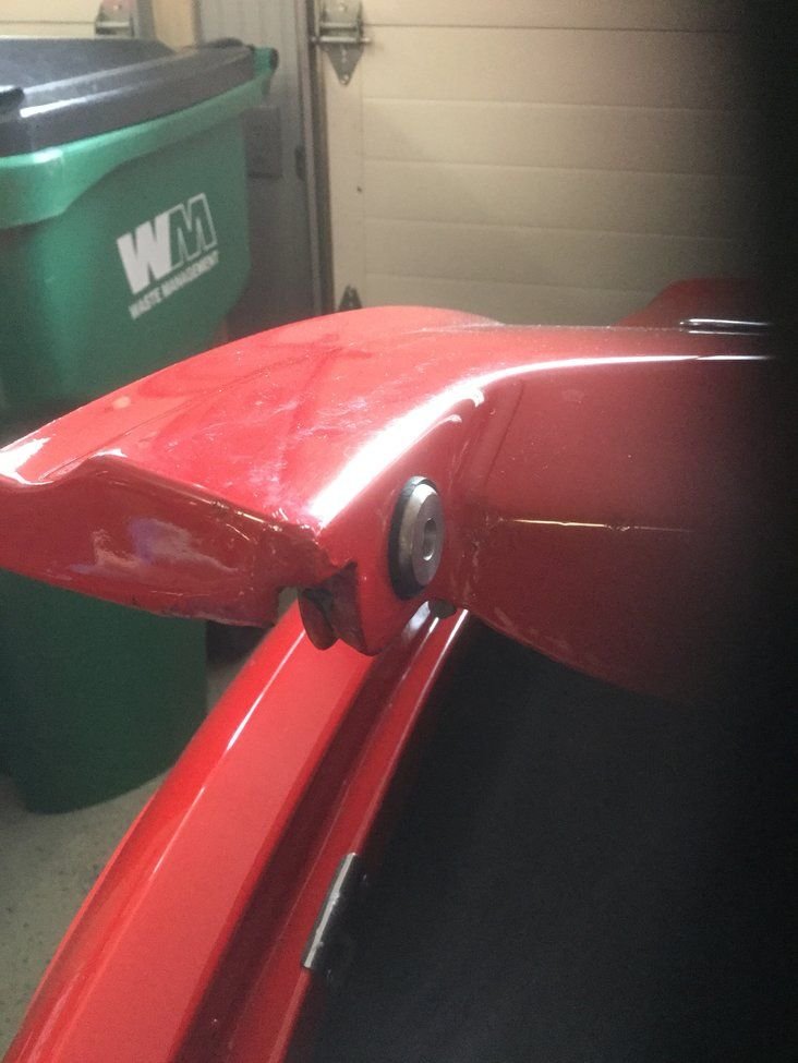

Good to hear...did you say that you also have the side bolts? I always snug them up after I tighten the rear bolts.
