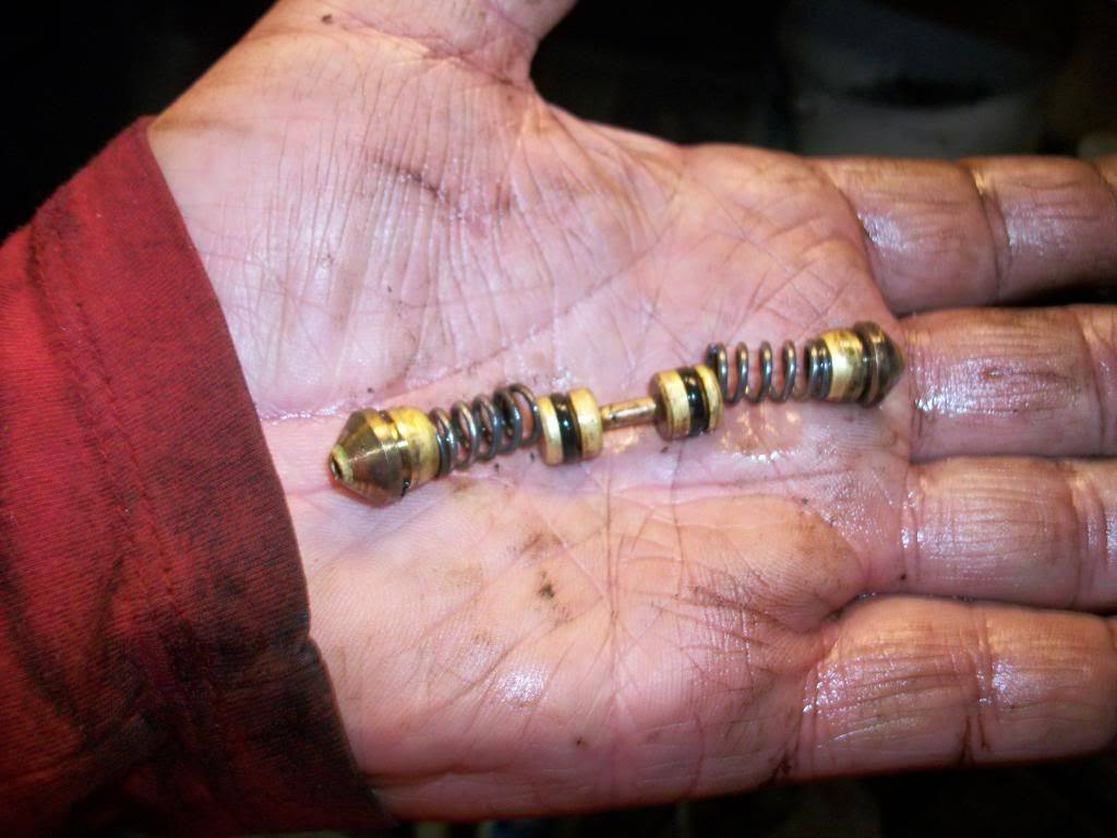

My valve was stuck/gummed up so I had only front brakes...I had to dissassemble and clean and recenter it.
This is the switch that turns on the dash warning light when the brake system is failing
The small piston in the middle with 2 o-rings on it is the centering valve that gets pushed to one end of the valve body(block) when the brakes fail...it is the part that needs re-centering.
Like I said...I am not sure if your '78 has the same style valve.
