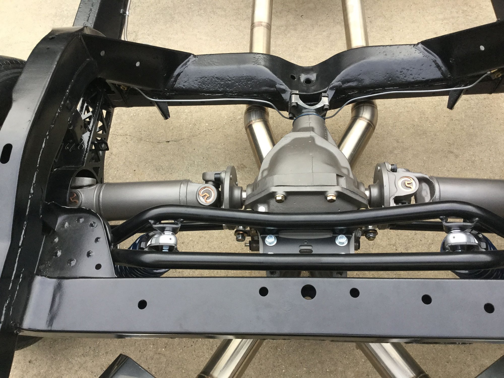

I installed the Van Steel kit on my ‘71 and it fit perfectly. Dan (owner) is incredibly responsive for questions and support in addition to very clear instructions. I picked them over Ridetech because the coil overs mount in the factory upper shock support (with included strengthening bracket) which positions the springs vertically.
as you can see from the picture, the T-arms are offset inward to allow for wider rear tires.
I also installed their Smart Strut kit which enables positioning the adjustable struts for the particular way the car will be driven.
