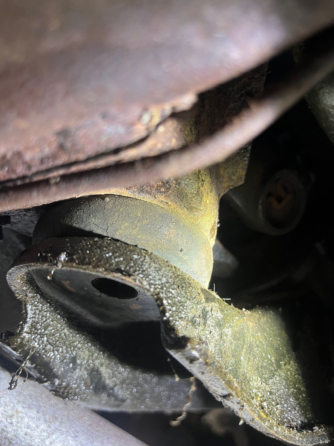

Just got the old one out but there’s no way I can pry the tongue down enough to get the new one in by myself. Does removing the tongue make it harder to get back together? Also noticed my rear brake line is leaking-fortunately Ecklers has the rear crossover in stainless for $25.

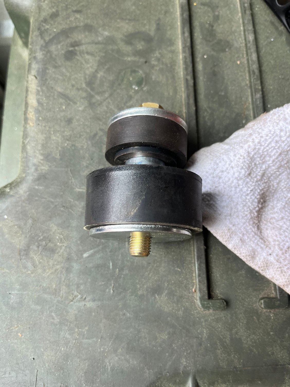

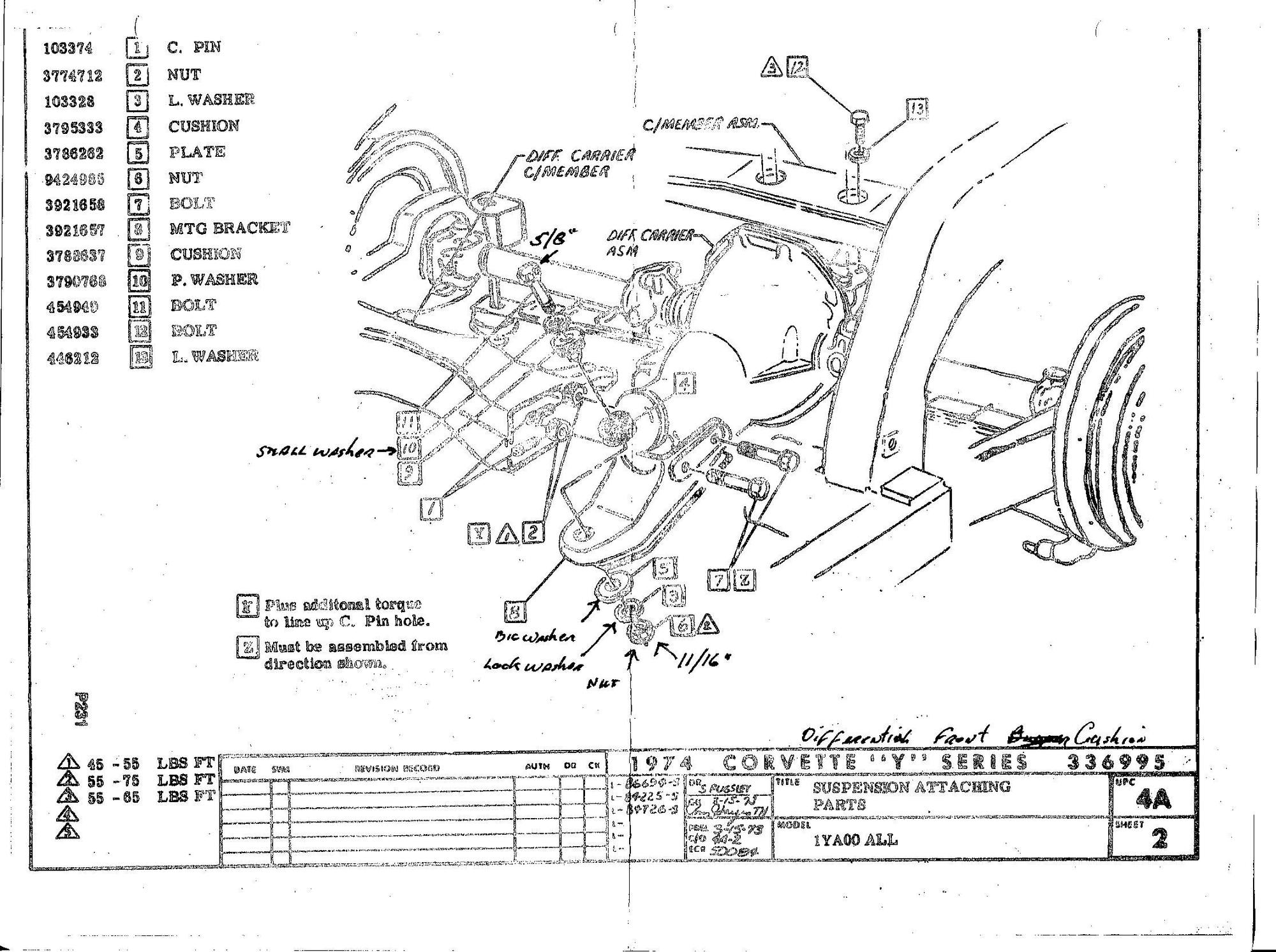

Is this the correct order besides the lock washer which fell on top somewhere?

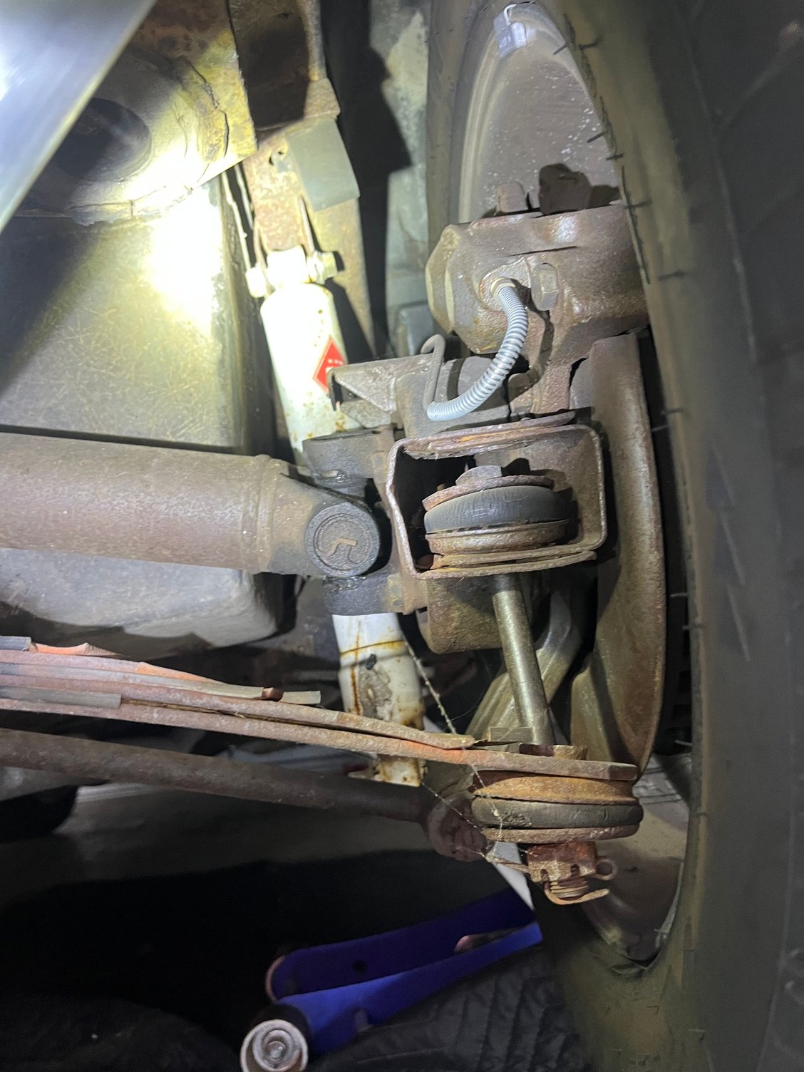

Long bar under the rear sticking out towards the rear of the car and forward enough to get a strap around the nose of the bracket, pry up on the rear to force the nose down enough to sneak the bushing into place between the nose and the frame
Order of parts from the top down
Bolt goes in from the top
small plain washer
smaller cushion
Frame bracket
larger cushion
differential bracket
large plain washer (plate)
lock washer
Nut
M

Still cannot for the life of me get the tongue down enough to get the new bushing in place. There’s no way in hell one person can get it opened enough for the new bushing to fit in by themself.

What happens if you loosen the rear bolt #7 and remove the front #7?
Would I be able to get the bolt back in?

You can do it..you need to pry and fulcrum right where the brake line is..i moved the line slightly and pried.

had the rear on jackstands and tried putting the floor jack right under the diff.

I put the bar under the differential sticking out the front so it's under the nose bracket resting it under the spring and sticking out the rear. Wrap a strap (chain, rope, whatever) around the nose bracket and bar making sure it's not in the way of where the cushion goes. Then lift up on the other end of the bar and it basically pivots on the spring forcing the nose down enough to slip the cushion into place.
If the spare tub is in the way just put a chunk of 2x4 under the spring area and that will bring the bar down low enough to clear
If you're working by yourself (which I normally am) a floor jack under the end of the bar works easy. Doesn't take much effort depending on how long the bar is and you just want it enough to put the cushion in otherwise it'll start trying to lift the car if you try to open it up a lot
