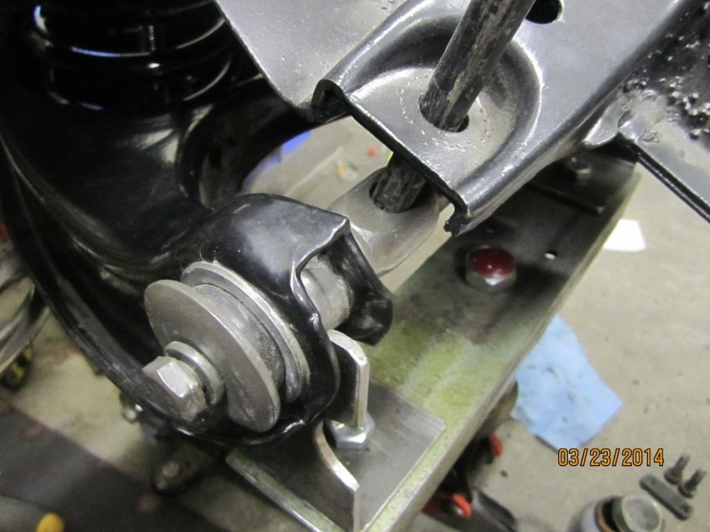

Hi everyone
I'm re-installing the (front) lower control arms.
There are two smaller bolts in the front and one larger bolt in the rear that hold the control arm against the chassis.
The one larger bolt slides in from the top to bottom and has one 'special' serrated washer between the bolt head and the chassis.
Which side do the teeth go? Against the chassis or against the bottom of the bolt head?
Option A
Option B

Teeth bite into the frame, you can see the marks here

Thank you very very much!
The bolts are installed and tightened.
