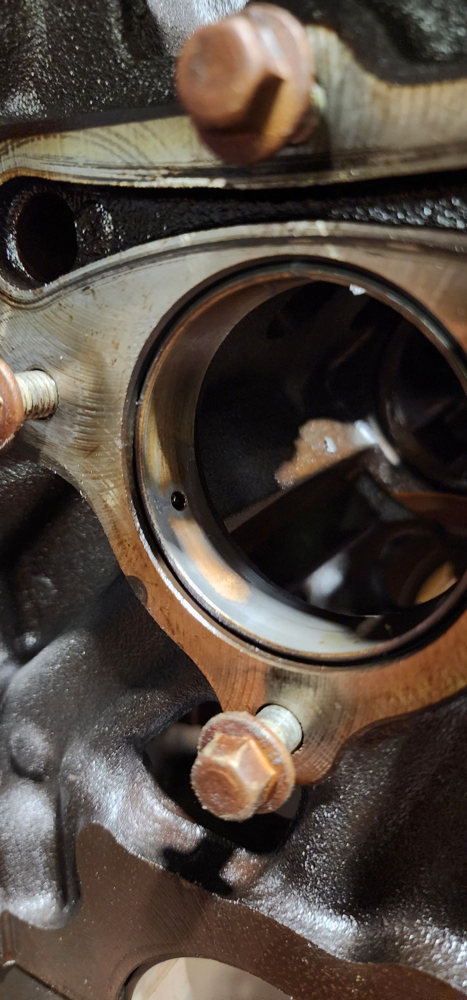

Engine has 250,000KMs. After an hr of running the temp started to climb, and i found out why it was at the scrap yard.
Blown head gaskets. easy fix, but for another day. Next is cut open the oil filter and drain the oil. If thats all good, then im cutting the cab off and pulling the engine/trans and all wiring.

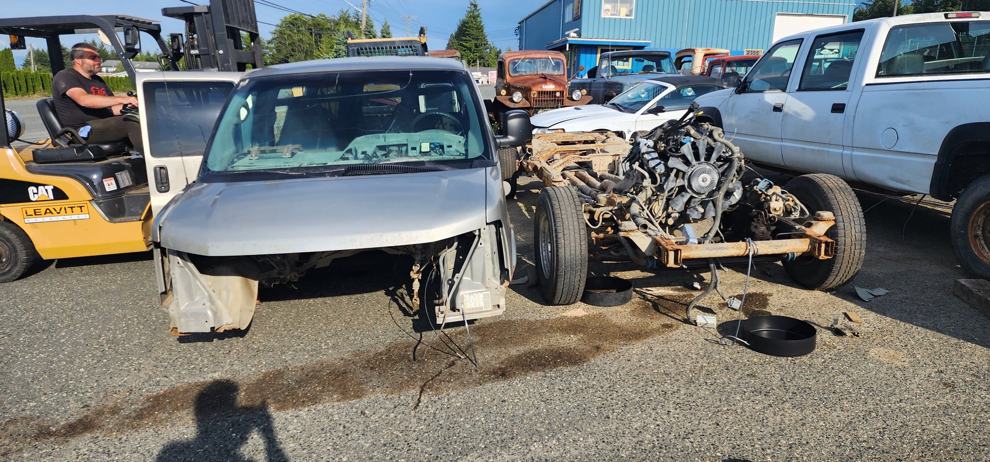

Pulled the cab off, took everything I needed. Bought the van for a bottle of rum. Sold the bumper for 50$. 😂
Engine is apart, slight scuffs in crank bearings so I decided to rebuild it.

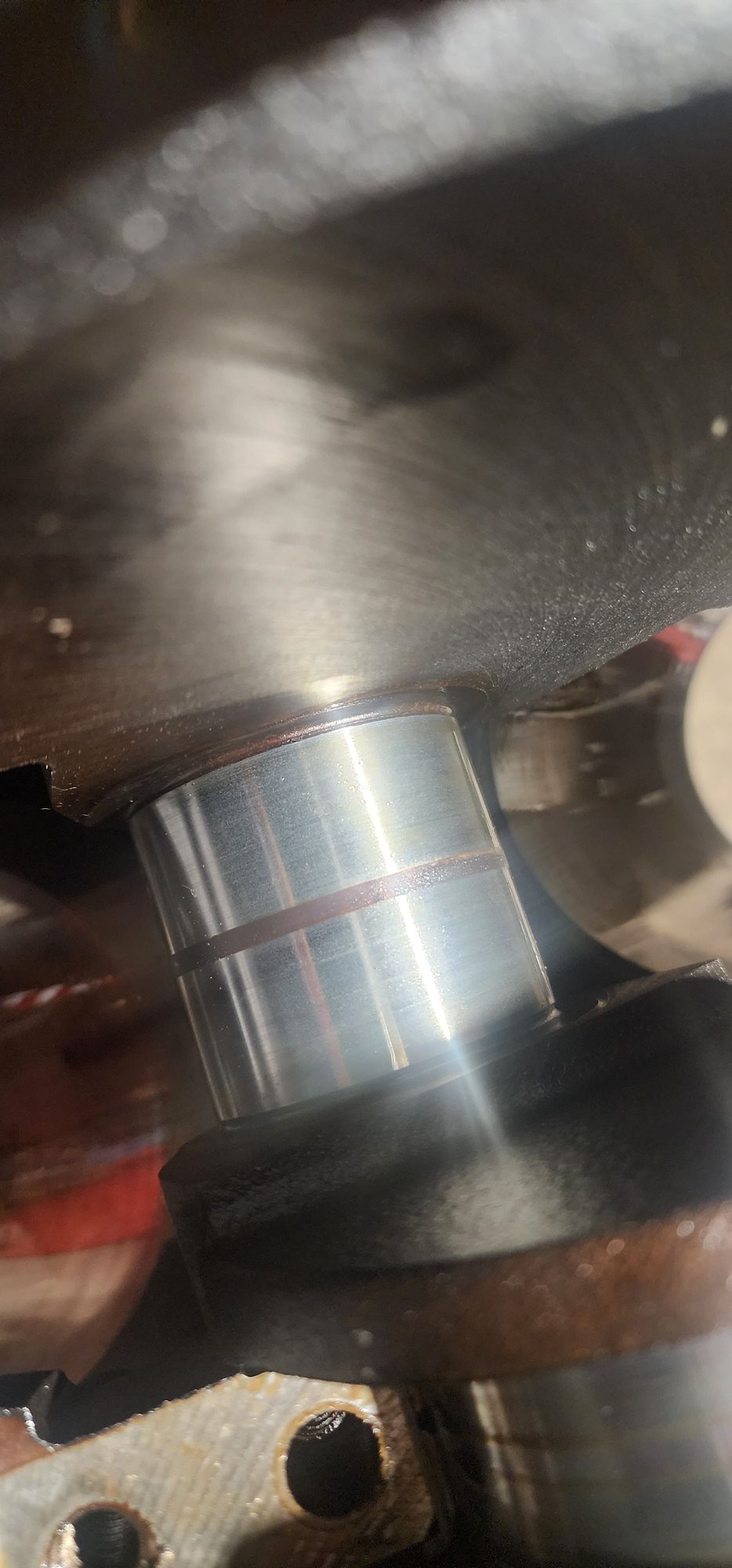

Tore the engine apart on the weekend.
Everything looks super clean for having 350,000kms

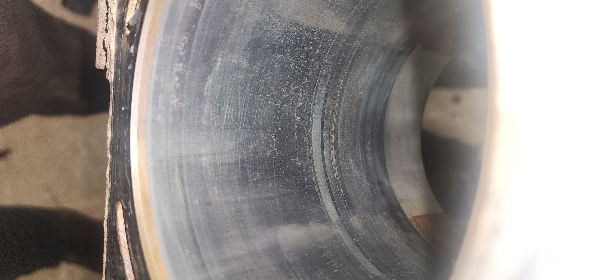

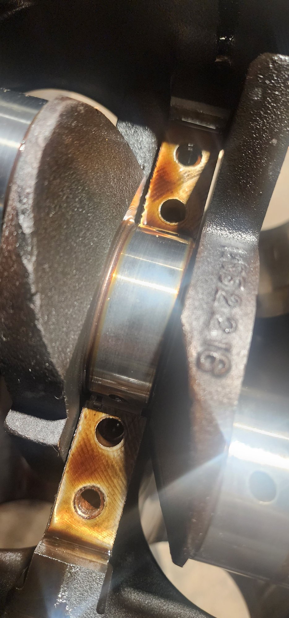

​​​​The cam bearings dried out on the top sides from the engine sitting for 3 years, the pistons rings left marks in the cylinder walls.
Going to rebearing, ring , and hone it.

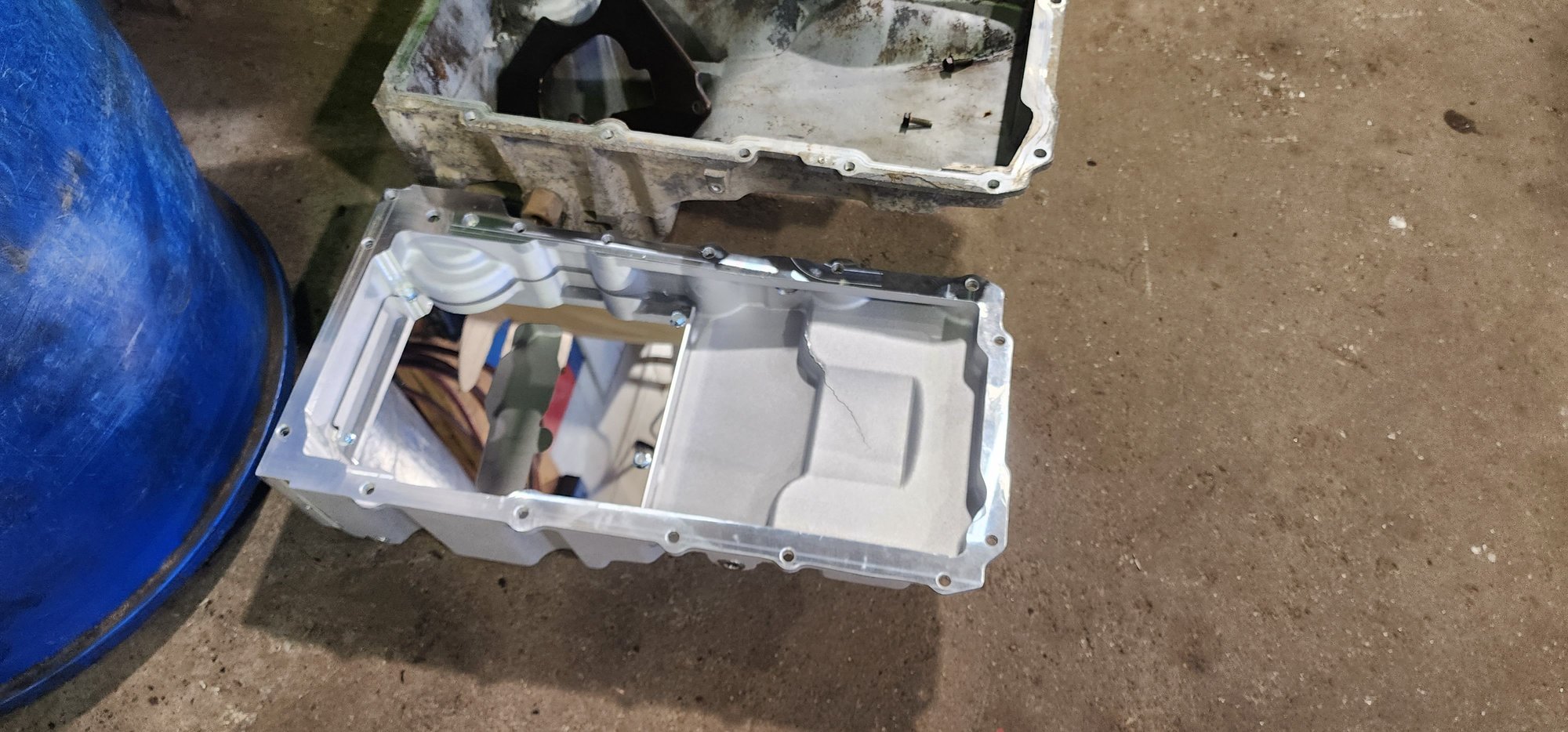

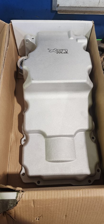

The low profile oil pan came in today. Got it for $303 from black Friday.
Conrod journals
Main bearing
Ring marks in cylinder walls
Cam bearings are shot
Now I need cam bearings, a oil pump, lifters and timing set
​​​​ May as well do everything.
Quitting my job January so I have December to get my engine rebuilt and get it and the transmission into the car before I loose access to my hoist.
Edit: Pistons look good other then some scuffs on the skirts. Most have them anyways.
