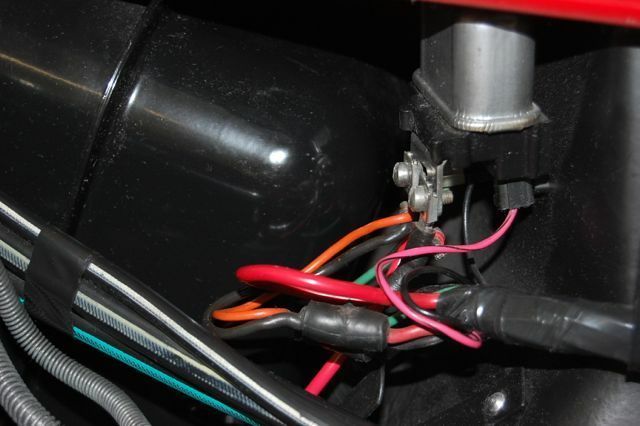

If working correctly, only the lights...if key is left in the ignition, then yes the buzzer would also be activated. The buzzer shares the same ground on the door switch. Sounds like you have a problem in the ignition switch.
If you want to stop the buzzer temporarily, you can unplug the pink/black wire at the horn relay.
