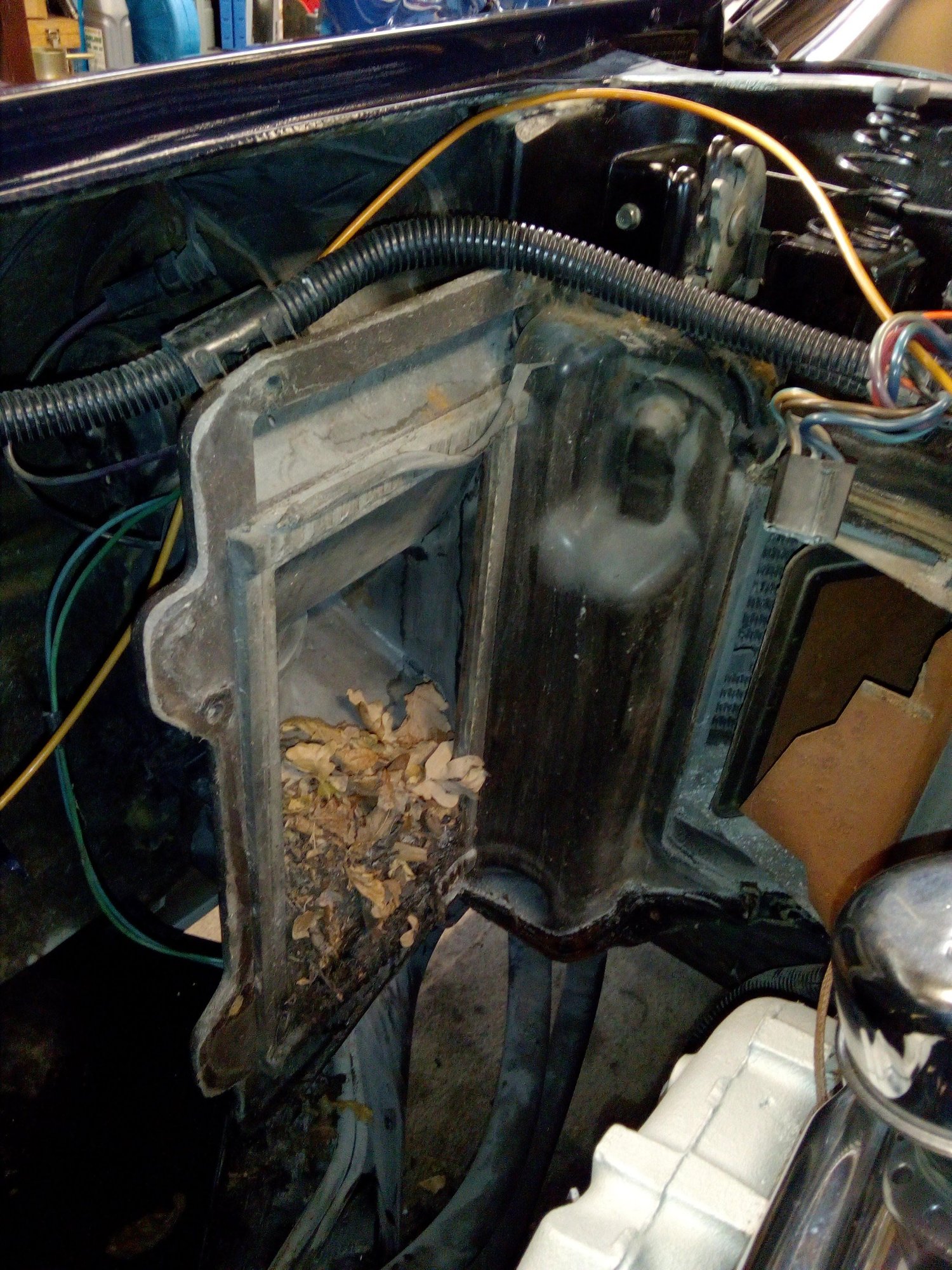

This is what the inside of mine looked like

Bingo!
That's what they ALL look like inside.
Thanks for sharing the pic John.

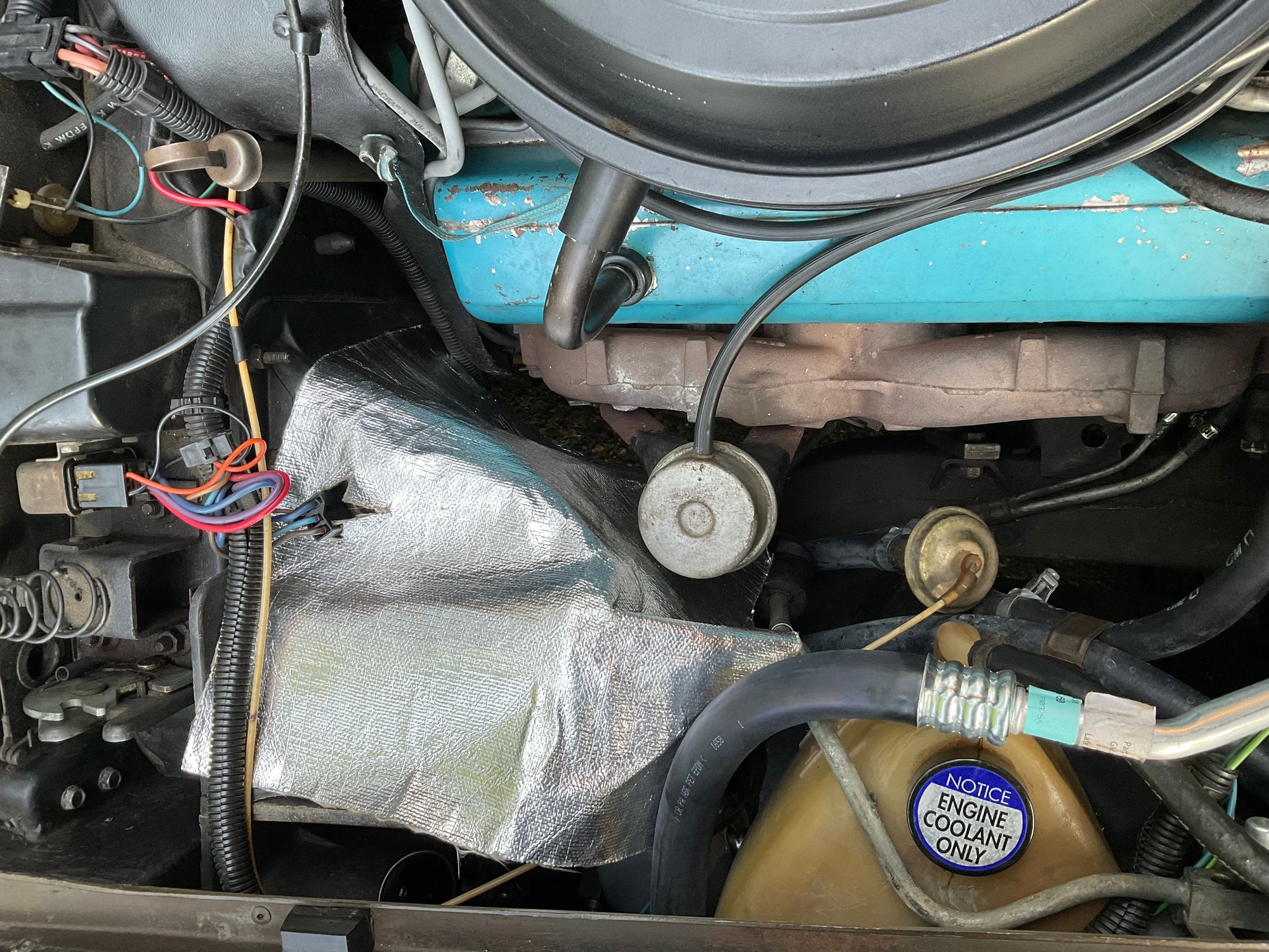

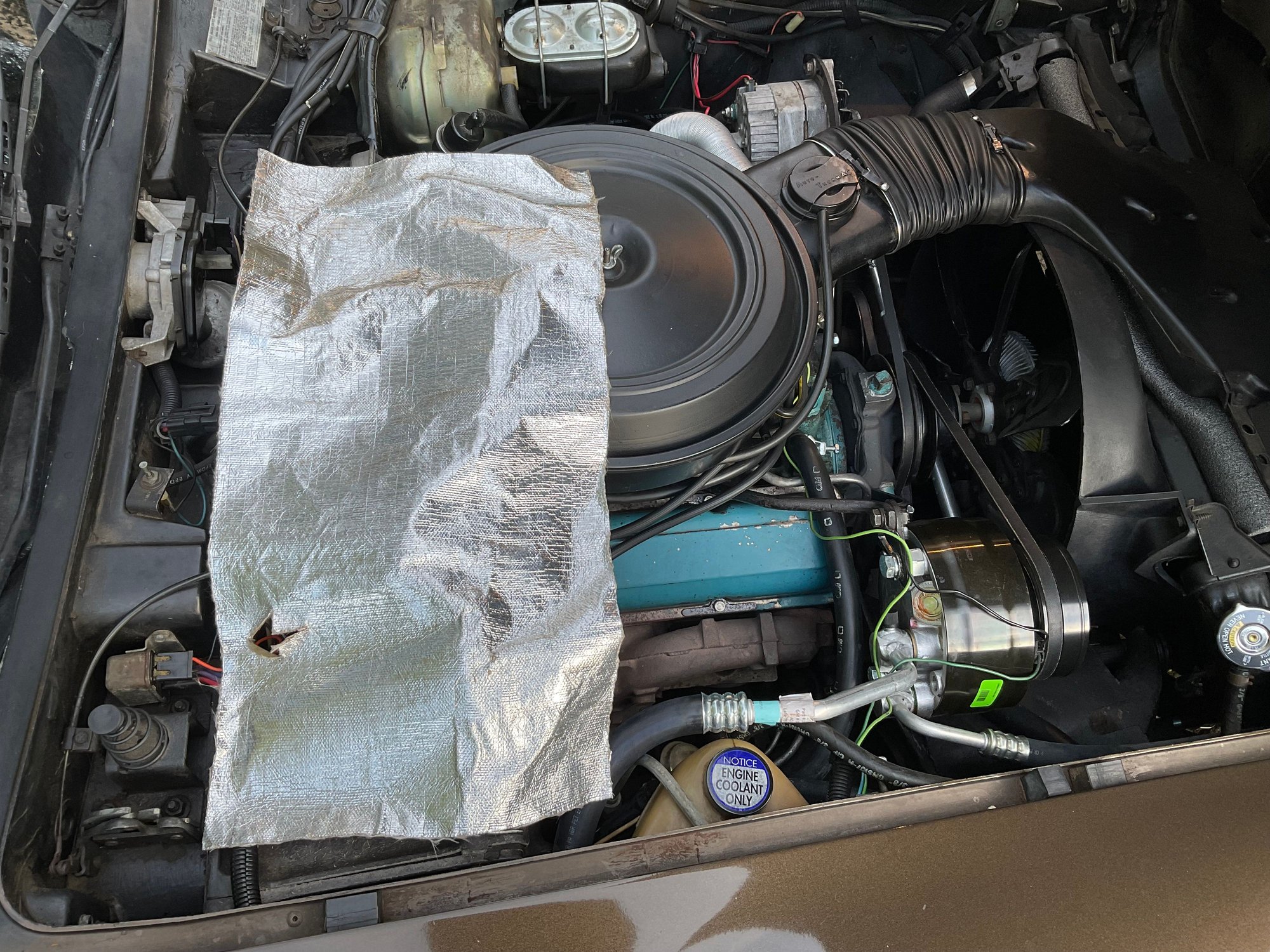

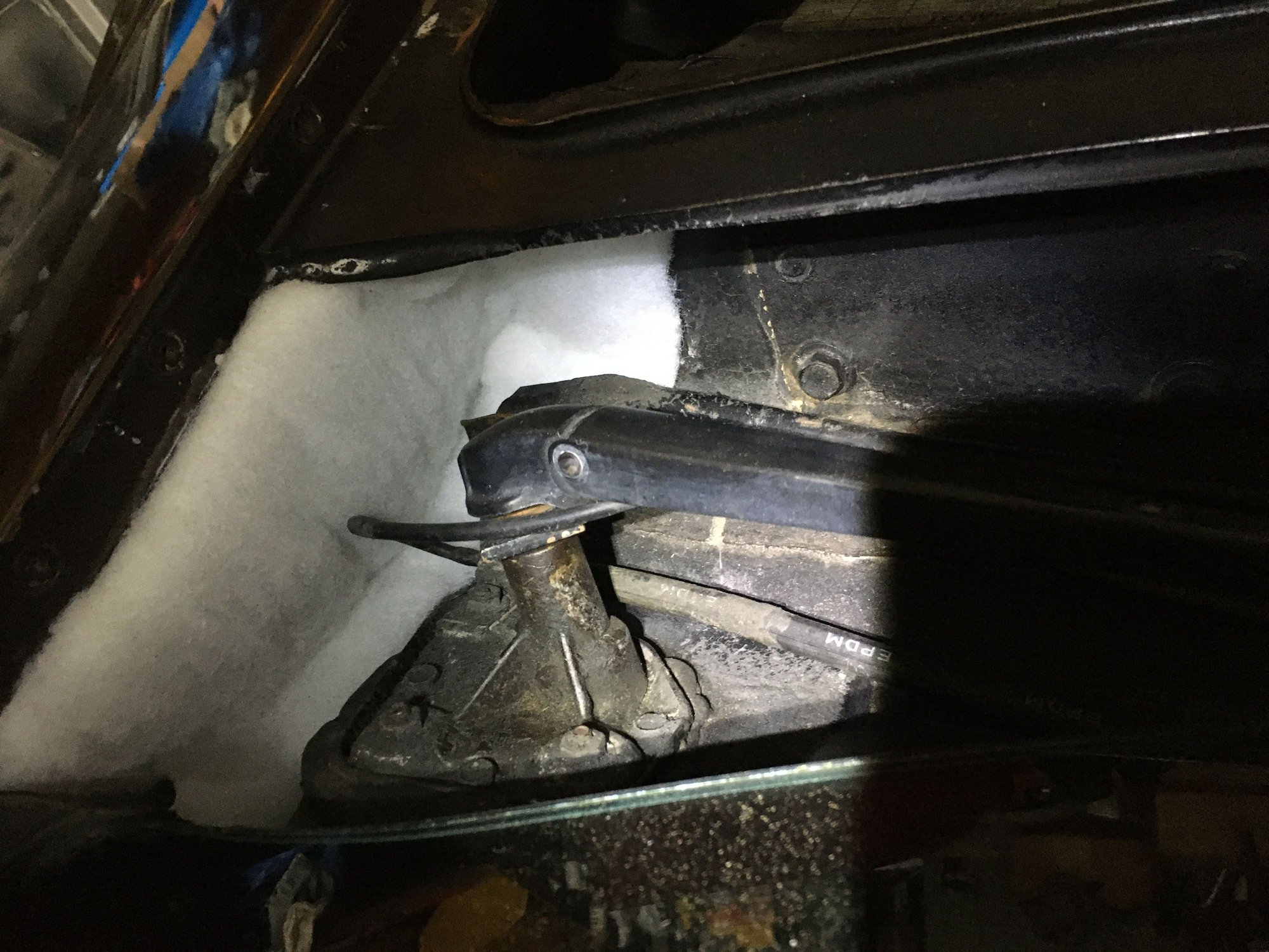

Cleaned mine with it in place, but the inside heater box was out to replace the heater core. Compressed air from the inside with a vacuum tube snaked in from downstream of the fan. The condenser box got insulation inside and outside. With maintaining originality, The outside got a 1’x2’ stick-on sheet of high-temp insulation, but without exposing the sticky stuff. It has stayed put on its own and blocks a lot of heat right where the exhaust nears the box. To keep the evaporator clean in the future wrap the plastic screens at the intake plenums with 1” thick fiber filtration material. A thinner sheet of activated carbon mesh underneath makes it more like a modern cabin air filter.

Nice work Charlie.
And Yes, I should have mentioned the screening for the intake are as well. No point in cleaning all that crud out just to have it fill up again!
I've always used a fine wire mesh in the past, but I really like your idea of the fiber filtration material.

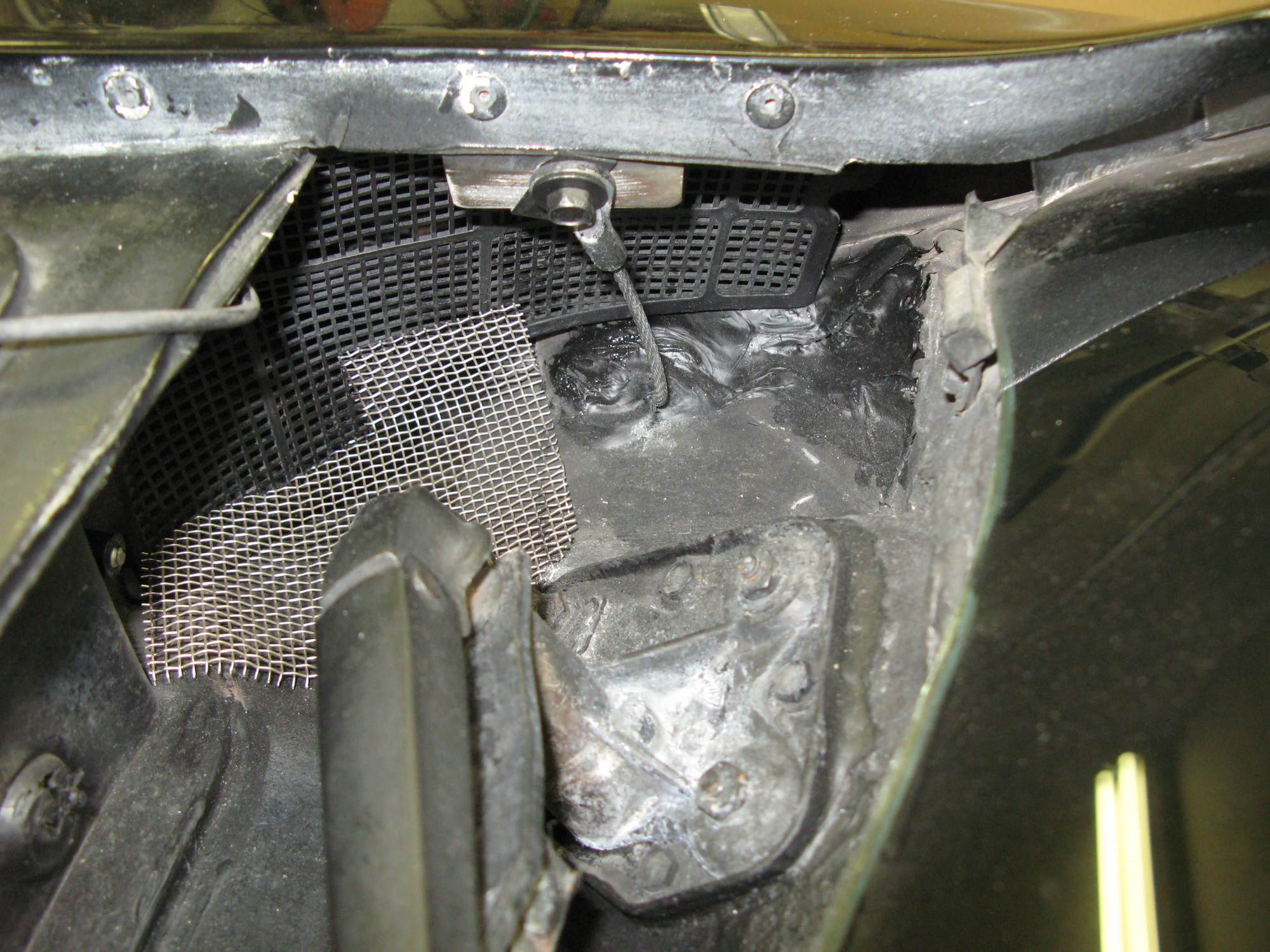

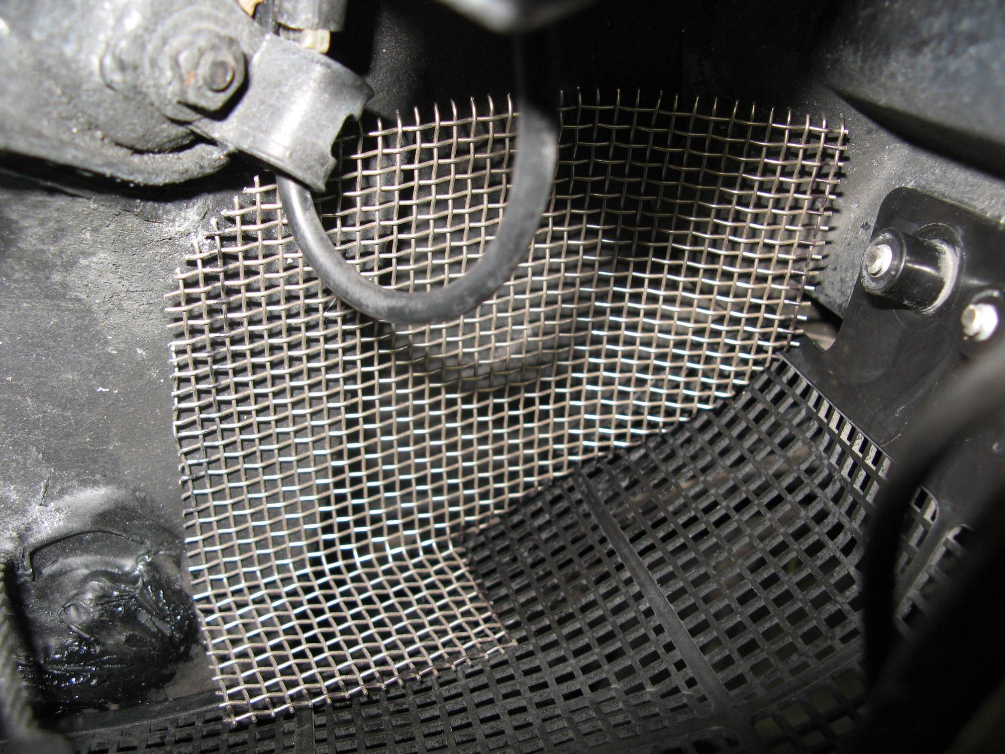

I'm thinking something like this. Have scraps of stainless screen at work. Paint it black and hold it in place with strip-caulk.

Yes Rick, that is very similar to what I've used in the past. As long as you put something there to keep all the crud from refilling that area, you'll be good to go.
