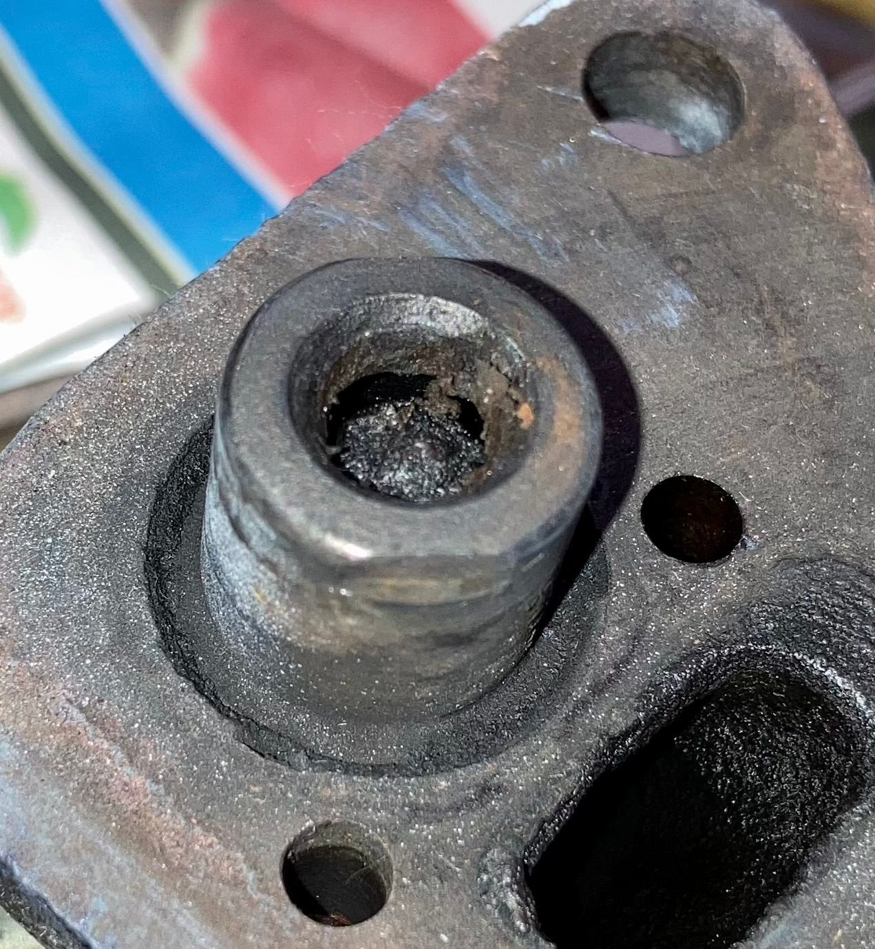

I may have found the problem. I check the vacuum lines as best I could and they appear to be fine.
I removed the EGR and it appears to be stuck open. I spray it with carb cleaner and let it soak, the plunger wouldn’t move.
I install a new on and she fired right up and idles good but I haven’t taken it for a long ride because it won’t stop raining.
I’ll keep you posted.
This the underside of the EGR, it looks like there’s carbon buildup inside there.

The problem has been solved…it was the EGR valve. The rain finally stopped long enough yesterday to take it for a long ride to Rockport, Gloucester and Newburyport and the car ran great. No hesitation at all.
