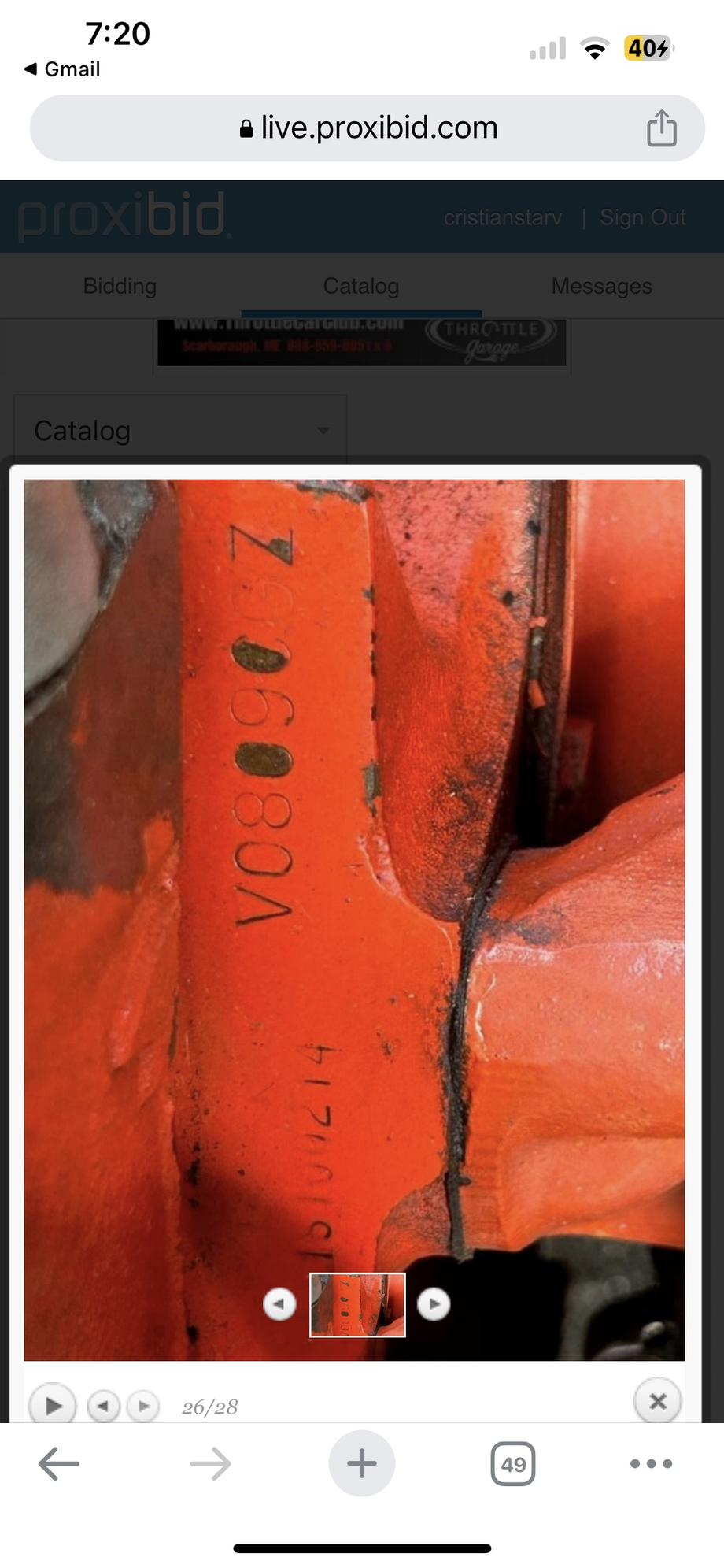

Gents, for numbers and history lovers...
i'm reaching out for for some help..

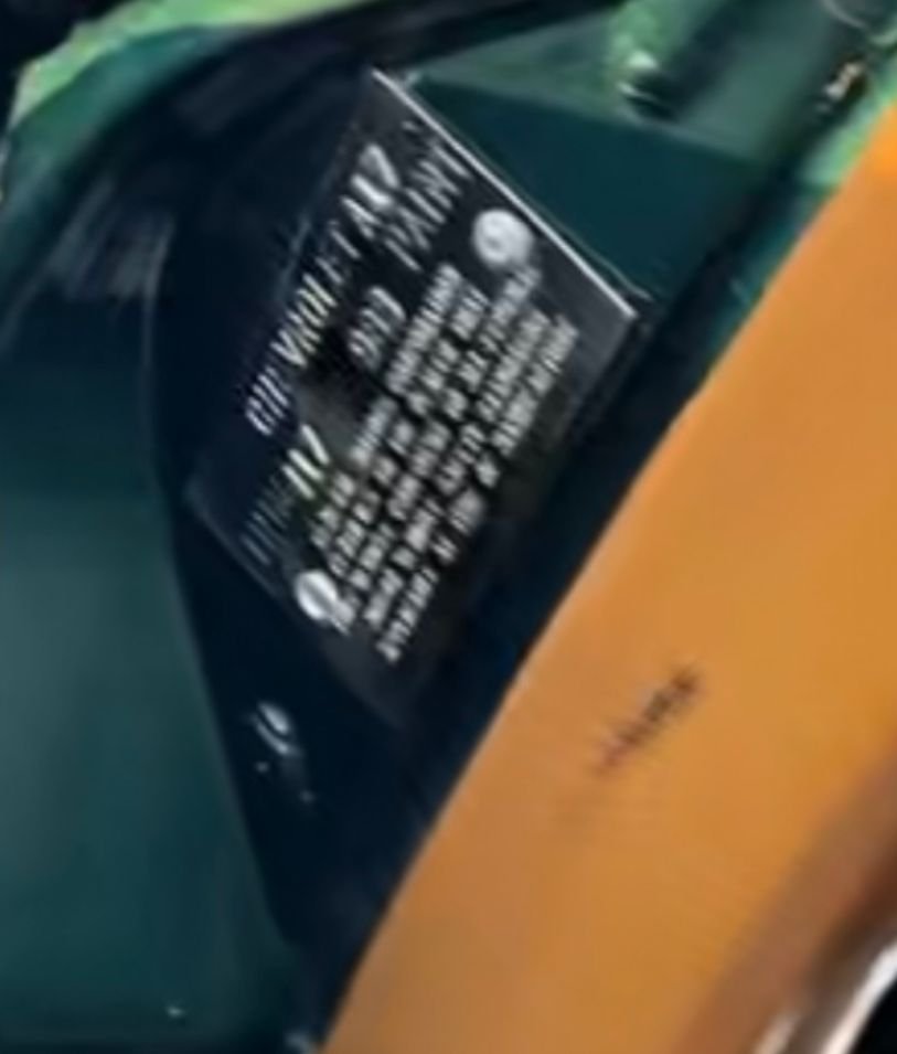

my 71 lt1 trim tag shows A17 (Aug 17 1970) which make sense with the early production 100214 serial number on the vin since the 71 production started in August 1970.

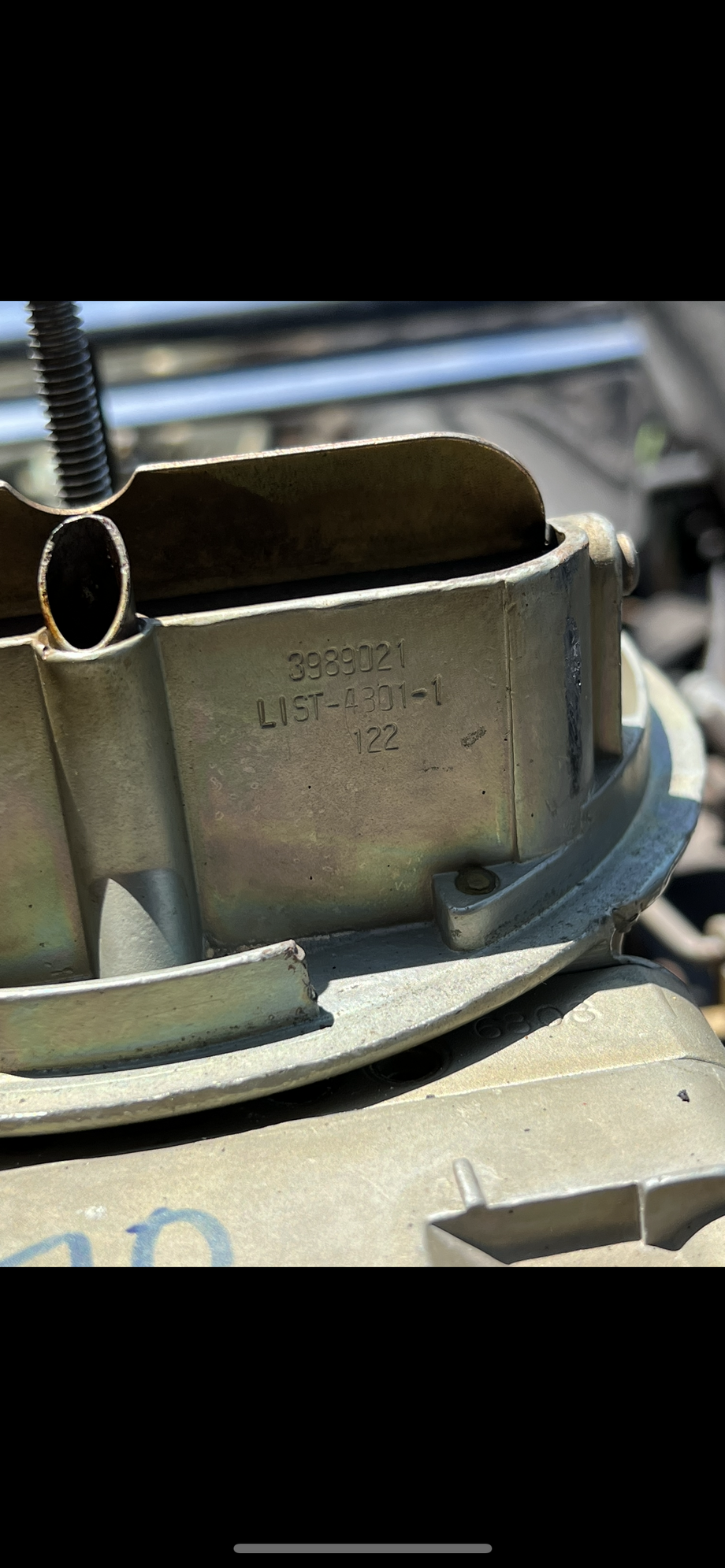

The engine stamp shows 9th of August (V0809CGZ). Make sense. Here is the issue. The carburetor is the correct one (part 3989021, list 4801, 6808, 4519) BUT the 3 digit date is 122 which i believe stands for second week of Feb 1971, 6 month after the assembling. Was it replaced with a correct one that soon after the car was made? sounds odd.
the GM strike was right in between the assembly date and the carburetor date. I wonder if the car was sitting waiting to be completed (without carburetor...) till the end of the strike and that's could be the reason of the 5/6 months gaps between the car and the carburetor dates?

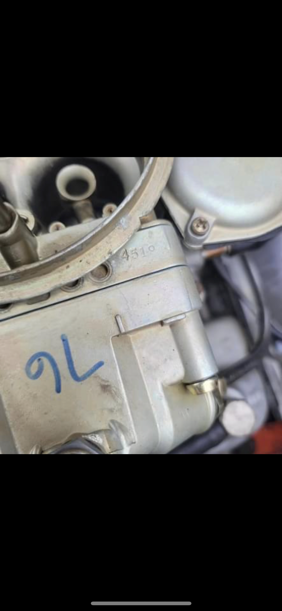

Take a photo of the carburetor’s choke pull off vacuum canister on the passenger side.
That can be a real quick indicator whether the carb has been played with or replaced.

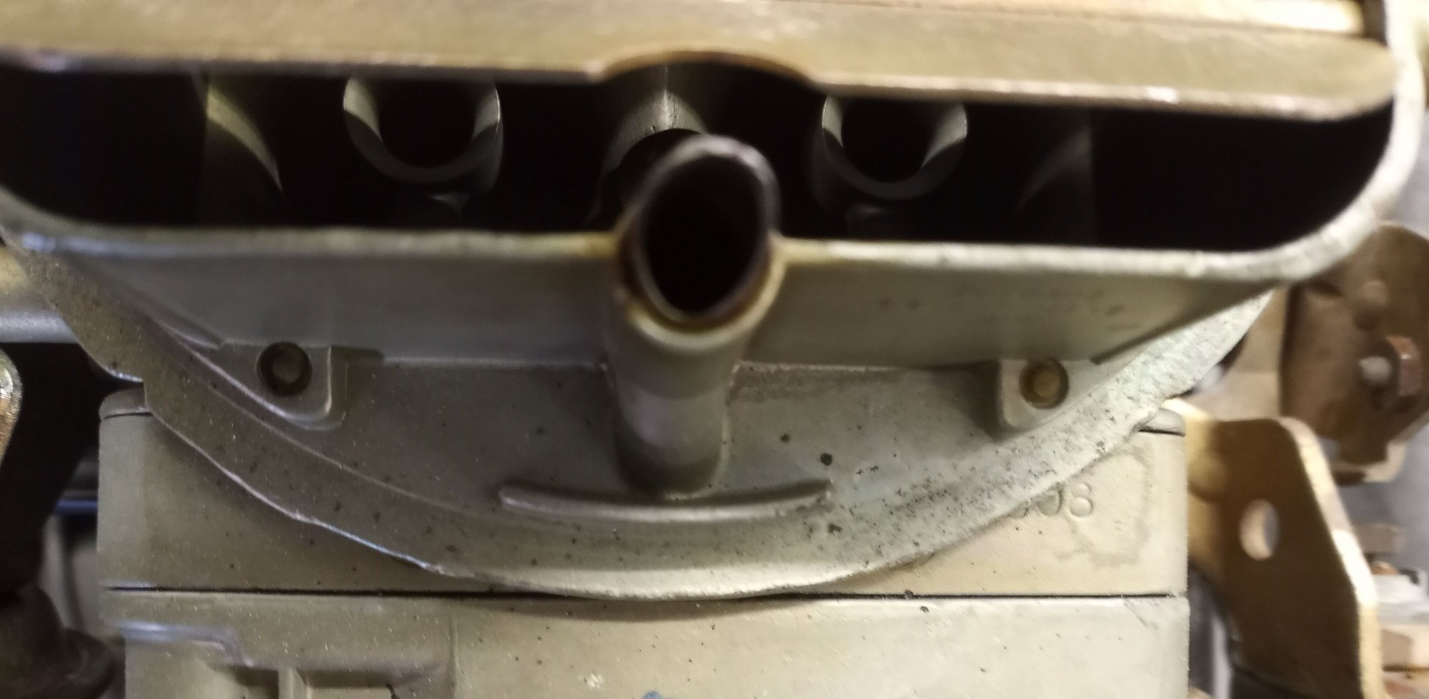

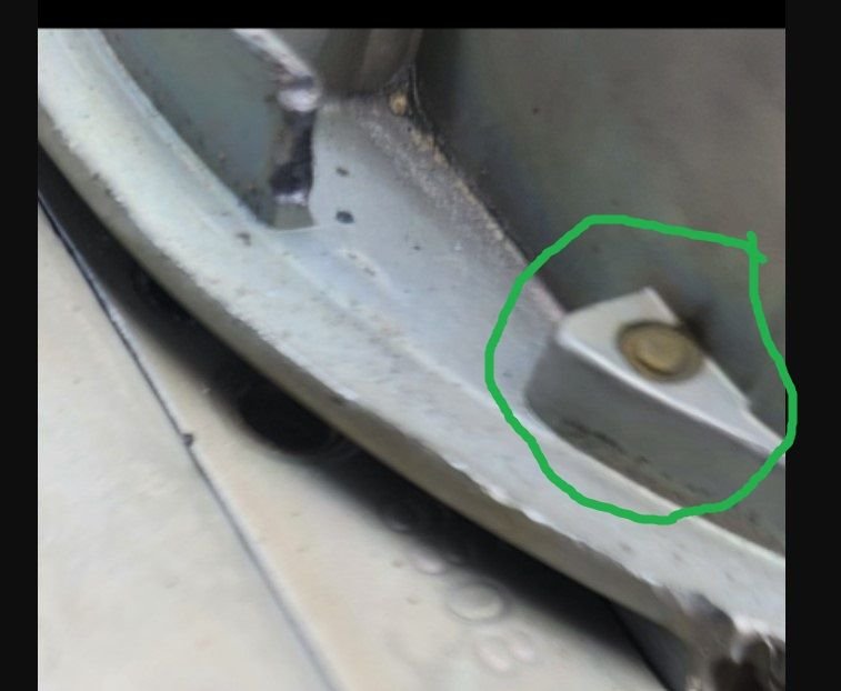

OK here is my take.
I had an original 70 LT-1 for 27 years, with the original carb, I raced it, and that carb gave me fits. I had to send it back to Holley for them to fix.
This is what caught my eye on your carb:
That looks like a brass plug to me.
I would like you to tap on it to determine if it is metal or putty.
A factory production line carb would have putty there.
A CE carb is not drilled there.
Yours may not match either scenario.
I would like to see the air bleed.
Then take a pic straight down into that choke showing both that "plug" and it's adjoining air bleed, like this:
This is a CE carb, not OEM, and has a normal non drilled housing and a normal brass air bleed at that spot.

Early 1971 4801 were just 4801 with no dash? Then some modifications from Holley were made then became 4801-1. Have also seen 4801-1A on over the counter service.

OK here is my take.
that s why i love group like this and really appreciate people like you. I ll have a look thanks a lot!!!
Paul,
Absolutely correct. I wouldn't expect a "-1A" to be anything but a service carburetor. A "-1" might still be an original carburetor, but then again, could be a service carburetor as well.

Originally Posted by cristianstarv
what s a service carburetor?
A carburetor used as a service replacement for an original, production line carburetor. The service carburetor date will be after the assembly date of the engine.
thanks Stan, so that would be still made by GM and the date (feb 1971) is when they made it?
Well, it was made by Holley, but yes, after your car was built . It would be considered a service replacement at that point. WHY it was replaced is the big question.
That’s not to say that this carb could have been used originally on another car… We just don’t know. What we DO know is that it is too late to have been installed on your car originally.

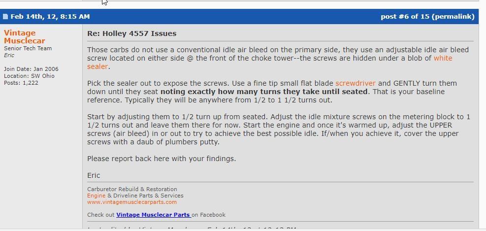

Please take a pic of the idle air bleeds inside the choke horn. My info says only the OEM factory installed carbs have adjustable idle air bleeds and the over the counter ones do not. They were for emissions tuning. There is a tiny screw under that plug, and no brass insert in the idle air bleed, it's just wide open, if it has the screws. My date correct 1970 definately had them. One of them vibrated closed and the carb would barely run. But mine were sealed with putty.
Regards,
Stan Falenski
does this pic helps at all?
Old Jun 14, 2023 | 03:58 PM
cristianstarv's Avatar
cristianstarv
Joined: Jun 2019
Posts: 26
